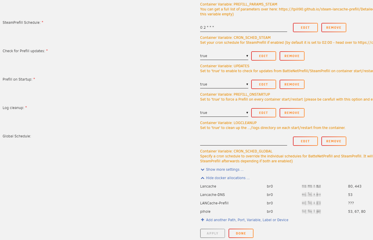

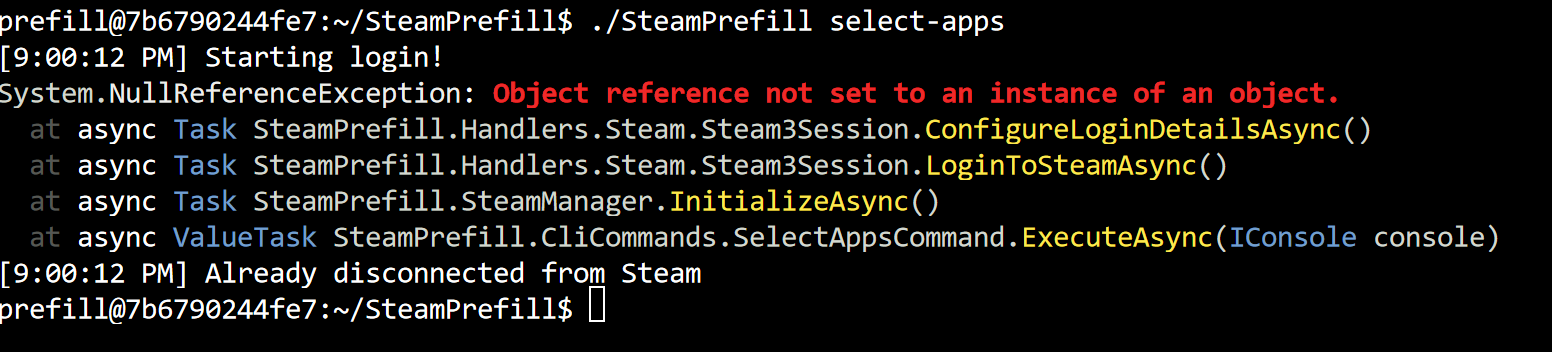

Trying to use the Lancache Prefill docker.
When I login I get a "This session will not stay connected" error and then if I try again I get this:
Edited by SpiceyCadmium
more info
On what Unraid version are you?
Please open up a console from the container and issue this command:
rm -rf ${DATA_DIR}/SteamPrefill
Restart the container and try to log in again.
I've already contacted @tpill90 about that if he has yet seen such an error.
Thanks for the crazy fast reply!
I'm on 6.11.5.
I did that command and restarted, it let me login but on the prefill finish it happened again. :(
Do you have a cache drive installed? Can you post a screenshot from your Docker template? To what is the setting "Use Cache" set in the Share settings from your appdata share?

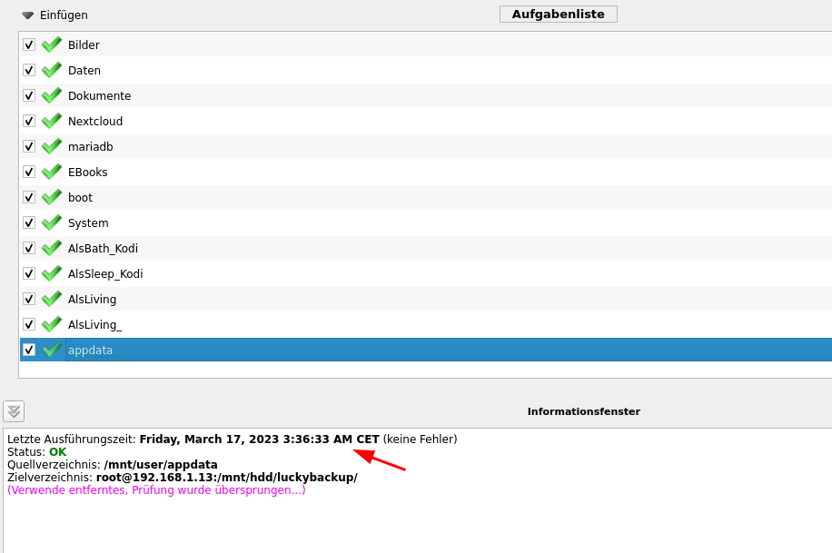

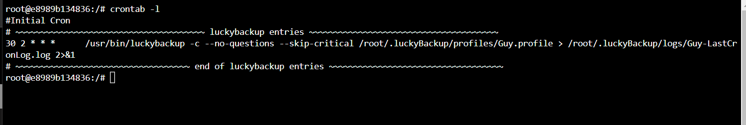

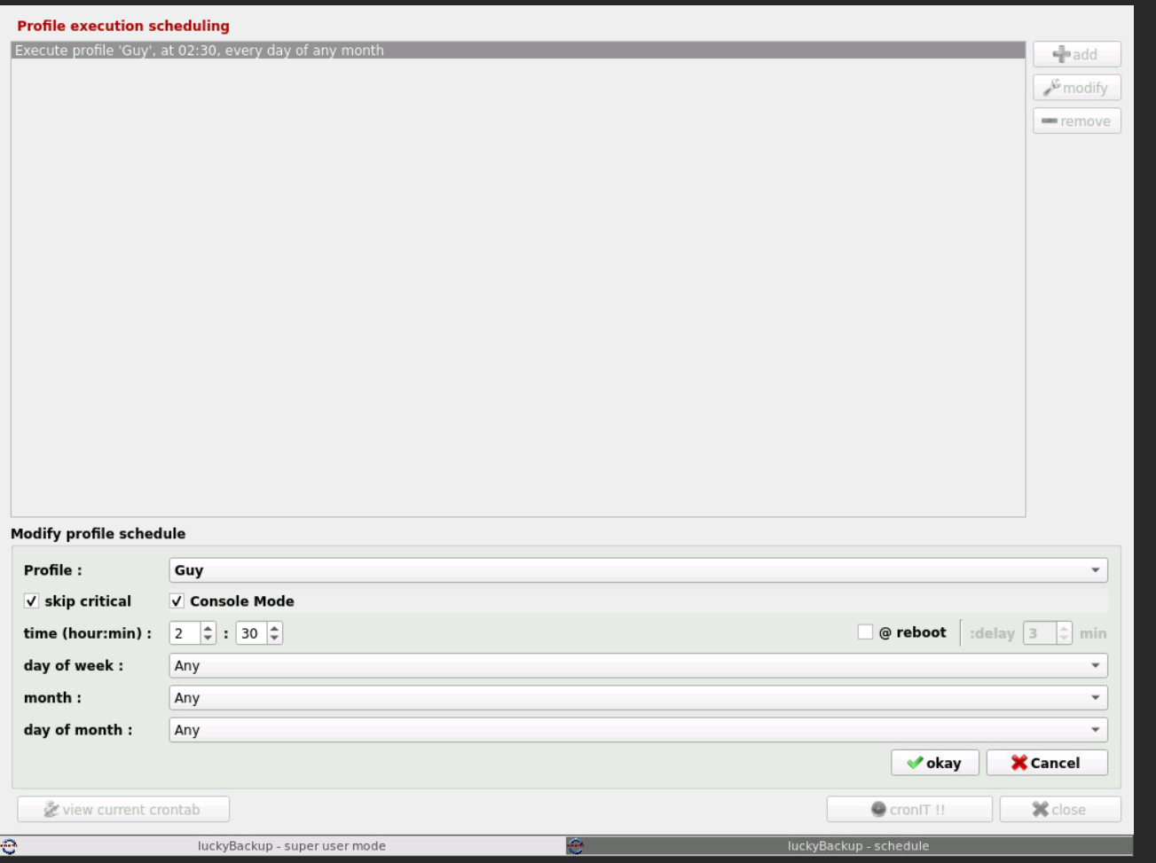

The cron job I try to create with luckbackup to run on a daily basis does not seem to work.
I created a cron job with, as instructed, the console checkbox marked - yet it doesnt seem to be working
Can anyone suggest a solution?
5 hours ago, Husker_N7242C said:
Many thanks for all of your contributions!
I have to try this on my own on a test setup but this can take a few days...
This is the first time I hear that this is not working and since luckyBackup was well used back in the days I can't imagine that it caused issues back then.

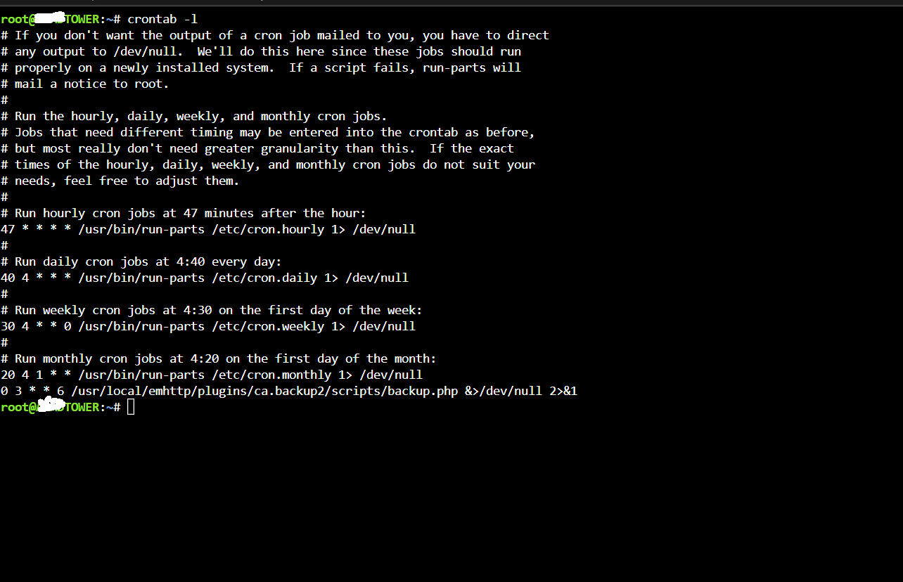

Can you provide a bit more information on that, please share screenshots of your sync and the schedule that you've set up if possible.
Does it sync while running it manually?
Sure - thanks ich777 for your quick response and yes when I run it manually it syncs
Below are three screenshots.
Thanks again for your help
1. from luckybackup
2. from the unraid main console
3. from the luckybackup container console
you can delete the screen from unraid cron, only from luckybackup cron is the one which is interesting ;)
may i ask how you come to the conclusion it doesnt run ? may as note, the GUI wont show an update that the job is done until you restart the docker, just to make sure you dont rely on the GUI Info ...
this Info only shows up until you restart the docker ...

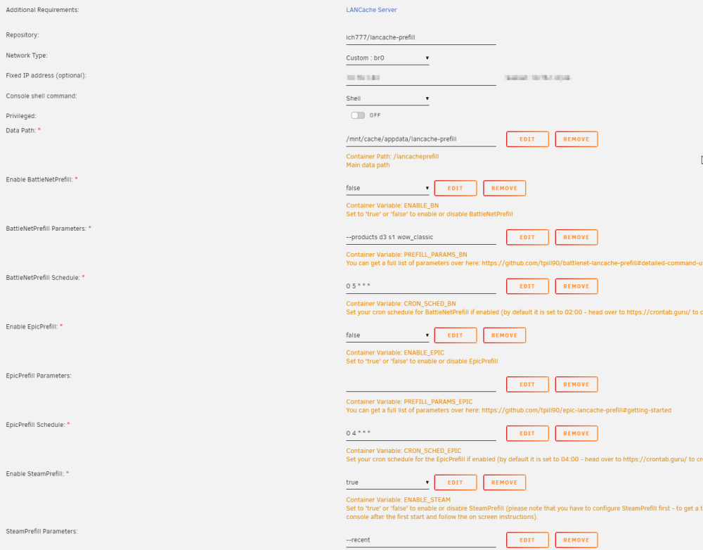

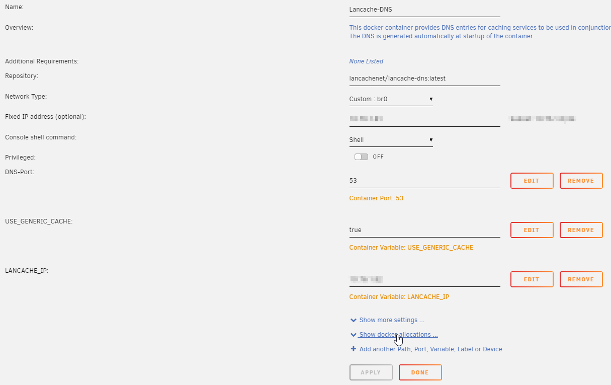

hi @ich777,
i think i have the same problem
i noticed an error message right before the app-selection-screen:
could that have something to do with the error?
could this be a user-rights issue?

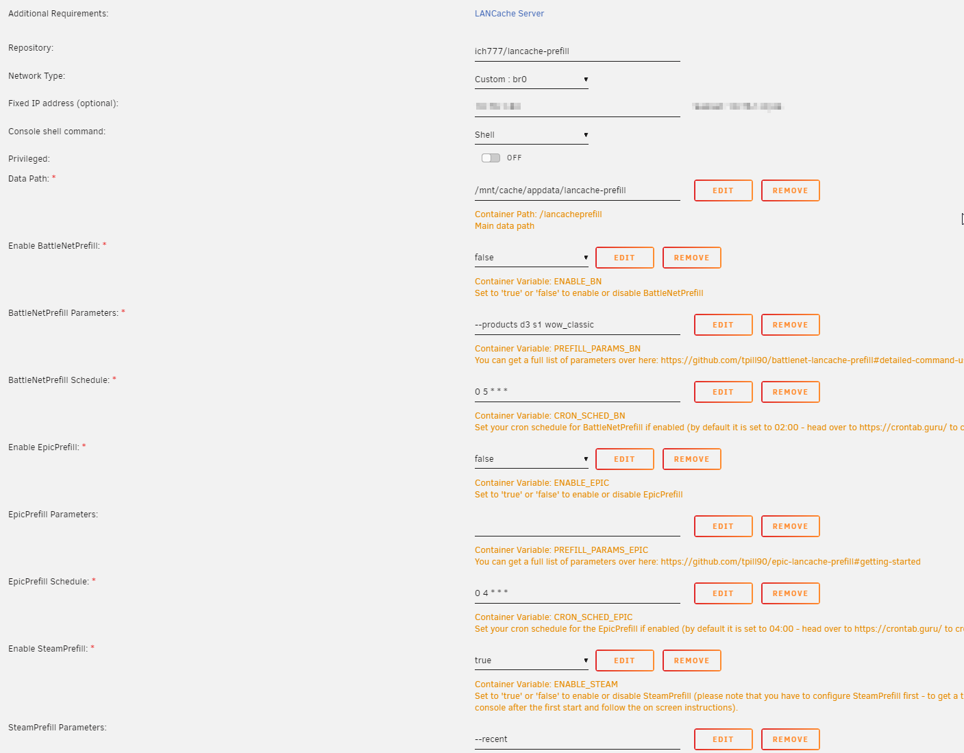

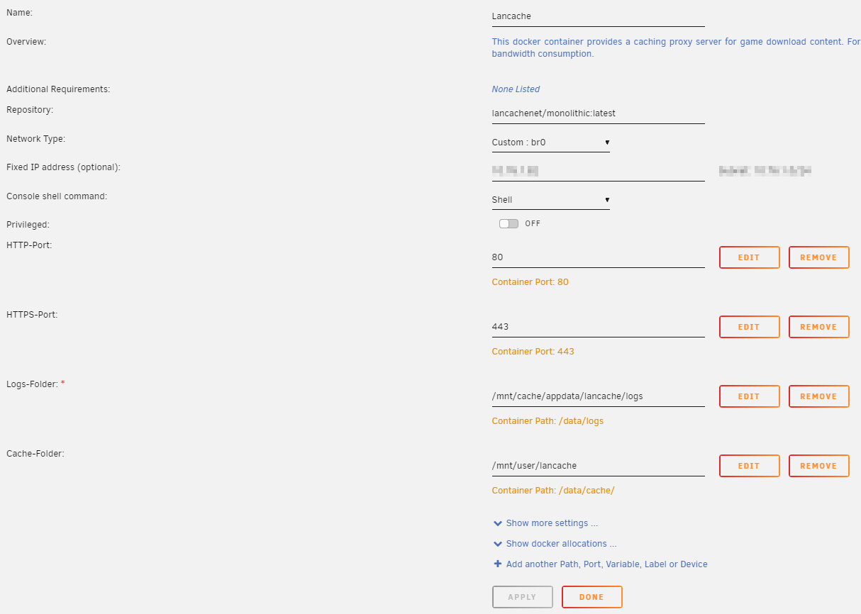

to answer your questions:
i have a cache drive; the appdata share is set to prefer the cache drive; in all docker templates the path points to the cache directly e.g. /mnt/cache/appdata/..
here are screenshots from the prefill-container:
from lancache:
and lancache-dns:
please let me know if you need any more information to analyze the error, i'd love to help
thank you!
regards - d8
I dont understand - the cron job is running every and I will see it only after restart of the docker?

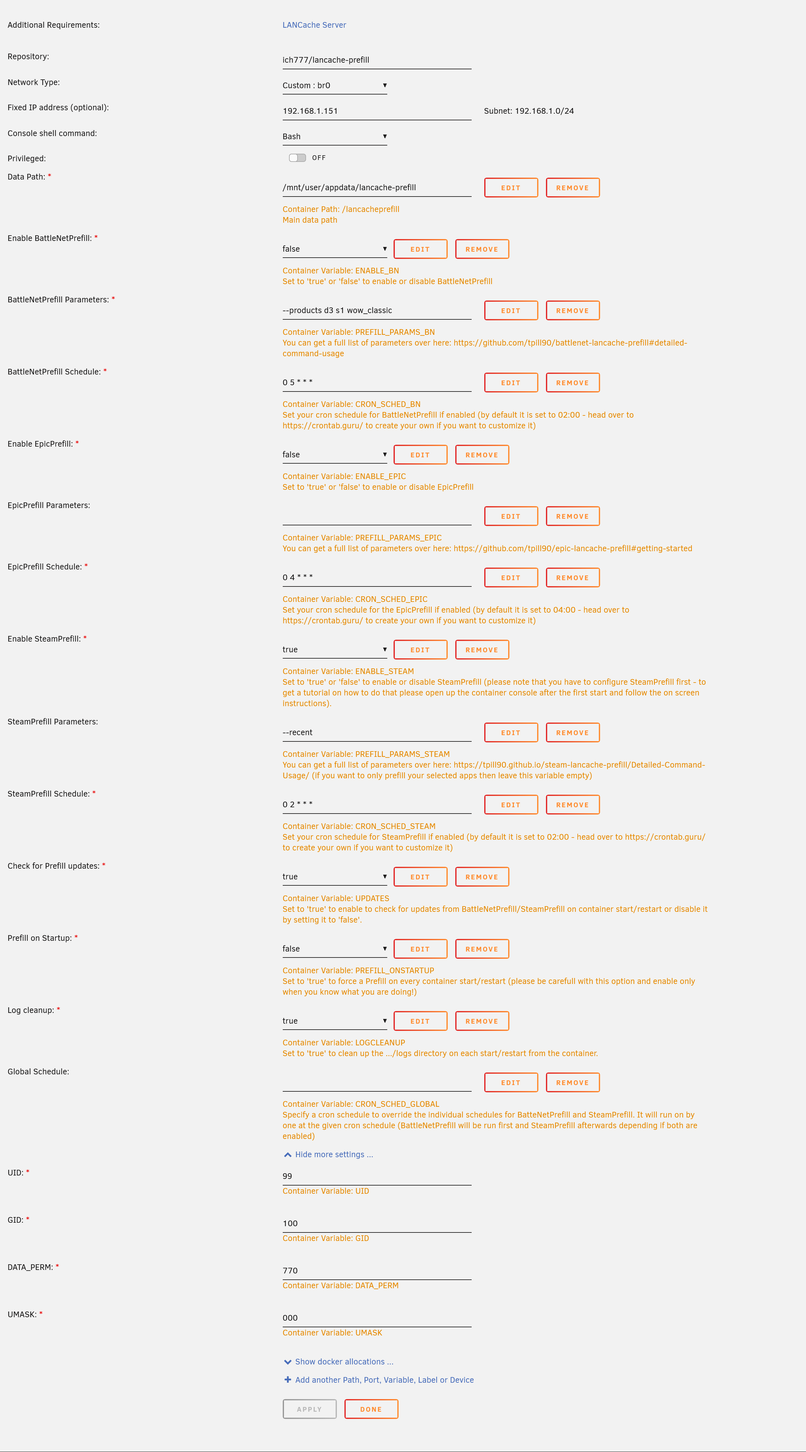

Forgive my delayed reply, appreciate your response!
1. Yep its installed on the cache drive.
2. Please see below:
1892197084_Screenshot2023-03-18at11-12-30JARVIS_UpdateContainer.thumb.png.4081ffd9ec876d834ba5212b221b97da.png
3. /Appdata/ is set to "Only."
exactly, its a lack in the webgui app itself.
may as note, this is normally a desktop app, i guess the author of the app (not the docker) is just checking while opening the app and not watching the cronjob results while the app is open ... which is the case in a docker ;)
may just check your backup targetif it ran properly or not ...
personally i made a workaround for me and posted it also here in this thread.
Seems like Steam broke something and this is a common issue for new installs: Click
Guess we will have to wait until Steam merges the PR to fix this issue.
Hi alturismo - can you share your workaround? - I can't seem to find the post you are reffering to...
Just restart the container on a daily basis with a user script through Unraid so that it doesn‘t interferes with the schedule in the container.
docker container restart CONTAINERNAME
(of corse replace CONTAINERNAME with the container name - case sensitive!)

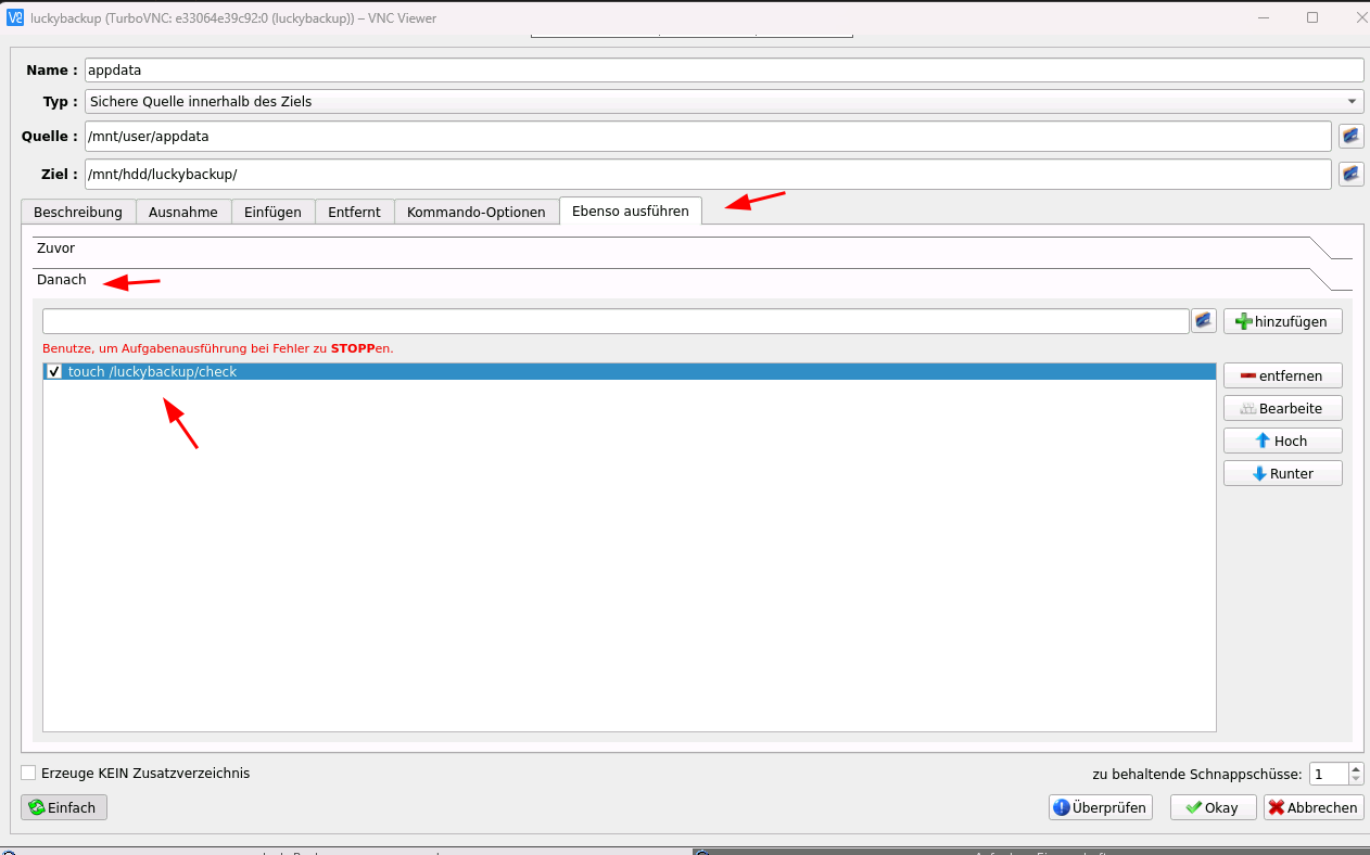

in the end, simple as @ich777 pointed out, as i want it to be failsafe and closer to finishing state i made a 2 step way.
1/ touch a file which changes the mod time after the last job is done
2/ wrote myself a small check script
#!/bin/bash
donefile="/mnt/cache/appdata/luckybackup/check"     ### file created/redone by luckybackup after complete
waittime="10800"                                    ### time in seconds to check age
dockname="luckybackup"                              ### case sensitive name for docker to restart
if [ "$(( $(date +"%s") - $(stat -c "%Y" $donefile) ))" -gt $waittime ]; then
   echo $donefile is too old
else
   docker restart $dockname
   echo $dockname restarted
fi
3/ schedule it to fit my personal setup
so, my backup starts at 3.45 am, needs ... some time, depending now ... so i check 1st time at 4.55 am if the job is done and restart the docker, if its not done then, it will check at 7.55 am ... and finally at 10.55 am ... (thats why the 10800 seconds timer, 3 hours lookup) then definately all jobs are done and the docker will restart and GUI is updated.
#!/bin/bash
else
fi
Thank you very much alturismo 👍🙂

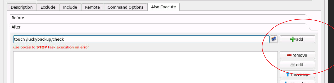

alturismo - just two questions about this workaround (I am new here so I want to make sure I understand)"
1. What does it mean to touch a file and do I just write this line and add it with the button:
2.
#!/bin/bash
else
fi
The script in 2 is the code I should copy a the new scheduler script in 3
Thanks
exactly, it ll either create the file or modify it (timestamp)
yes, as user script and schedule it for your needs ...
Thank you for your help and patience 👍

In luckybackup - which type of sync do you recommend for this type data i.e.:
1. For backing up appdata - would you choose BACKUP SOURCE INSIDE DESTINATION or SYNCHRONIZE SOURCE INSIDE DESTINATION? and what would be the way to restore it?
2. For personal media such as family photos and videos - which sync option would you choose?
Also will luckybackup will know to backup only to a this specific disk and refresh the differences after I take it out and put it in back in?
Thank you
30 minutes ago, guyola said:
Thank you
you welcome, about all your other questions (and more may will follow) i would suggest now to switch the channel and read into luckyback (rsync) and about its capabilities, this here is not the luckybackup support channel ;)
here we are right if there are questions about the docker and its docker functions
rest you may should start here https://luckybackup.sourceforge.net/
as note, im also not using "cold" backups, only LAN and cloud so i also cant help there at all.
