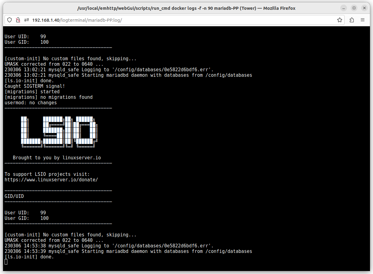

here are the logs, when containers started:
Mariadb:

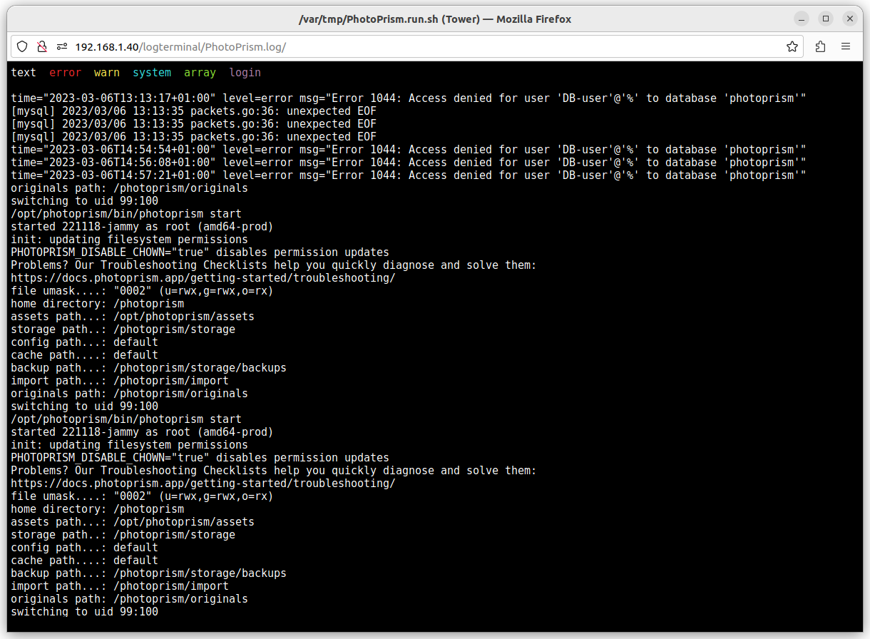

PhotoPrism
I have seen indeed some fault when scrolling fully up the photoprism terminal.
That access denied - I rechecked - no wrong passwords, etc.  In the DSN Variable I put the database user password, not DB-root password - correct ?
Something like this, assuming your user is photoprismuser, your password is photoprismpassword and the database is photoprismdb:
photoprismuser:photoprismpassword@tcp(192.168.1.40:3307)/photoprismdb?parseTime=true

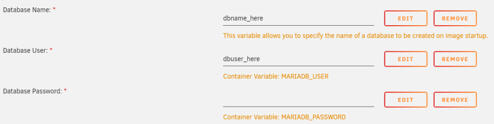

"...May I ask why do you set up a second MariaDB container if you already have one? Simply create a user, database,... in the existing container. You always can delete the user there...  "
Actually I didn't know, if it works in a docker having several databases with different users and passwords in the same mariadb container. And how to set it up ?????
I guess:

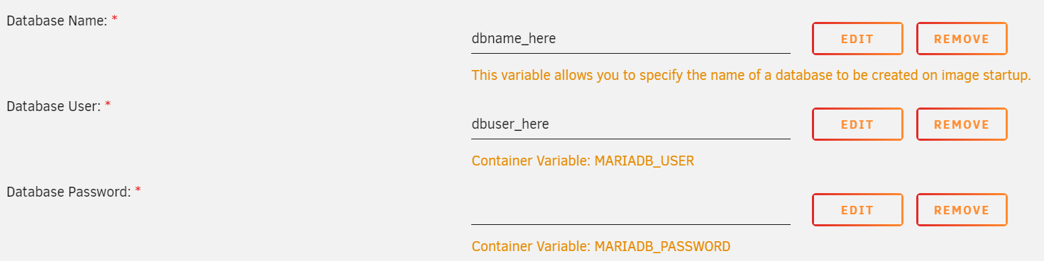

So, in the mariadb-official container template there is the variable MARIADB_DATABASE, which is the database name. At the moment there is only one database named nextcloud. Simply generate another database and change the MARIADB_DATABASE variable to:
'nextcloud, photoprism'      (without  quotes, comma seperated ?)
Similar with variable MARIADB_USER
But how to add another password ? Or will the second user share the same password...
Or is it even more simple:
just use the same user for Nextcloud AND photoprism and only add another database comma seperated as above mentioned ?
Why not? I use my MariaDB Docker container for five different containers which all connect to it where each of these five containers have their own user and database inside the MariaDB Docker container.
It is just a container with a MariaDB inside of it and you should be able to do whatever you want to do with it (create, delete and edit databases/users).
I have linked a tutorial in my post from above with steps how to create a user, password, database and grant permissions to a specific database for a specific user.
Sorry I don't use this container and it would be best to post in the support thread from this container on how to create users databases and if that works with the variables, I have to do it via the terminal in my container.
These are also questions for the support thread from your specific MariaDB container since I don't know how this container is working.

"Something like this, assuming your user is photoprismuser, your password is photoprismpassword and the database is photoprismdb:
     photoprismuser:photoprismpassword@tcp(192.168.1.40:3307)/photoprismdb?parseTime=true        "
Thank you for the example!
I learned, that after the IP:portnumber/   XXXX
XXXX is the database name - I thought it was the container name
In my case container name and database name is completely different... so the variable was wrongly set
Now it works.
I do not recommend this for the official MariaDB container, because the user
- needs to know how to connect to a database
- needs to know which SQL statements are needed
- needs to know how to execute these statements
- needs to create backups with sqldump and not only the appdata backup plugin (how to restore the yesterday's backup of Nextcloud?)
- is not able to create multiple databases with the template as it allows only to create a single database:
- is not able to update single applications without influencing other applications (we already had an incompatibility between Nextcloud and specific MariaDB version in the past).
- is not able to find out which application's database causes how many CPU, Storage and RAM usage.
And the Totschlagargument: Having multiple databases in a single container is against the principles of a microservice architecture 🫡

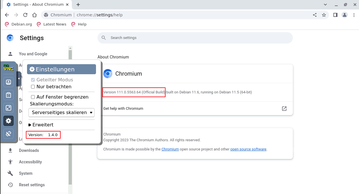

I think something broke with your latest chrome update?
Have you yet tried to clear the browser cache?
I‘ve updated the noVNC version and sometimes it displays an error like this after updating.
I will try that later on my machine.
EDIT: No issue over here:
That did it, I had cleared cookies and what not thinking it was that but forget to do the cache.

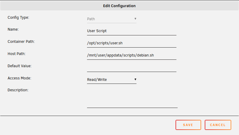

For the debian-bullseye container I was wondering if you could elaborate on establishing persistence for tool downloads. In the container documentation it states "If you want to install some other application you can do that by creating a user.sh and mounting it to the container to /opt/scripts/user.sh (a standard bash script should do the trick)."
I've created a user.sh script, but I don't know what you mean by "mounting it to the container to /opt/scripts/user.sh" - could you explain what you mean and how to do it?
You have to create a user.sh (or you can name it however you want) on the host and mount it then in the Docker template to the path: /opt/scripts/user.sh <- this script will then be executed every time the container is starting.

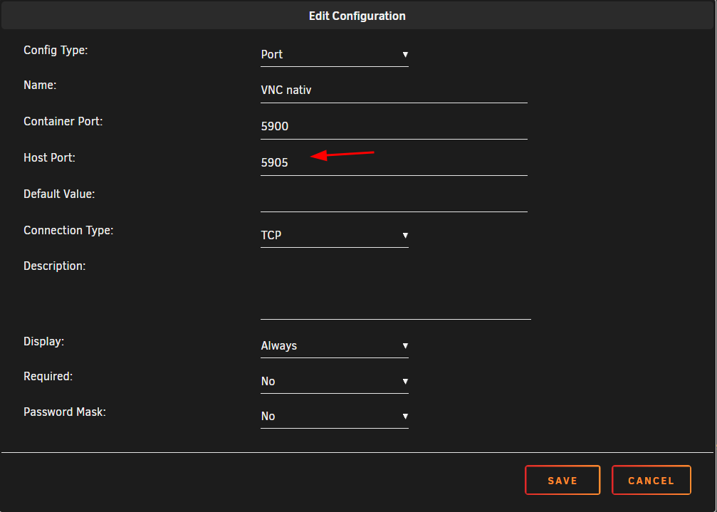

Is there an option to connect to the container through a non-web VNC?
I'm trying to connect to Firefox container through Remmina using port from "noVNC WebGUI".
remmina doesnt support the webgui http ;)
as its more or less just a VNC Server running, just connect to 5900 with the VNC protocol and "bypass" the webui ...
you may have to add another port mapping (depending on your docker network setup) and then use the mapped port
something like this (docker in bridge mode), would mean connecting via VNC on port 192.168.1.2:5905 now
7 hours ago, Ghostie said:
tried doing that but I can't specify a file only a directory
You have to manually type in the file name in the Docker template.
  1. Create a file on Unraid wherever you want, in this case at "/mnt/user/appdata/scripts/debian.sh", with the necessary contents, something like that:
    apt-get update && \
    ap-get -y install 1STPACKAGE 2NDPACKAGE ...
  2. Go to the Docker template and click on: "Add another Path, Port, Variable, Label or Device"
  3. Create a Path mapping like that (of course change the Host Path to where your script is located):
  4. Click Save and Apply
This script will now run each time you start the container
Exactly, just create another TCP port mapping in the Docker template with the container port 5900 and at host port you can choose any free port that you want.
  1. Go to the Docker template and click on: "Add another Path, Port, Variable, Label or Device"
  2. Create a new port entry like that (change the Host port to your liking):
  3. Click Save and Apply
Afterwards you can connect to the VNC server with the above specified host port.
