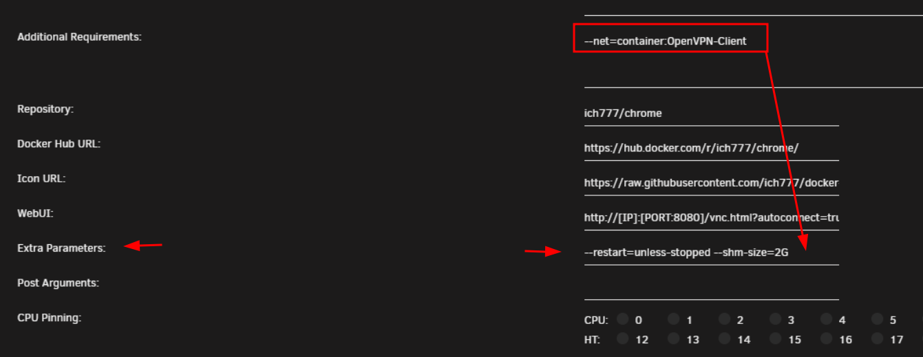

I'm still trying to make this work without any success. I decided to try to make it work with Chromium just to try to get it working and then I would go from there.
Here is my configuration for Chromium
I've been trying for days to get this resolved and I can't understand what I'm doing wrong.
may also expand to advanced, as sample extra parameters are not shown

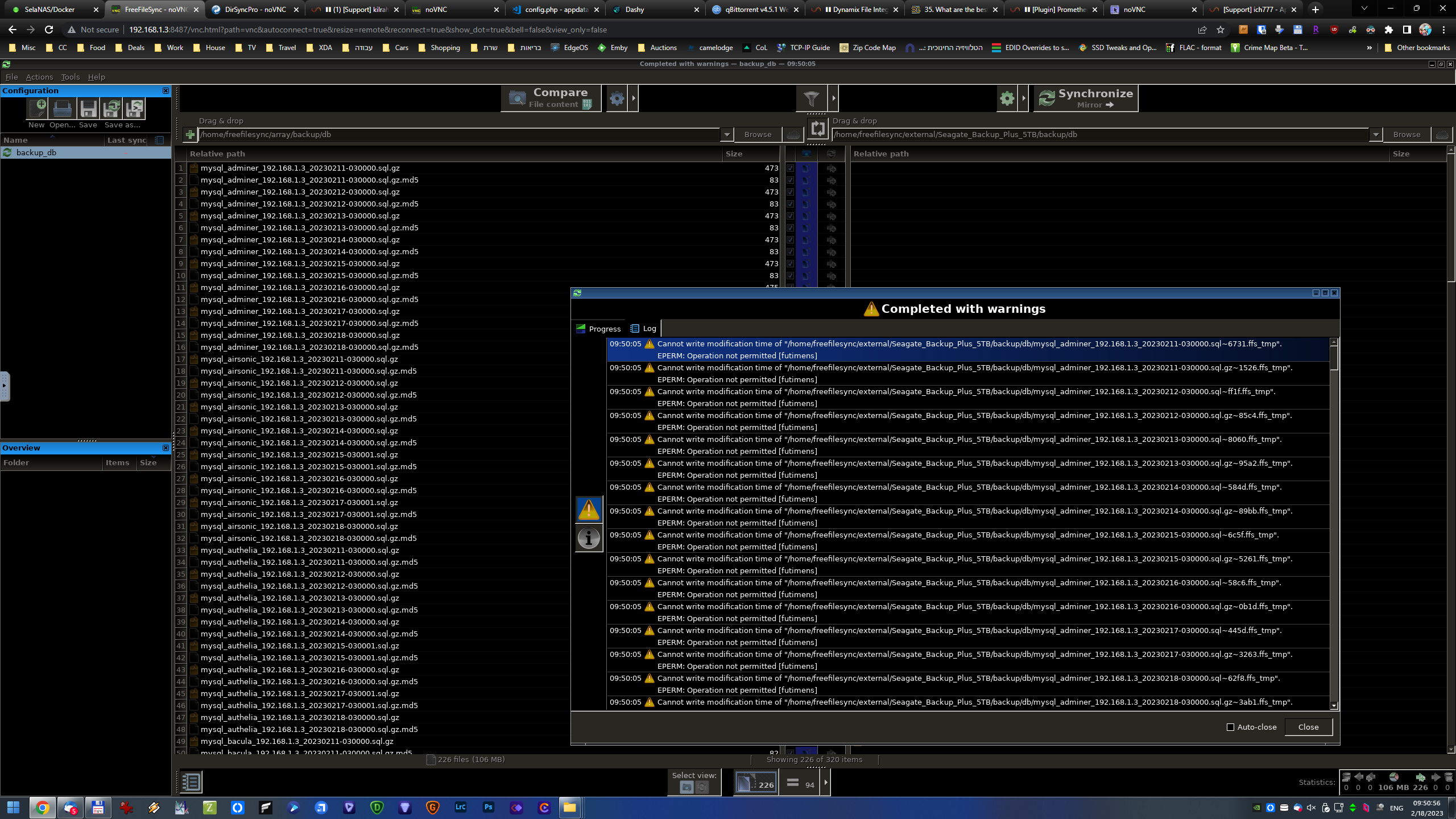

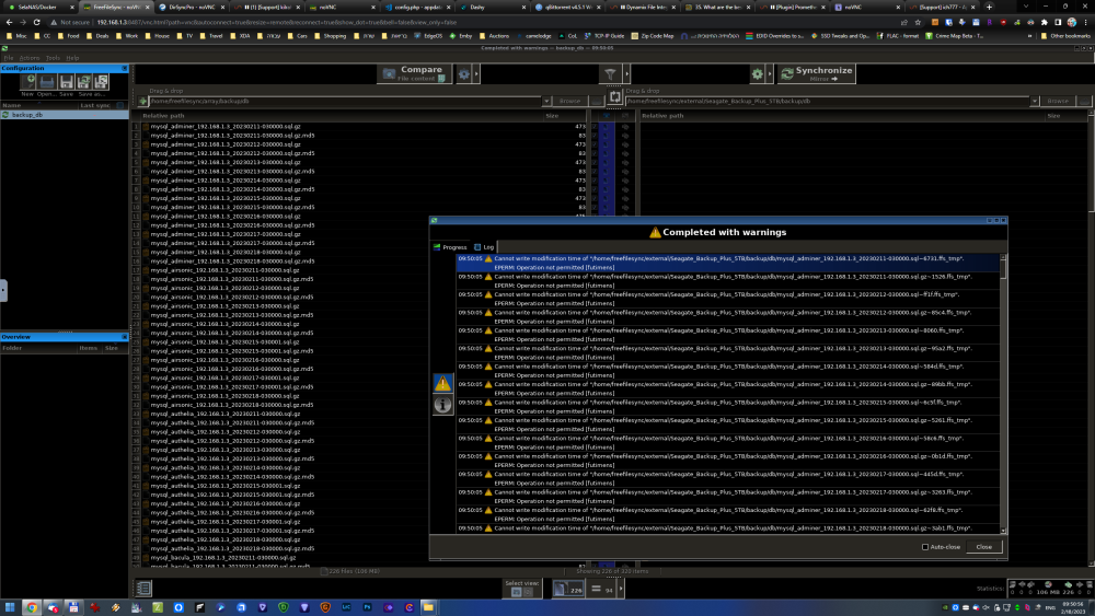

I am also getting a similar error with the FreeFileSync-VNC container:
Happens with whether privileged or not.
The files do get copied and I compared several using a Win11 VM, they are identical.
But when I do compare-by-content in the DirSyncPro container it shows they are not identical, so something is amiss.
Yes, because NTFS can‘t save all the properties from Linux file systems and that‘s why they are different.
so, you cant connect to http://192.168.2.242:8080 ? your chrome noVNC session ... and its working when not using the --net:container part ... ?
yes, that is correct. I can't connect to http://192.168.2.242:8080/vnc.html?autoconnect=true
here is the advanced configuration
And there is your problem, the container has no network anymore and you have to specify which network the container should use and that is simply missing in your configuration.
Please read the description from the OpenVPN container again, you have to have a parameter in the first Extra Paramerts entry (only visible with the advanced view enabled).
I would also recommend that you delete the port entry from the Chromium container to avoid further issues.
