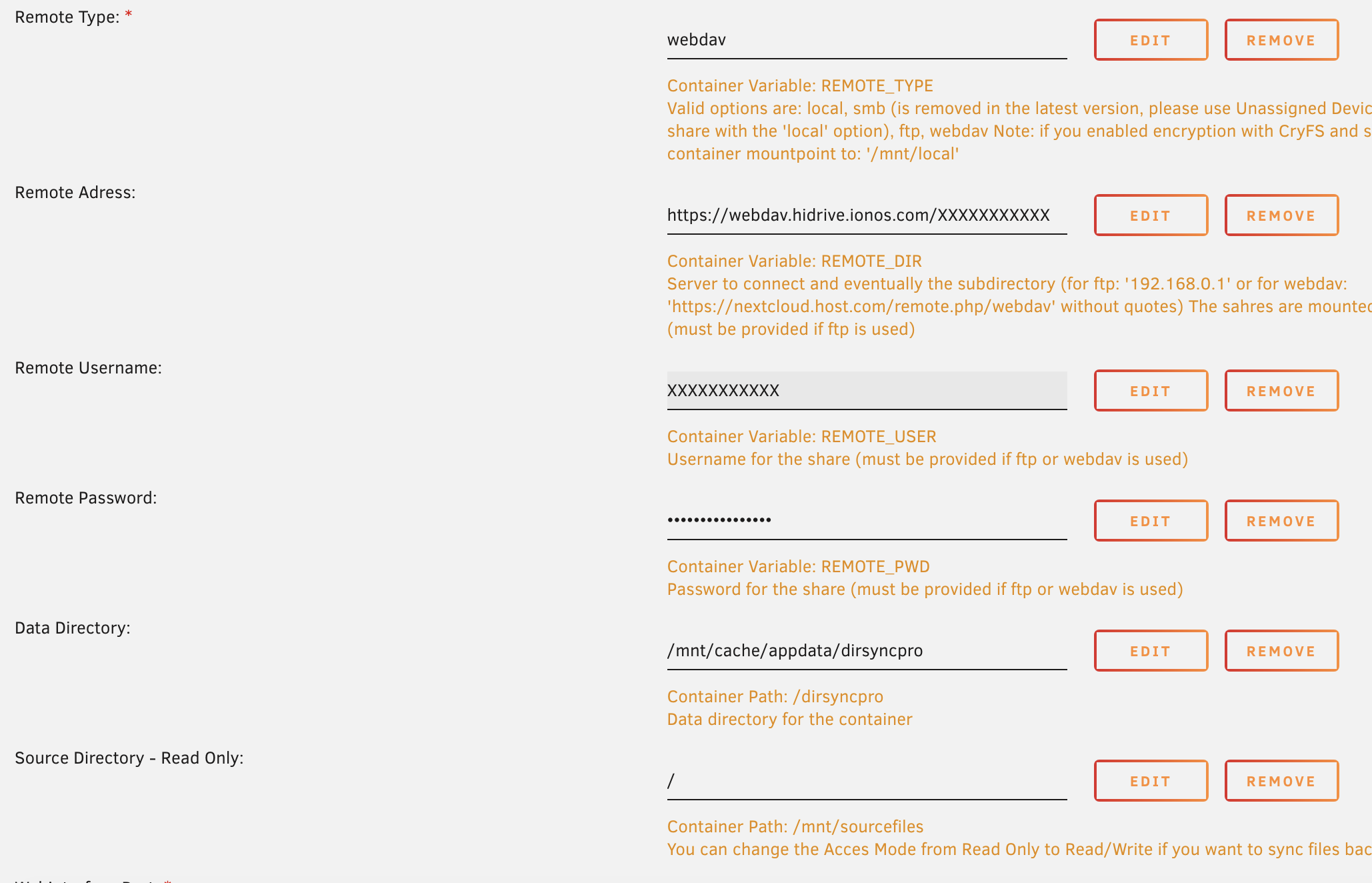

Hi!
I tried to test the DirSyncPro Plugin, but I am not able to start the docker with my WEBDAV-Account.
Here the first lines of the Log-File:
/sbin/mount.davfs: loading kernel module fuse
/sbin/mount.davfs: loading kernel module fuse failed
/sbin/mount.davfs: waiting for /dev/fuse to be created
/sbin/mount.davfs: can't open fuse device
I don't know if the davfs is not available or other parts are missing. I already deleted the docker container and made a fresh install but this did not help.
Does anybody know how I am able to start DirSyncPro with support for WEBDAV or how I install davfs on Unraid. I searched in NerdTools, but there is also no option to add davfs.
Any help is appreciated.
Sven
This is a Docker container and not a Plugin, just for clarification.
I assume that's why you think you have to install davfs on Unraid but that is simply not the case.
Really important information is missing, how did you mount the share, the full log would be helpful too and lastly please post a screenshot from the container.
Please keep in mind that Unraid is not a general purpose server and I strongly discourage installing packages directly onto Unraid itself.
Did you yet look into rclone which is available as a Plugin on the CA App? Depending on what you want to do this could be the right choice instead of DirSyncPro.
Yes, a Docker container, sorry for the mistake, and yes I do know the main difference :)
I am new to the Unraid and Docker stuff, you are right, all necessary protocols etc. are inside the container, isn't it?
I tried to mount the webdav with https://... , I made first test inside a Linux VM and was able to mount the webdav with davfs and the correct https://... adress
Full Log is added as a rtf (I have deleted all the account details, I think you understand that I don't want to share my login details :)
Screenshot of container is added (and also the account details are deleted...)

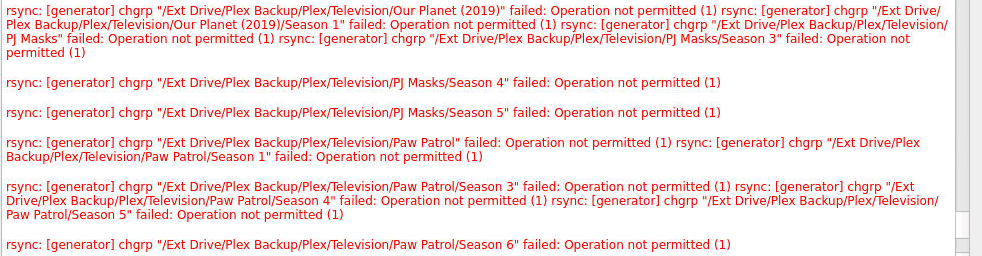

Hi, I am trying to use lucky backup to backup my plex library but i am getting "operation not permitted". I can copy and paste the files using krusader fine.
any suggestions before i look at alternate tools.
How is that Ext Drive mounted/passed and what is it formatted as?
Try to set "Run as Root" to "true" in the template.
You could also try to fix the permissions on the disk if these are only media files which require the user and group 99:100 by issuing these two commands from a Unraid Terminal:
chown -R 99:100 /mnt/disks/DISKNAME
chmod -R 777 /mnt/disks/DISKNAME
(of course replace DISKNAME with the exact disk name)

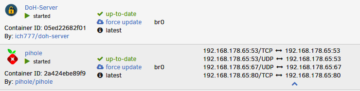

Hi!
I´m currently trying to set up DoH-Server for Devices outside my Network. But I can´t get it to run.
If I test it locally with curl output says:
* Connection #1 to host XXX left intact
* a DOH request is completed, 1 to go
< HTTP/2 502
< date: Tue, 24 Jan 2023 19:54:04 GMT
< content-type: text/html
< strict-transport-security: max-age=63072000;includeSubDomains; preload
< cf-cache-status: DYNAMIC
< nel: {"success_fraction":0,"report_to":"cf-nel","max_age":604800}
< server: cloudflare
< alt-svc: h3=":443"; ma=86400, h3-29=":443"; ma=86400
* Connection #0 to host XXX left intact
* a DOH request is completed, 0 to go
* DOH: Bad ID type A for google.de
* DOH: Bad ID type AAAA for google.de
* Closing connection 0
curl: (6) Couldn't resolve host name
Any help on this?
My DoH-Server and PiHole runs on custom network and NPM on another custom network if that matters.
Can you please share your configuration from the DoH Server?
Usually I recommend to put the DoH Server on br0.
Have you also read the README.md over on GitHub, there are detailed instructions on how to get it working: Click

I have both pihole+DoH on br0:
What IP did you assign to the DoH-Server?
Have you read the linked GitHub README.md yet?
Did you enable Host access on Unraid too?
IP for DoH-Server is: 192.168.178.66. I added it in NPM as http://192.168.178.66:8053 and a custom location to 192.168.178.66/dns-query
I read the Readme and tried to follow it but without success.
Host access is enabled yes. I can´t get my head around what the problem is.
I also added Port 8053 to the DoH Template to see if that helps
