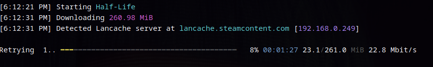

I'm having a problem with the Lancache-Prefill container. The pre-fill container is looking at the Lancache container at 192.168.0.249, rather than the Lancache-DNS container at 192.168.0.248. I have --dns=192.168.0.248 in Extra Parameters.

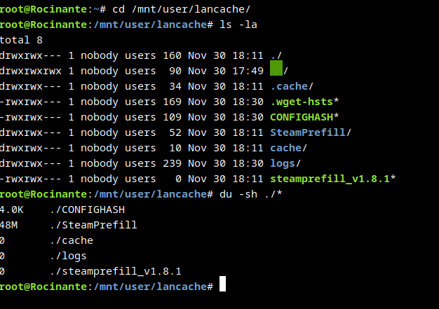

The downloads fail, then continue to retry. I can't see any files in the cache directory when it tries to download either.
Is there a config inside the container that I can change to point it as 192.168.0.248?

I attached a screenshot in my original post of the "Retrying" part, along with the wrong IP. Attached an image of my container set up and my lancache directory.

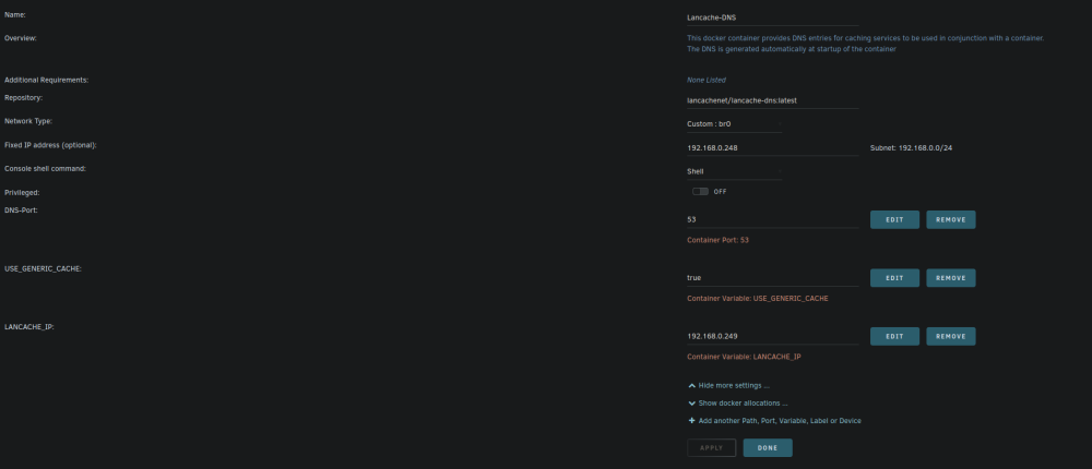

Have you set a valid upstream DNS server in your LANCache-DNS container?
I have not, I only have the default parameters filled in inside the container. Attached a screenshot.

Please also make sure that you set a Upstream DNS with a variable with the Key: UPSTREAM_DNS and as the Value the upstream DNS of you choice, maybe 1.1.1.1
It should by default use 8.8.8.8 but maybe try another one.

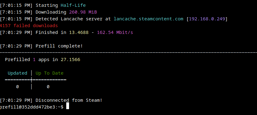

I've tried setting upstream DNS to 1.1.1.1 and got an error - attached. Going to try with 8.8.8.8 and 8.8.4.4.
4157 failed downloads?
I had the same thought, it was only Half Life! Also, I have nowhere near a 162.54Mbit/s connection. More like 60-70Mbit/s

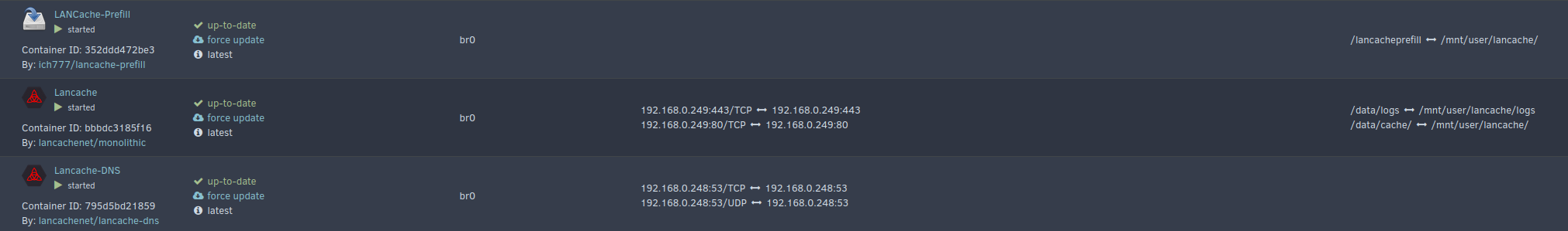

I've enabled it, doesn't seem to have made a difference though. All lancache containers are in the br0 network anyway..
PiHole is in the br0 network aswell, but as mentioned earlier my PiHole set up shouldn't be causing any issues.
