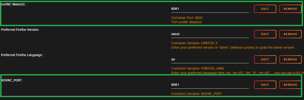

first of all. Thank you for your work. I use a lot of your plugin's and Container's.
Currently i'm trying to route the network traffic of your firefox and jdownloader container through
the Gluetun container. I do that with:
Extra Parameters: --net=container:gluetunvpn
Network Type: None
The Problem is that both container try to listen on port 5900 for the VNC-Server. So the container
which is up at first can start normally.
Is there a way to change that port? This maybe a stupid question because this isn't the right way to do it any way.
But i'm pretty new to unraid and docker so that was the first idea which came to my mind.
may try add 2 anv variables to the 2nd docker with other ports, also dont forget to add these ports then to your vpn docker
RFB_PORT   5901
NOVNC_PORT 8081
this should change the listening ports on jdownloader2 as sample ...
Exactly, it is as simple as @alturismo posted.
Also remember you have to customize the ports in your container that you pass it through too.

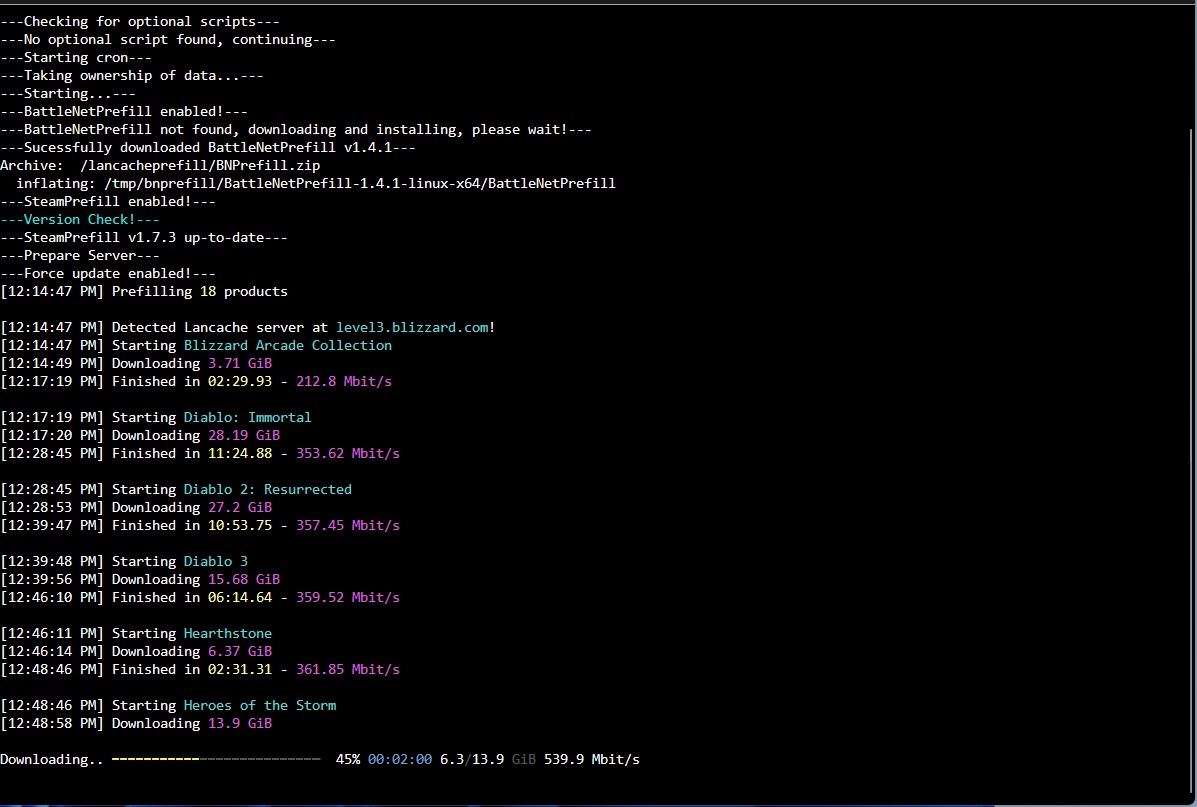

Hm. I used your container since yesterday. First I just downloaded the PreFill-executables from the github directly into the lancache container.
Ill start now fresh. I removed the cache completely and now I redownload everything. I hope this may fix it. Because it is a mess, when my Internet Speed is just used for the lancache prefill stuff when it downloads everything again and again.
This shouldn't happen.
But please make sure that you also specify the --dns parameter in your Extra Parameters from the template with your IP address from the LANCache-DNS server, with this you make sure that it doesn't download everything again from the Internet.
Also make sure that you put the Prefill container on the same Docker network as the LANCache-DNS.
Please report back if everything is working for you or not, really curious...
RFB_PORT   5901
NOVNC_PORT 8081
and thank you for the help. This worked for me.
I guess i have to look for a good for a good tutorial to get a better understanding for Docker and all this
configuration options. For example this:
i guess "noVNC WebGUI" is to open the network path and "NOVNC_PORT" is to tell the contain to route vnc to the port.?
So "NOVNC_PORT" is a Container or Docker specific Command?
Not really because I've only built this option into my container for such a use case like you have here and that it is a bit more flexible <- by default this option isn't in there because it's a real niche use case.
Container.
This is only there to change the port inside the container.
Not really, the noVNC WebGUI is just the port which is opened/exposed so that you can actually open http://CONTAINERIP:PORT, if this is not in you even can't communicate with the container. In simpler terms this is a mapping from the port 8081 in the container to 8081 on the host.
In your case you have to create both Variables as @alturismo pointed out above for one from my containers (doesn't matter which one) because you are using two of my VNC containers within one Docker and you can't use the same port at the same time <- you can compare this like if you are using two applications on the same computer which both of which want to use one specific port and that's simply not possible.
So I would recommend that you create in the Firefox template a variable with the Key: NOVNC_PORT and as Value: 8081 and also another Variable with the Key: RFB_PORT and as Value: 5091 (the RFB_PORT is the VNC server inside the container which needs also to be changed).
After that you have to create a port mapping in your GlutenVPN container for jDownloader as TCP with Container port: 8080 and Host port: WHATEVERYOUWANT (eg: 8091) and a second one for Firefox as TCP with Container port: 8081 and Host port: WHATEVERYOUWANT (eg: 8092) -> then you should be able to connect to the jDownloader container by: GLUTENVPNIP:8091/vnc.html?autoconnect=true and the Firefox container GLUTENVPNIP:8092/vnc.html?autoconnect=true
Hope that makes somewhat sense to you

I did. I readed everything carefully and set everything the right way up. --restart=unless-stopped --dns=192.XXX.XXX.XXX (Just as mask I dont X the ip within the parameters xD)
Nice, maybe something changes in the container to make it even more easy to use but nothing that would change anything significantly to it already works.

Your container cleaned my mess xD It works flawlessly beside my problem with the redownloads.
I hope now that I fixed my redownload bug.
It works as excepted and really nice. I also like the fact, that the Docker "View Log" show the actual downloads.
This is just nice. Also that you included that we are able to set up parameters directly for the Steam-/BattleNet-Prefillers within the Docker template.
May I just want to say thank you for all your work (Nvidia Plugins, Dockers and so on). Appriciate it and love to use them.
So for the next time. Is there a way for me to look for these options?
Yes, i mean it's working. I think we will see next time i have a problem. ;)
If you go through the code… :)
I don‘t expose/mention these variables or better speaking don‘t put it in the template to avaid confusion.
The last time I needed them was about two years ago because a user had a similar use case, again, this is a very niche use case and if you run the container as usual you wouldn‘t need them at all.
thats what i did now ;) and run through another docker, keep in mind
1 network stack
2 (or more listening ports) on the same port never work (nowhere ...), so some dockers may provide some way to change it, most common you would be lost ... @ich777 luckily has it buildin ;) so there was a possibility, but usually you would be ... ;)
in the end, if its not documented you will most likely have no chance, but as i know @ich777 i was pretty sure there is a variable ;)
