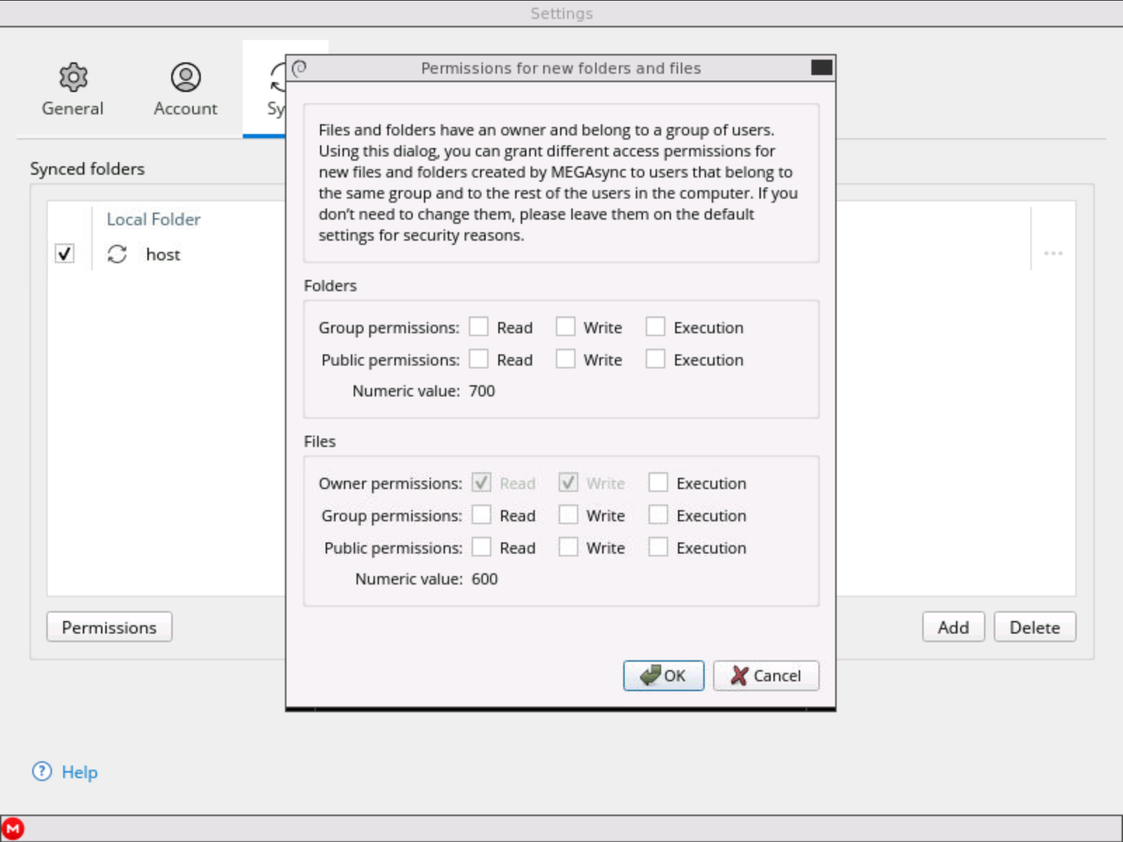

hi there just a minor issue. for files that have been synced down onto a shared folder, the files are showing as rw and thats it instead of rw rw rw. so when i access the share in windows, i can't open any of the files.
I guess I have to chmod 777 the folder and files?
any chance of a fix or what might be causing this issue?
Which container?
luckyBackup?
Make sure that you select preserve privileges in the advanced options from the sync
Just now, ich777 said:
Which container?
Sorry, its the megasync docker container
What permissions do the files have when you upload them?
Do you run the container with UID 99, GID 100 and UMASK 000?
the files are being downloaded from mega onto the unraid server and it is being ran with uid 99, gid 100, and umask 000. the files are not corrupted or anything as i can view them fine in the mega app
Edited by Goldmaster
I‘ve initially designed the container to upload files to Mega.
Anyways, isn‘t there an option within the Mega app to set the permissions or am I mistaken?
You can also try rclone from the CA App if it‘s the same there too.
yes there is, so not sure if group permissions for folders are meant to have read, write and execution ticked and files for owner set to execution as well?
I think all the tick boxes are ment to be ticked so that the numeric value for folders and files is 777?image.thumb.png.7627d22ce5810bb2d27f3ea571e20a22.png
Exactly, 777 is basically allow everything for everyone… rwxrwxrwx
