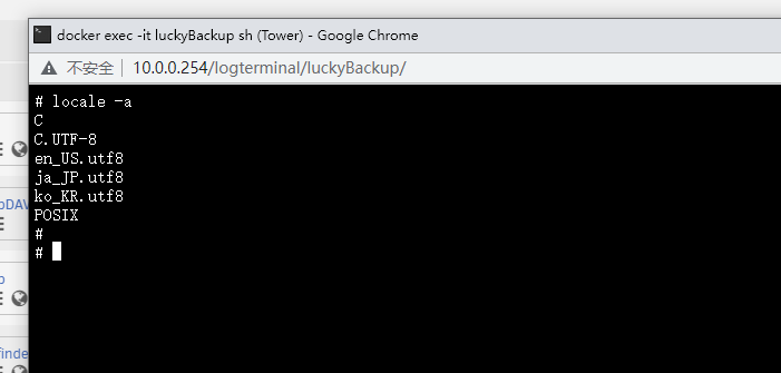

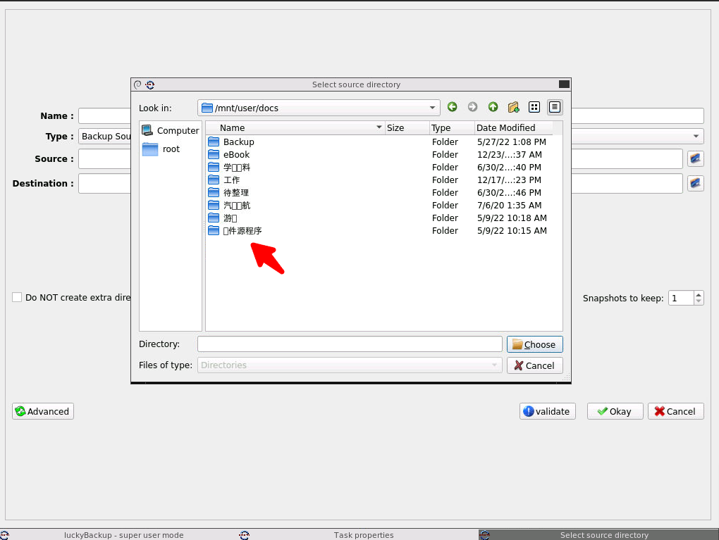

luckyBackup have some probrom
Unable to support Chinese fonts, please add Chinese font support, thank you! !

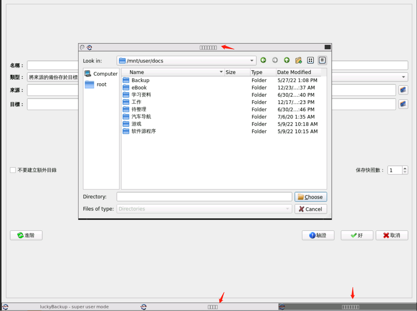

the newer one is better,but still have some problems,like this:
and I Cannot enter Chinese characters
I suggest adding a few variables:
LANG=zh_CN.UTF-8
ENABLE_CJK_FONT=1 (When set to 1, open-source computer font WenQuanYi Zen Hei is installed. This font contains a large range of Chinese/Japanese/Korean characters.)
thank you very much!!!
48 minutes ago, xgxxl89 said:
LANG=zh_CN.UTF-8
Simply add that as a environment variable in your Docker template and it should work.
This is also doable with a variable in your Docker template, but I have to look into that how to install it.
Users have reported that with this added fonts everything is working:
ttf-wqy-zenhei fonts-wqy-microhei fonts-takao fonts-arphic-uming fonts-noto-cjk
The terminal is a whole different story usually, can you enter chinese fonts a Unraid terminal?
This is maybe a issue from luckyBackup and QT itself that I'm maybe not able to fix if it's built without support for that fonts.

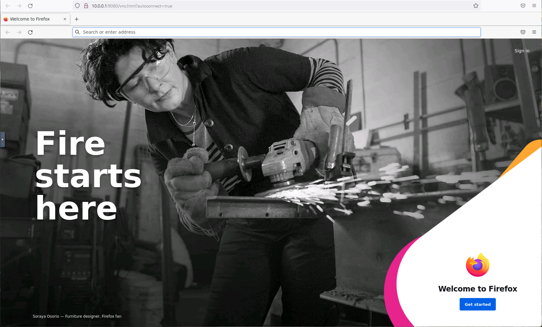

I have been using the firefox container for some time and it has worked great. Today firefox crashed so I restarted the container and now firefox will not maximize for some reason and I can't figure out why.
I even resorted to completely wiping the whole container and reinstalling it (including appdata) yet the same issue persists. Nothing has changed on the server or my PC in this time.
Click on the little arrow on the left side, click on the gear icon and please look to what scaling is set to, it should be set to remote scaling.
Have you yet tried to restart the container? Have you also yet tried to resize your browser window?
EDIT: On a fresh installed container it is working as expected on my machine (even if I resize my browser window and set it to remote scaling):
Yep, I tried that but nothing changes regardless of the scaling setting. The black part seems to be part of the active "desktop" but firefox is simply not maximized to fill it for some reason.
Yes, restarted and reinstalled it a few times now.
The mouse turns to an X anytime I try to adjust any settings that might allow me to maximize it.
Yes, because that's disabled and the container, or better speaking the window manager, should handle the maximizing from the window.
Have you also deleted the folder for firefox that lives in your appdata directory?
