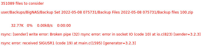

Ok I formatted the drive in XFS, but now I get this error:
I made a screenshot because luckybackup won't copy paste the text.

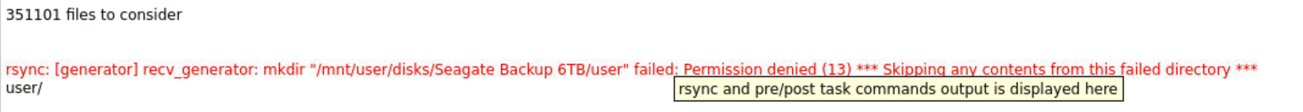

This drive is mounted through UD or am I wrong, how did you mount it?
Have you selected "Read/Write Slave"?
I have indeed mounted it through Unassigned Devices. Where do I select read/write slave? Should that be on or off?
In the Docker template in the mount point (EDIT button) make sure to select Read/Write Slave.
I have edited that setting and now I have a new error:
Looks like I can't access my newly formatted drive. Why?
Are you sure that it's set to read/write and not only to read?
I think you aren't running luckyBackup as root?
I am not. Is that necessary? It says "This is only needed if you want to create backups from your /boot drive or other directories that require root privileges". I'm not creating a backup of my boot drive to my knowledge.
I also can't access the XFS formatted drive through SMB.
No not really but this could be also a reason why it's not working.
I can only thing of a permission issue.
Run from a terminal something like this:
chmod -R 777 "/mnt/user/disks/Seagate Backup 6TB"
chown -R 99:100 "/mnt/user/disks/Seagate Backup 6TB"
(please change the path to the disks if it's not correct, I've read that from your screenshot - typos included... :D )
I would also recommend that you first change the name from the partition to something without spaces. Spaces are never really good in Linux, at least from my experience.
I've changed the name to Seagate_Backup_6TB, ran luckybackup as root and the backup seems to be working fine now.
I also tried chmod and that seems to have done the trick. Haven't tried chown yet, is that still necessary?
No, if everything is working fine you don‘t need to run that. :)

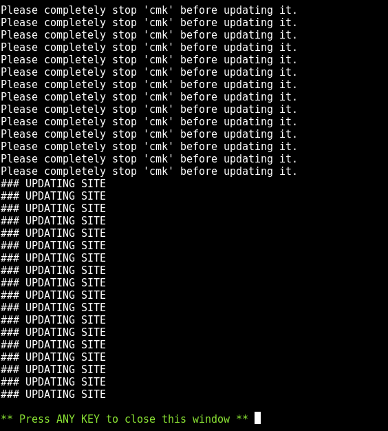

I attempted to install check_mk, but upon it trying to start up, I just keep getting the following in the logs while it is rapidly restarting:
Not quite sure what to do about this.
I think you are talking about the Checkmk-RAW container.
On what Unraid version are you?
This is the output from a fresh pulled container from the CA App:
Spoiler

Maybe try the following:
  1. Remove the container
  2. Remove the directory that was created in your appdata folder for checkmk
  3. Pull a fresh copy from the CA App
Scratch that, after installing it on my server, I couldn't stop the container and also couln't remove it. I've then restarted my server and Docker and emhttp weren't working properly anymore. After starting the Docker service manually the container auto started but I've never enabled that, I had to remove the image for the container itself manually to get everything back to a working state.
I pulled both the Checkmk-RAW and Checkmk Agen plugin from the CA App because they gave me both a lot of trouble in the past and I really want that this happens to someone which is not that familiar with the command line and how to remove a Docker image manually...
