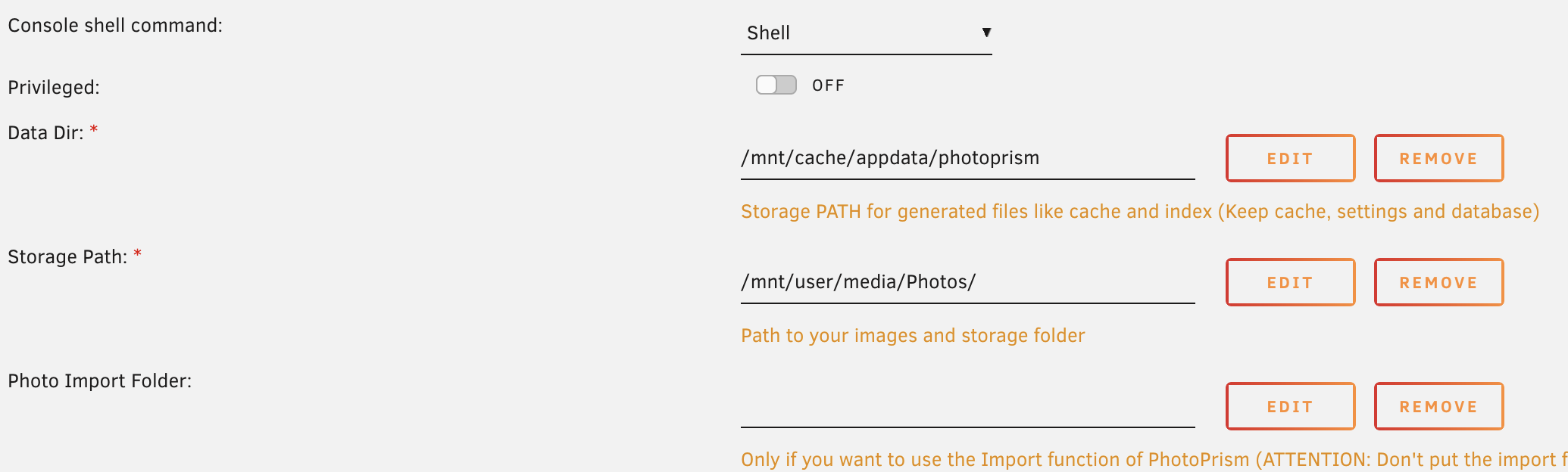

N00b question about PhotoPrism. I set up the docker in UnRaid and it works, but I can't for the life of me figure out where the originals/storage folders are. I know the one I specified in the docker setup but that's the only folder I can see. Is there a way in the GUI to change where the folders are located?
Can you explain this a little bit more since I'm not understanding the question I think...
You map a path from your host to the container and when you put files in the folder on the host they will be also shown in the container.
Inside the container the path should be "/photoprism/originals", "/photoprism/import" and "/photoprism/storage" the last one isn't changeable, but that also shouldn't matter because only the path that you've specified on the host (Docker template) should matter.
Post a screenshot from your Docker template please.
Yeah, i didn't know how to explain it well :D. I also left the /photoprism/storage path alone in the "more settings" section. Basically I can't see any of the container paths that are referenced, in particular the originals folder.
I'm also interested in setting up to use with Nextcloud which i have to set up again too, not sure if that would change where I have the first Storage Path pointed to.
Edited by eubbenhadd
Where? In the container?
I would also recommend that you set an import folder.
Have you already seen this:
There are also many ways you can connect Photoprism to the Nextcloud, I would recommend that you read also the Documentation from Photoprism here (hint: also take a look at the Sync Settings in the documentation).
oh sweet, I didn't realize Ibracorp did a video on Photoprism. Haven't seen it yet but I'm sure I'll be all set. Their videos are amazing
NM. I watched the video and set it up as they did but still don't understand where to put my originals etc. The documentation site was a little scant on setup config info at least for what I am trying to understand.
