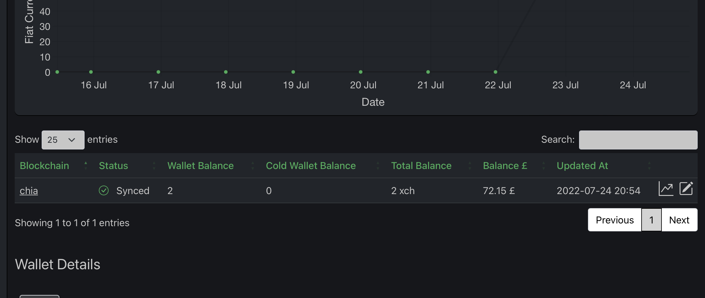

Hello. I’m using machinaris and I won my first two chia coins two days ago.
I can see that they are in my wallet, but they are not in my “Cold Wallet” how do i get them into my nucle wallet so that I have them available for exchange if i wanted to?
Thanks in advance.

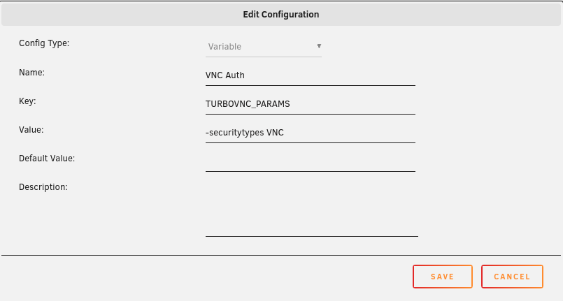

On 7/21/2022 at 6:13 PM, robocat said:
Still crashes with the same error.
Have no issue with it when creating a environment variable 'TURBOVNC_PARAMS' and set it to:
-securitytypes VNC
Here is the log output:

Are you sure that you've set the password first before creating the variable? Also please make sure that you are enter the commands like in this post: Click
Maybe something else has changed on the Synology side in terms of Docker.

I now realise my mistake.
I had the password previously set as in the instructions. During all my troubleshooting, at a certain point I threw away everything and started over. So the password was no longer set.
So for Synology users, setting -securitytypes VNC is the correct answer.
Thanks for the help.  I use this to backup multiple IMAP accounts to my Synology, combined with filesystem snapshots for version control.

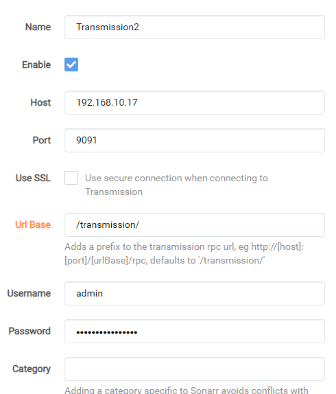

Hi, I'm having issues with the OpenVPN-Client container, and the routing of local traffic between docker containers, through the OVPN container
I'm trying to use this container as the VPN gateway for some dockers, one of which is Transmission.
My setup is as following:

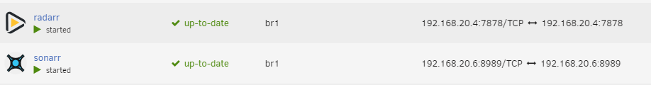

I have Sonarr/Radarr etc on a subnet 192.168.20.0/24, which is gatewayed through another OpenVPN connection (hosted in a VM if it matters). I also have a transmission container on this subnet.
I have a 2nd transmission container (I'll call transmission2) on the "container:OpenVPN-Client" network. This can connect to the internet through the OVPN connection absolutely fine.
My unraid server sits on the 192.168.10.0/24 subnet (exc a selection of dockers, as mentioned above)
I'm trying to have Sonarr & Radarr connect to transmission2, so that I can utilise 2 different VPN connections from my 2 different transmission instances.
If I remove the OpenVPN-Client container/put transmission2 onto my server subnet via a dedicated IP, or via a host connection, Sonarr & Radarr can connect to it fine (this makes me think it's not an issue with my router firewall, as traffic is getting between subnets fine). When I put it through the OpenVPN-Client network, they cannot communicate, therefore I believe I have missed something in regards to port mappings etc within the OpenVPN-Client.
the mappings etc for the containers in question are below:
My Sonarr download client config:
Any help to resolve would be greatly appreciated. Let me know if there's anything more needed to troubleshoot.

You are mixing multiple networks I think there is the issue.
Why not putting Sonarr and Radarr on bridge network too?
In order to make this work you have either Enable "Host access to custom networks" in the Docker settings:
Or not put it on a custom brX network.
The default bridge network and other networks can't communicate with each other, that's a Docker safety feature.
Thanks for the quick reply.
It might not be the most elegant way to do it, but probably more that it's appeared out of multiple small changes & additions, and I'd rather not rip everything up & start again. I have Sonarr & Radarr on on br1, as that's my "VPN network". all decides on this subnet go through the OVPN running in my VM (this was created before there was/I found there was an OpvenVPN Client docker (probably been that way for a couple of years min), as a means to get all the traffic through a VPN whilst only utilising a single VPN "Device".
I've enabled the "Host access to custom networks", and kept the rest of my settings the same & it seems to have fixed it. Thank you!
I didn't realise the default bridge can't communicate with other networks, and that explains why it can't communicate & why I couldn't find what was wrong. - Is this what the above setting changes, or is that something else?
Yes.
