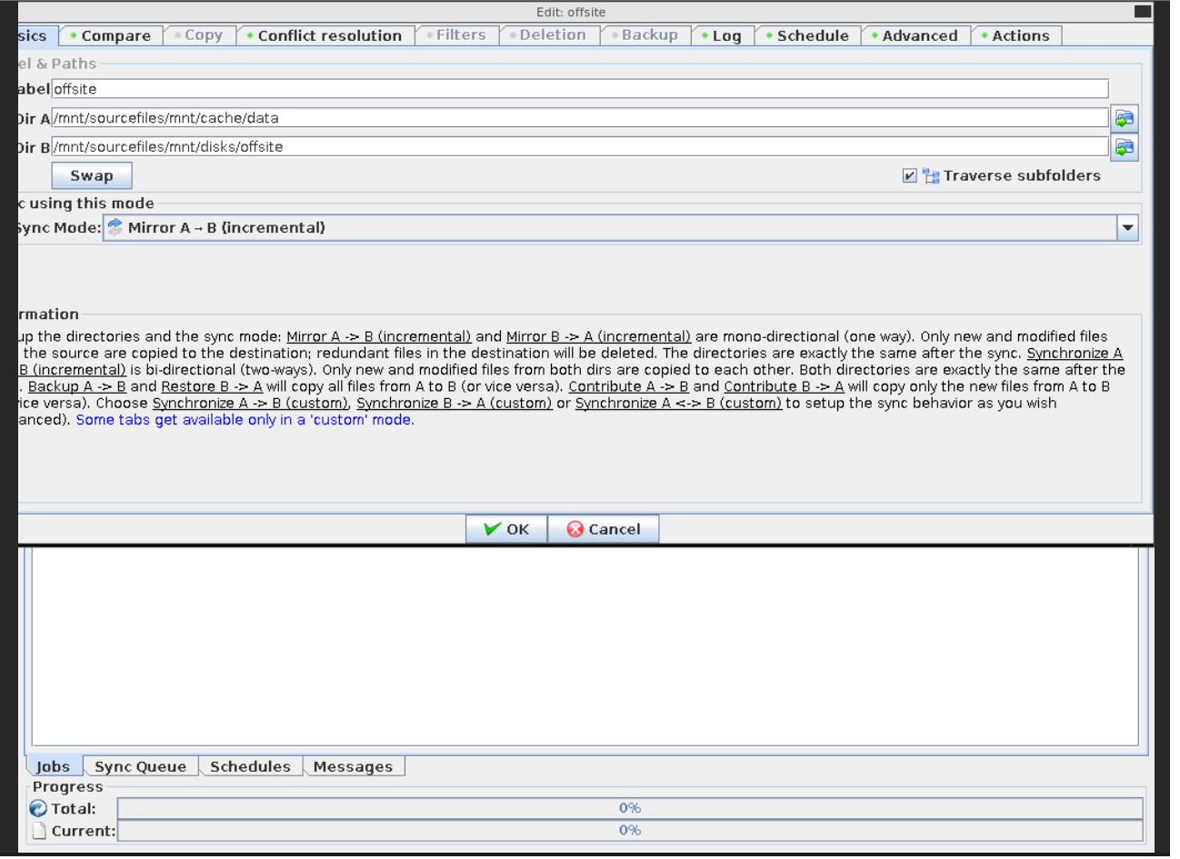

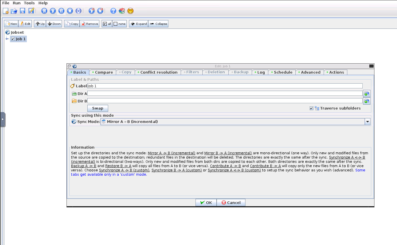

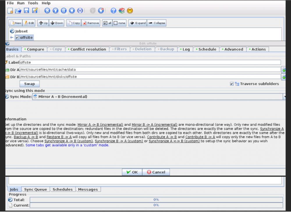

when i restart the dirsyncpro docker i get the window looking like the first screenshot, then as soon as i try to edit a second thing (even if the same thing twice) it changes to the second screenshot, neither one fits the screen like it should, any known way to adjust that?
This was actually done by design... :D

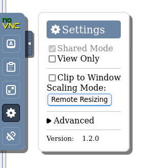

However you should be able to change this by clicking on the little Arrow at the left side, click on the gear icon and select at Scaling Mode "Remote Resizing":
This will fill the entire browser window with DirSyncPro and should fix this... ;)
