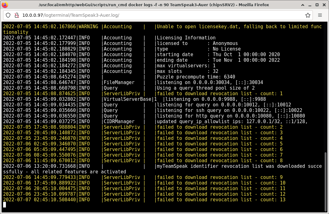

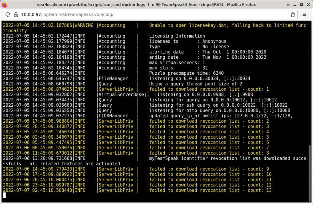

Hi, i have in the Logs of the Teamspeak Docker an Entry:
"|ServerLibPriv |   |failed to download revocation list - count: 20"
"|ServerLibPriv |   |failed to download revocation list - count: 21"
"|ServerLibPriv |   |failed to download revocation list - count: 22"
Is this a Problem and what does this mean?
This shouldn't be an issue at all, even on my server it's the same:
The issue with this is a bit more complicated and should not cause any issues whatsoever.
It should be resolved after a few hours or days, this is not really an error message, this is more a warning.

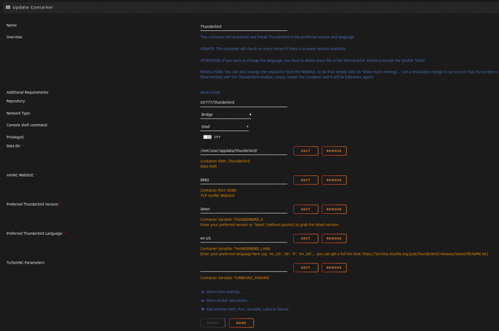

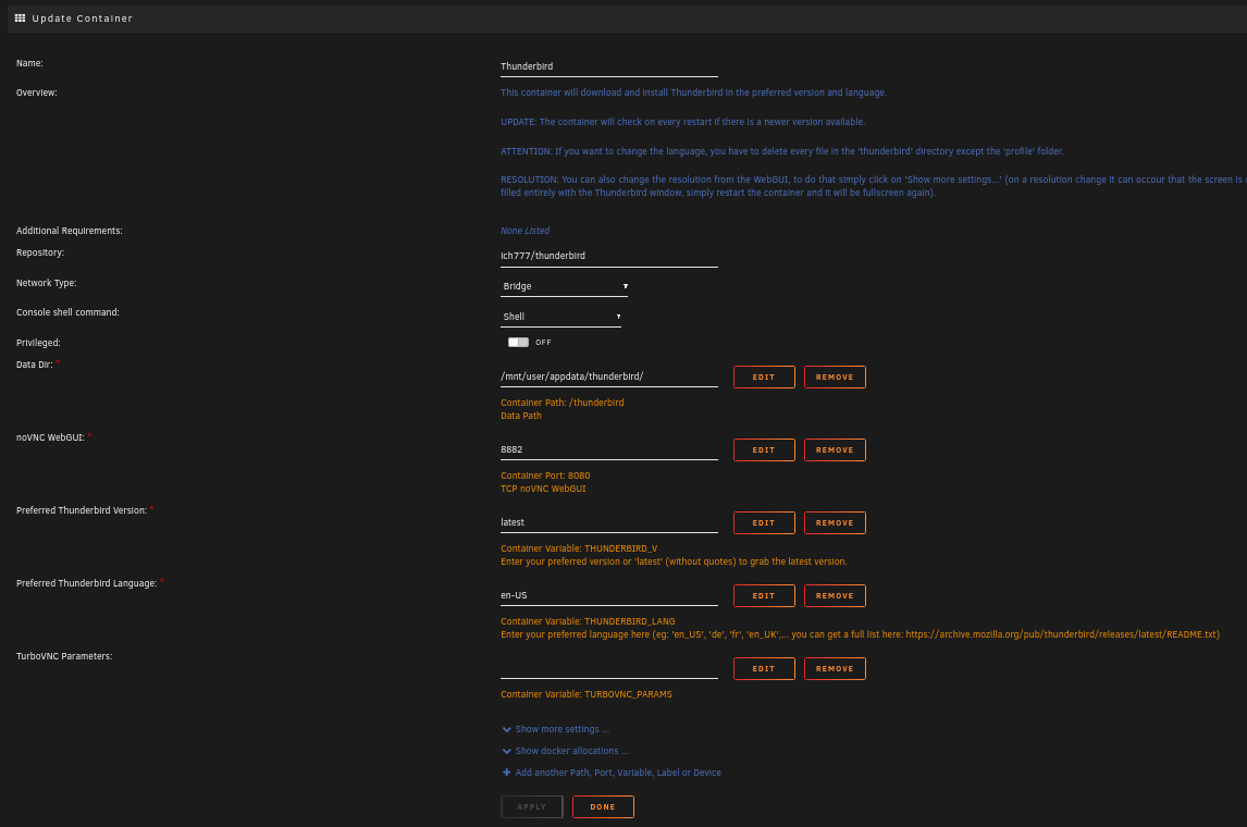

On 7/4/2022 at 10:22 PM, BKS said:
Tried version specifying as above as well as latest. Any other ideas?
On what Unraid version are you?
Please remove the "TurboVNC Parameters" variable entirely and report back.
6.10.3 -- Removing that parameter worked! Thanks
