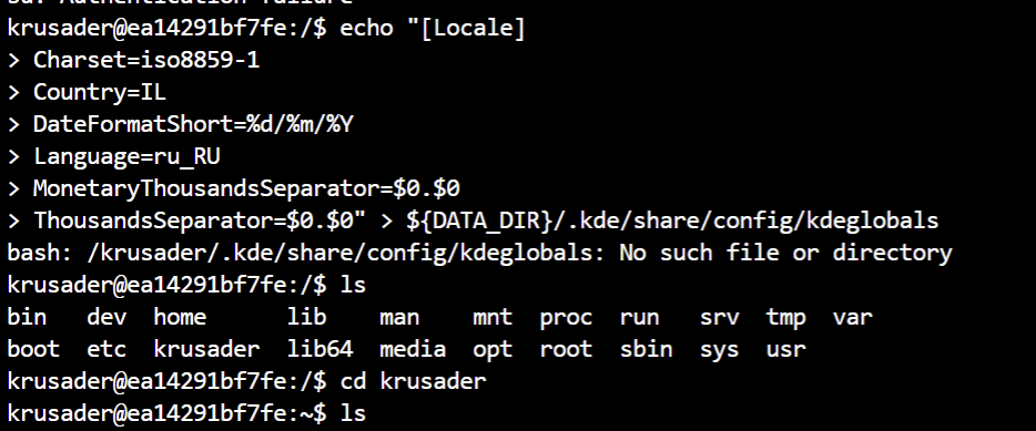

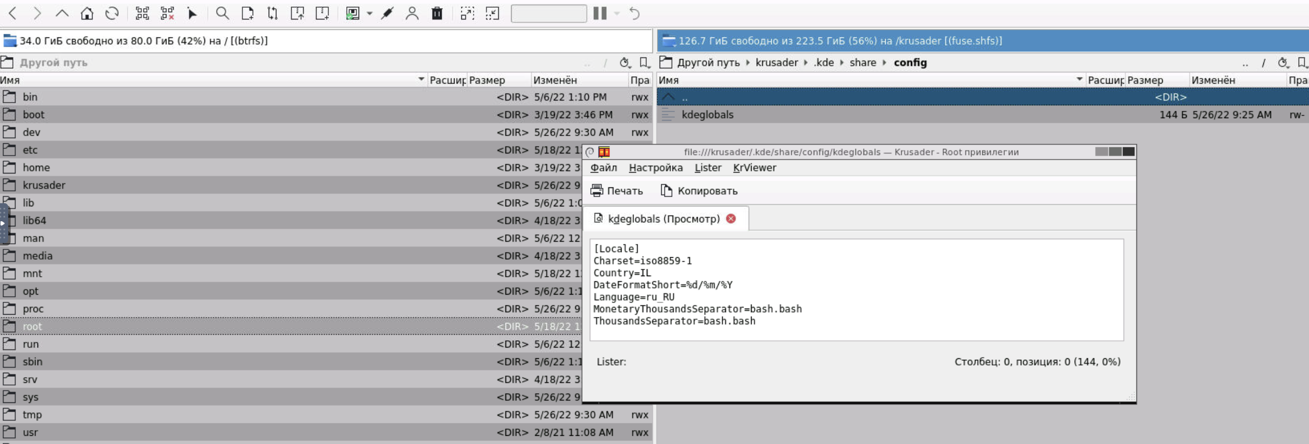

How we can change date format in Krusader ?
example: from 12h to 24h and from mm/dd/yy to dd/mm/yy ?
Open up the container console and type in this:
su $USER
mkdir -p ${DATA_DIR}/.kde/share/config/kdeglobals
echo "[Locale]
Charset=iso8859-1
Country=GB
DateFormatShort=%d/%m/%Y
Language=en_GB
MonetaryThousandsSeparator=$0.$0
ThousandsSeparator=$0.$0" > ${DATA_DIR}/.kde/share/config/kdeglobals
Then close the console window and restart the container.
Hope that helps.

Thanks , i will try i hope it will be saved after container update ,becose i have sometime some setting is lost , i think after container update maybe .... ( like editor and profil name , etc ...)
should i specify DATA_DIR  ?
changed to /krusader/.config for file will appear in /mnt/user/appdata/krusader/.config but nothing changed ...

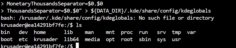

Sorry it was already late yesterday, forgot to include this line
Changed the complete command above too.
Sorry that i dont realised to make directory , kdeglobals should be file right ?
but after that somehow not working ...
I have to look into this further, I never need to change the date nor the time...
