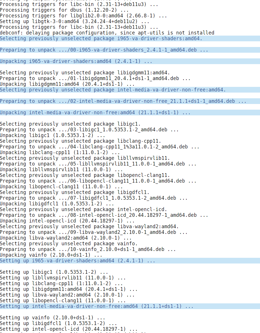

11 hours ago, ich777 said:
Can you try to use as the key: h264_vaapi instead of h264_qsv
i have CPU i5 4440i , i changed to "intel" from "h264_qsv" like in they new docker-compose.yml ,they moved to autodetect. but i can check for h264_vaapi...
## Hardware video transcoding config (optional):
# PHOTOPRISM_FFMPEG_ENCODER: "nvidia" # FFmpeg Encoders ("software", "intel", "nvidia", "apple", "v4l2", "vaapi")
also i think its install same drivers in both ways ( "intel" and "h264_qsv")

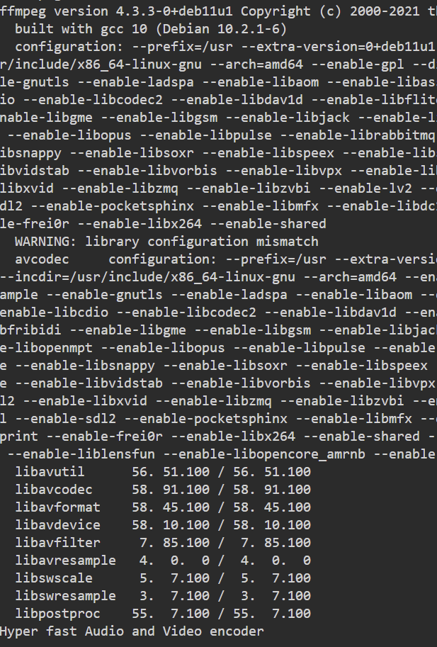

also i have some warning in ffmpeg :
 WARNING: library configuration mismatch
This is something that should be reported on the Photoprism Github since this is container specific, is it now working?

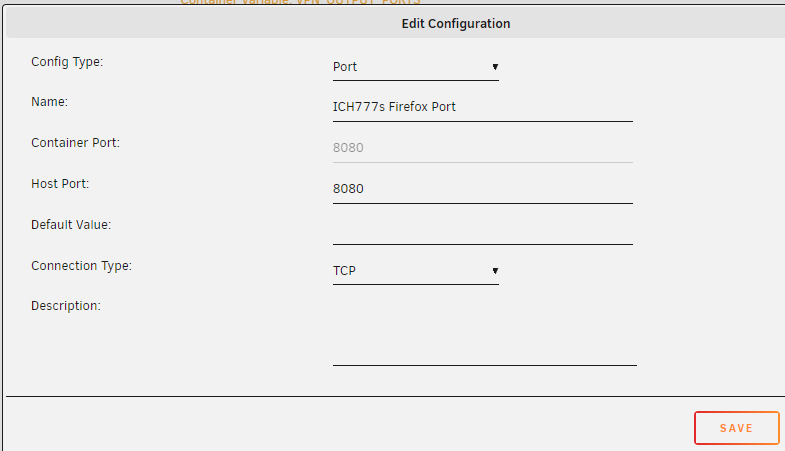

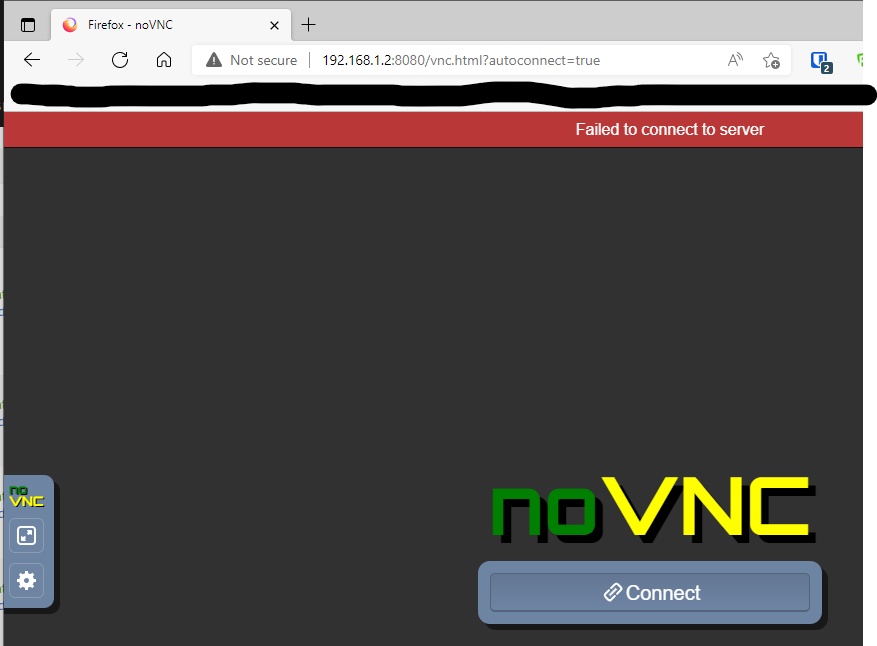

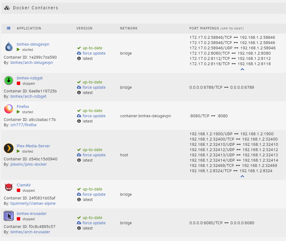

Hey, I'm using the firefox docker and it seems to work fine, however I'm trying to VPN / privoxy it through binhex-delugevpn container. Deluge VPN works fine, so I added  "--net=container:binhex-delugevpn" to the extra parameters, set the network to "none", and added 8080 to the ports in the binhex-delugevpn docker., but for some reason I can't then get firefox to work. When i try to click on the GUI (or go to the IP address of the server plus 8080), it has an error on the web browser saying "blocked".
Any ideas what I'm doing wrong and how to get the firefox docker to go through the VPN?
Can you add a few screenshots from what you've made so far (port mappings), is maybe another container using port 8080 already in that container?
I don't think anything else is using the 8080 port; screenshots added.

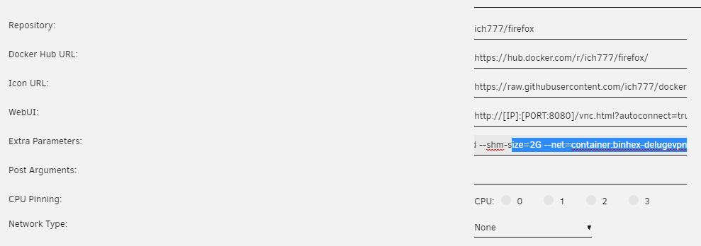

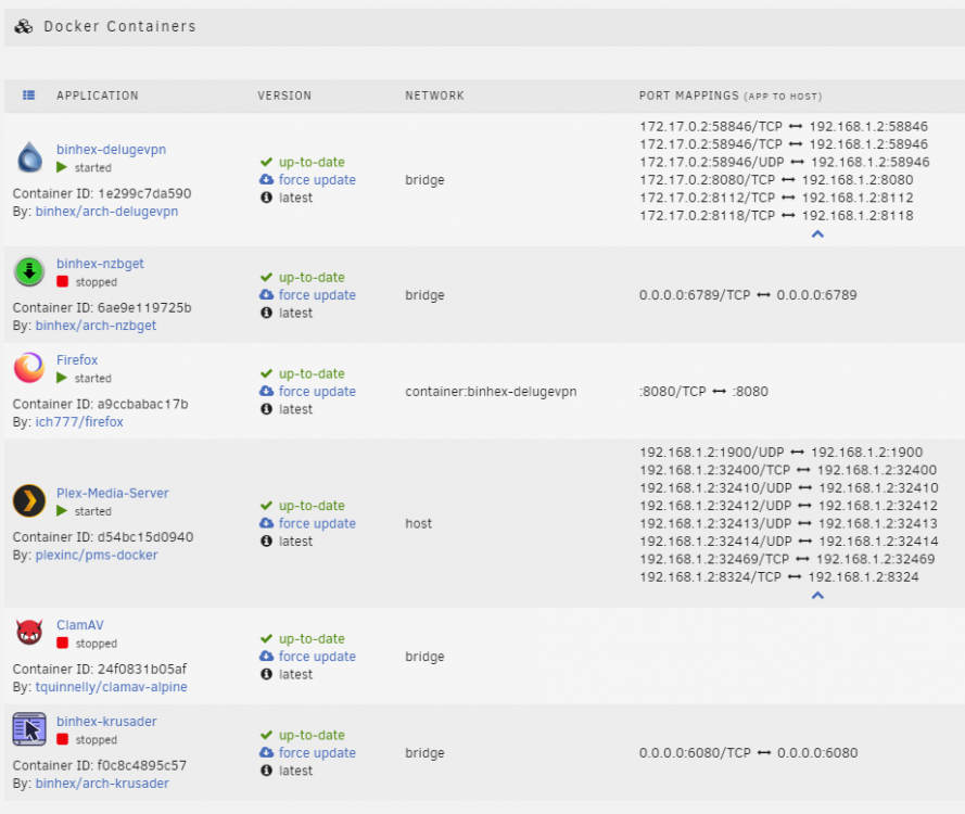

1. all port mappings in my dockers:573848295_Allcontainerdockerports.thumb.png.49dab585e244d2a8bc0cce26573c10e3.png
2. settings when adding firefox port to delugevpn docker:
3. firefox docker settings for network:967621556_firefoxsettings.png.0e43f579bbdaf952125b61db0640de68.png
4. error when clicking on firefox webGUI link:
5. error when trying to use the IP & port of the server and firefox container:
anything give any clues there? Thank you for helping!
Binhex has a FAQ that covers adding the required settings to his VPN containers that add exceptions to the firewall rules for input and output ports.
Thank you - had another read of the FAQ and realised that the instructions have changed a bit since the SpaceInvaderOne video i was following, and I had to add the 8080 port to another field in the binhex vpn docker. All working now - cheers!

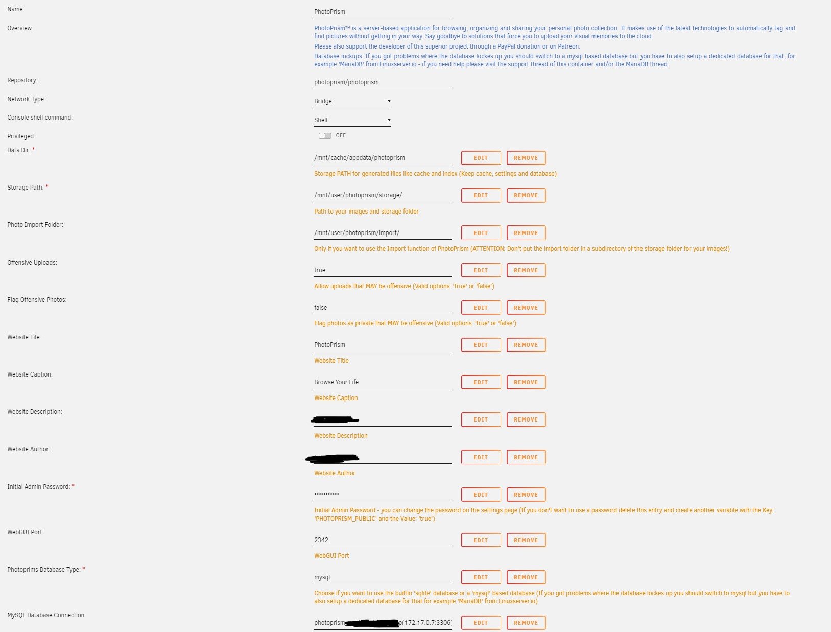

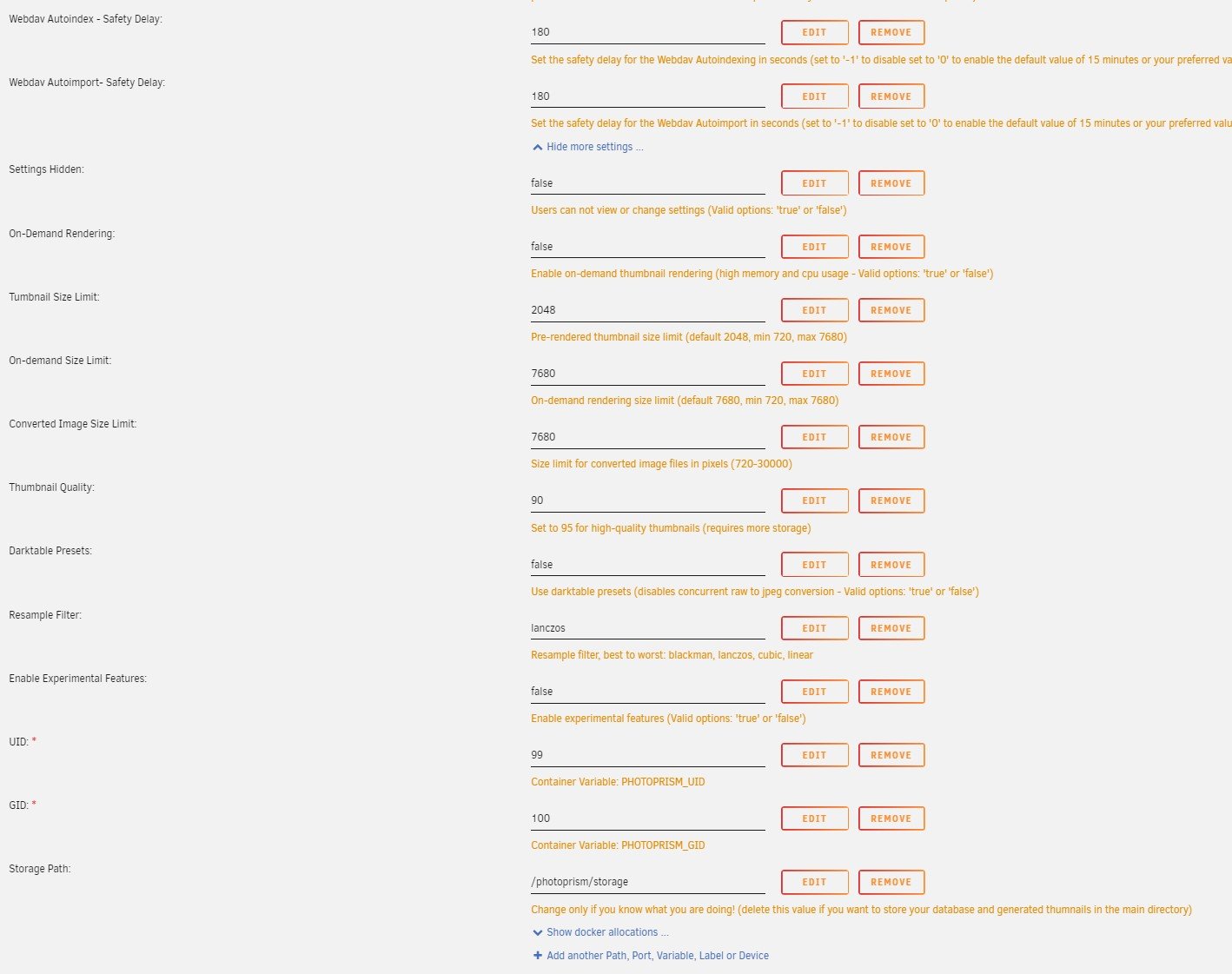

Hey there, i'm having trubble with photoprism converting RAW to JPEG when importing new pictures
2022-04-12 23:49:49 INFO import: deleted empty folder /photoprism/import/upload/1649800137033
2022-04-12 23:49:49 ERRO import: path lookup '/photoprism/.config/darktable' fails with: 'No such file or directory' in 2018/11/20181104_193232_448B7C67.cr2 (convert to jpeg)
2022-04-12 23:49:49 INFO darktable-cli: converting 2018/11/20181104_193232_448B7C67.cr2 to jpg
2022-04-12 23:49:49 INFO import: moving main raw file 8J0A0357.CR2 to 2018/11/20181104_193232_448B7C67.cr2
2022-04-12 23:49:49 INFO media: 8J0A0357.CR2 was taken at 2018-11-04 19:32:32 +0000 UTC (meta)
I dont't have any clue, everything other is running flawless
Can you please post a screenshot from your template and post your Diagnostics?
1 hour ago, Sanke said:
Sure, here you go
Couldn't find anything suspicious...
I would recommend that you've create an issue on their official Github here: Click
