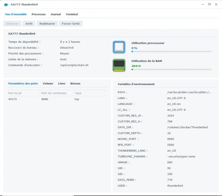

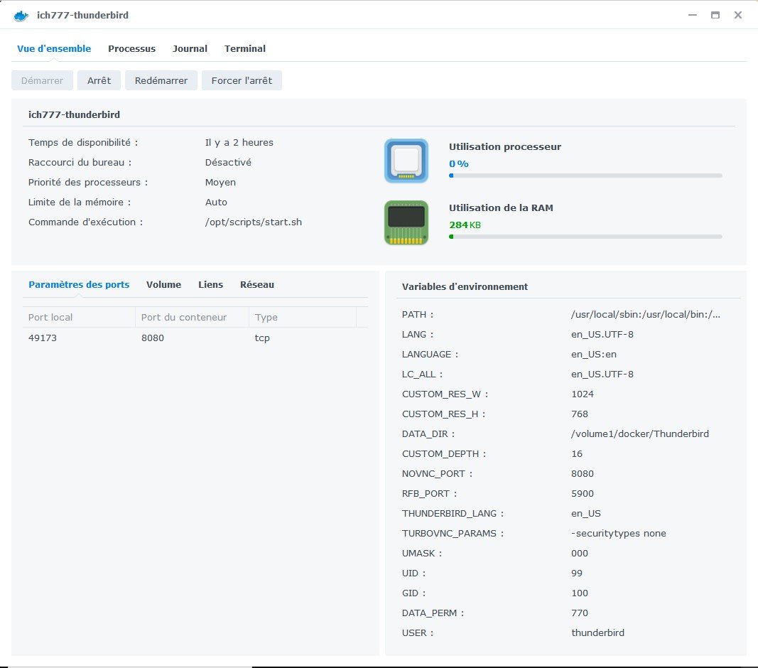

I'm trying to use your thunderbird container on a synology 920+ NAS with docker. Its got a Intel Celeron J4125 CPU.
I get the same problem as Wolf had last year. The container is starting but thunderbird does not install, saying that something went wrong, and that the container has been put in sleep mode, but it gives no information on what went wrong...

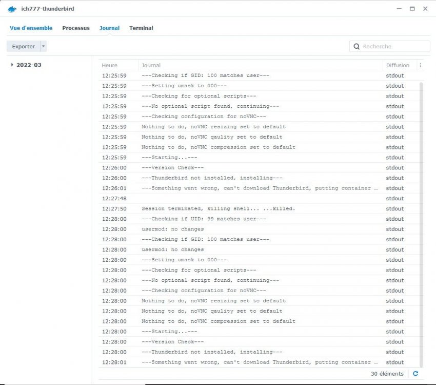

Here is what the journal says:
617152450_Capturedcran2022-03-28153536.thumb.jpg.2e98970ec06cd472f70b1eacdc76f637.jpg
And the docker template is looking like so:
1916028257_Capturedcran2022-03-28153329.thumb.jpg.9007860a0ba4f5ca8af481f0c37a1e4c.jpg
Do you see anything that could help me get this container working on my NAS?
Thank you.
The variable THUNDERBIRD_LANG is wrong, it should be en-US instead of en_US.
This is actually my fault, I've changed it in the readme but forgot to change it in the Docker template.
I've already pushed a update where it should be fixed but because you already have the language already wrong in your variables simply change it to en-US or whatever you like.
I think you are French from what I see in your screenshot, maybe change it to "fr" (without the double quotes) in your case, you can get a full list here: Click
Hope that helps! :)

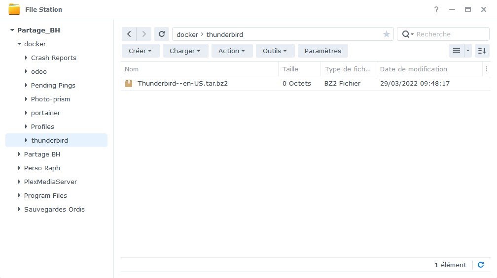

Hello ICH777,
Thanks a lot for your so quick answer.
That's actually a mistake, and I changed it, but that's not THE mistake. I'm quite sure I'm making another mistake somewhere or missing something when installing it or after installing it.
In fact, when I launch the container, the install starts but stops almost immediately, and i'm left with this file in my thunderbird folder:
856503244_Capturedcran2022-03-29100728.thumb.jpg.efedaa051c4b32baa2ce0ac23de47cba.jpg
When I change the en-US for fr, it starts to download the "Thunderbird--fr.tar.bz2" archive, but it also stops at 0 octet and the journal still says "something went wrong..."
I would understand if you don't have time for that, but I think I'm missing something when installing the container.
Thank you for your help!
You are missing this variable:
Please look at the run example on Github (I would also recommend that you try Unraid because there it works just flawlessly because there is already a template for the container available with all necessary variables, volumes,... :) )
Why shouldn't I? That's my container that I maintain and try to fix such issues and help out. ;)
Already pushed another update to the container that should fix this on non Unraid installations (btw, thank you for the report :) ).
That works perfect!!!!
Thanks a lot, I owe you one if ever I can.
Thank you for your great job! 👏👏👏

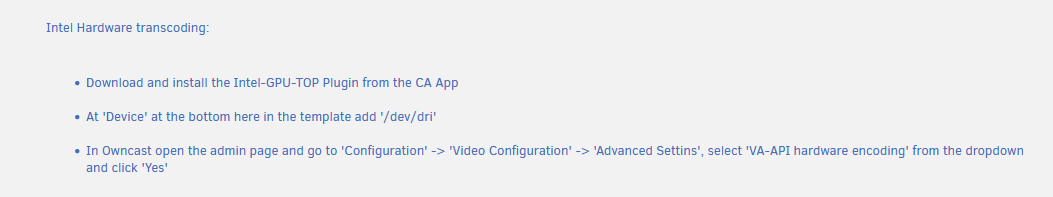

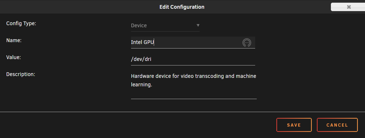

hi ich777,

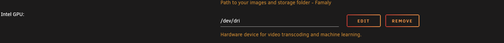

i got a problem where do i put in the Intel '/dev/dri'
At owncast?

2 hours ago, Russ3lHD said:
At owncast?
I think the description from the container should be clear enough:

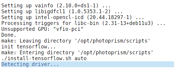

@ich777 I have a problem with playing HEVC H.265 files on Photoprism , using intel iGPU , gt620 in vfio.
(https://github.com/photoprism/photoprism/discussions/2210)
i changed PHOTOPRISM_FFMPEG_ENCODER to intel from h264_qsv but also having same error :
Also i have Unsupported GPU: "vfio-pci" in log on first start . but on vfio i have gt620 and Intel-GPU-TOP Driver installed in Unraid .
I know you only made a template but maybe you can tell some direction where to look or maybe some one had this issure and fixed it ?

Do you have passed through the device /dev/dri in the template (device not path!)?
1 hour ago, ich777 said:
A GT620 would be not compatible with h265 anyways.
i passed it for VM but not using it for now , becose have a lot of dockers and  dont have anouth CPU power for VMs ...
Yes
This is because it detects all devices also the card that you've bound to VFIO but that's basically a warning.
