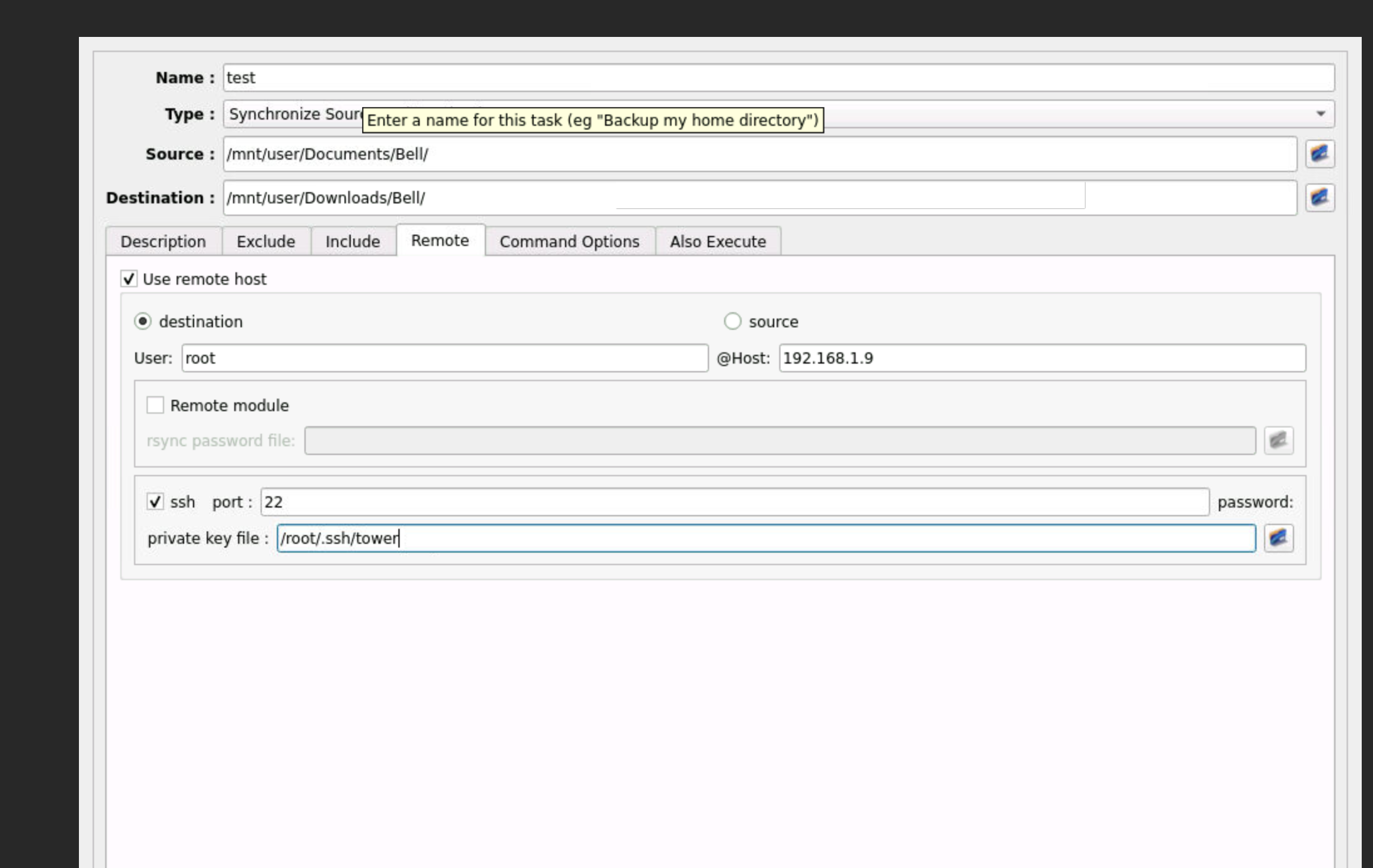

I can only tell you that it is working just fine and flawlessly on my instance (I run Backup on a foreign server that connects to my server and backups up everything.

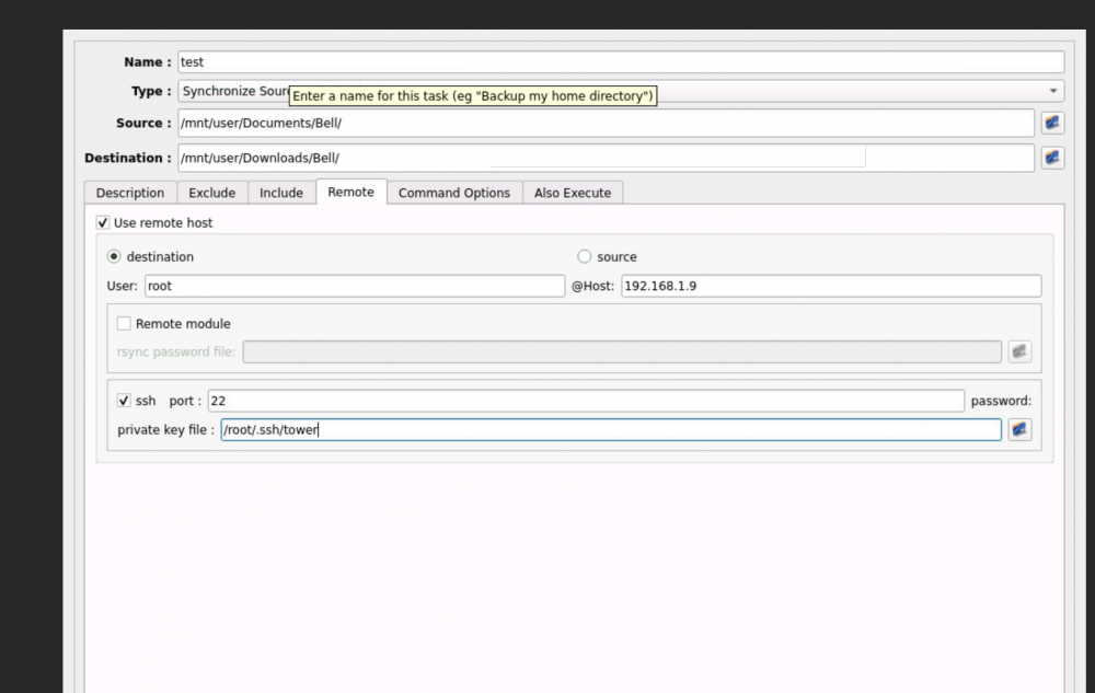

Answer the following questions:
  1. Do you want to backup to the server where luckyBackup is running or do you want to backup form luckyBackup to another Unraid server?
  2. Can you post a screenshot from the task where I can see which private key you've used?
  3. Have you restarted sshd on the foreign server after putting the public key to the autorized_hosts file?

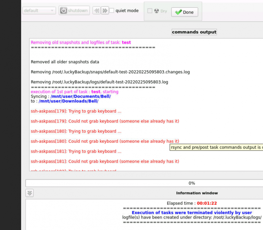

51 minutes ago, comet424 said:

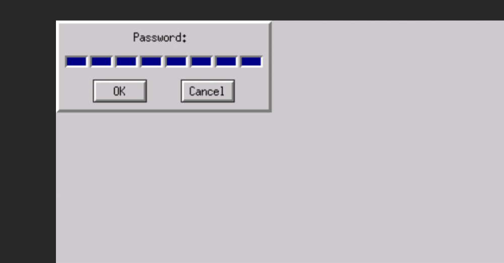

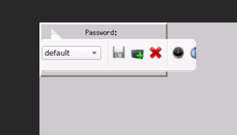

plus my 1 article  you can see the Luckybackup glitchy screen displays too asking for a password when it shouldnt need one.. and then    icons over top of ok cancel buttons
Then don't use it if you are not fine with it.

sorry my dislexia   i try my best to explain but for me it sounds fine...
never said i didnt wanna use the lucky backup i just saying there is a glitch u cant click  Ok and cancel    cuz the icons are sitting over top it...  u gotta click all around it to get it to work

the private key is    tower   the public key is tower.pub
i trying to test  Lucky backup   so i can  transfer   for testing
/mnt/user/documents/bell    folder    to   Mitchflix  folder    /mnt/user/dowonloads

then i did the remote and the private key

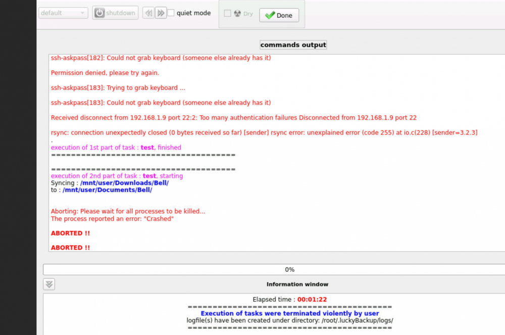

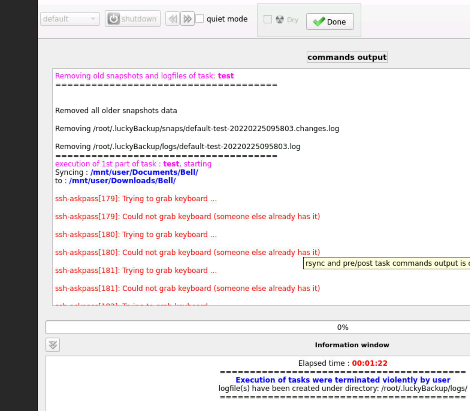

then i get the errors   you see which is very hard to click cancel and get to that Abort button
Or press Enter or ESC.
Then you have to copy over the private key file to the container and specify the private key there.

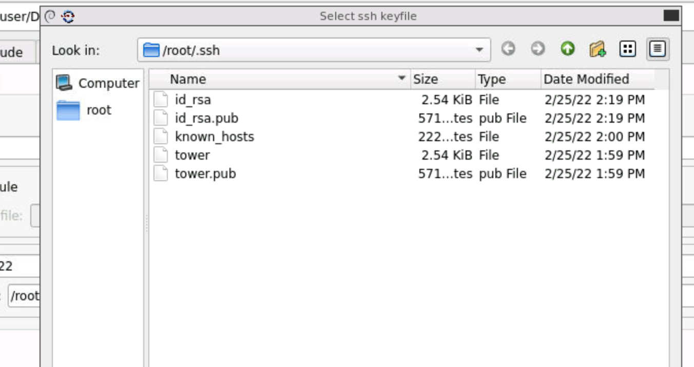

you above asked what  public key  and private key am i using
i used   tower.   as the private key.. and i use  tower.pub  as the public key

Enter file in which to save the key (/root/.ssh/id_rsa): /root/.ssh/tower
you need to leave  it and not type anything  just hit enter  to create   /root/.ssh/id_rsa
as you see when you create  tower and tower.pub  it causes problems

i ran the keygen  and i changed the name from id_rsa  as i want tower  as the name for the keys
then you see i copied to the 192.168.1.9
then i exited  restarted the Luckybackup
i then did what it said set up the directories.. then save and then  go back into it to modify it
and i add the remote private key as you see and then i excute it

reason i been getting frustrated i follow everything evne followed the guys video  at the bottom of the blog and it just doesnt let me do it without a password
u see all the errors i get
i guess you have to write it
cp /root/.ssh/tower_root /root/.ssh/id_rsa
i guess thats the only way to get it to work?
cuz each server needs its own name  for public private key not    all be id_rsa
or do you have to generate    the id_rsa  file  then rename both  id_rsa  id_rsa.pub to tower and tower.pub

root@MitchFlix:~/.ssh#
and it still asks me for password and i get what you seen in the past pics
i added
root@MitchFlix:/# chmod 700 /root/.ssh
root@MitchFlix:/# chmod 640 /root/.ssh/authorized_keys
and it still wont go past the password..
thats why i was requesting a feature again..

2 minutes ago, comet424 said:
so here i started over
i ran it all from the Lucky Backup Console   running Default
So you are basically saying you didn't read my above comment... :D
Where is the line where you did:
su $USER
Why did you again put it in /root and not in /luckybackup?
3 minutes ago, comet424 said:
i added
What did you add the corresponding key from the .pub file?
Have you restarted sshd on the foreign host, so to speak "MitchFlix" with the command form above?

so default  when i said was
 I Hit Enter on
i didnt type in  /root/.ssh/id_rsa
i not sure what you mean  /luckybackup
there is not such directory it this article
https://unraid.net/blog/unraid-server-backups-with-luckybackup
its  /root/.ssh
 and i never did su $USER
i mentioned i dont even know what your talking about with that and what it does
i did run
/etc/rc.d/rc.sshd restart
but did no help
what does it exactly do  ?
Do you run it as root?
Restart the sshd service.

yes i run it as root but thats not what i said.. as default
default is   = /root/.ssh/id_rsa          <the file >
i said ia changed it   /root/.ssh/tower_root     <the file>    and thats when there is issues
i hoping a reboot will fix it..

update:
mitchflix (backupserver 1)   it didnt work still keeps asking for a password in luckybackup
gonna reboot the main Unraid Server... its been up for 30 days so hopefully its just glitched
So you run it with this in the template:
This is also working just fine.
Sorry but then something is misconfigured...
If I configure it like this:
even with a self generated key like in your case, copy over the public key to another Unraid server and start the sync I have no issues at all.

ya i did try renaming the id_rsa 2 files  to like tower.    and still didnt work
rebooted both servers  but still asking for password.. so what i gonna do must be a conflict
i gonna delete the /root/.ssh  folders on all the servers..
gonna delete the /flash/config/ssh   folders too   and then do a reboot...   this way it should boot up with 0 conflict and i can start fresh.. i really dont know why i have so much problems the systems logs never say anything
so i can do that change the updates what i was always doing is updating  onec a night or once a week but they all did it all the same time.. but i could  do it... i know i have rsyncs that are supposed to run every 30 days  and delete any files that have changed ...  i really dont know if that feature i wrote works lol
so what does the wireguard do the openvpn cant do...   it took me forever  to learn openvpn and the pfsense.. i wish i had learned it  when it first came out or even the opnsense....  back in 90s  it was  Wingate or Sygate and that was a headache enough to share internet and be your router...
so gonna do a reboot after i delete all the folders and then re run the keygen  hoping it will work.. cuz  its getting frustrating  i follow it.. but wish unraid would say   this file is conflicing with this program and may cause it to not work..
we not at Star Trek erra yet lol...
but i defently do that put  the backup servers to do it
is it ok to also do    Main Server  to run the backup  but the backup server is sleeping.. power it up    run luckybackup and then power the backup server off...    i not sure how to do that
ok its working finally
so after
doing
rm -r /root/.ssh
rm -r /boot/config/ssh
on both servers
and on main server luckybackup console
rm -r /root/.ssh
i then rebooted the 2 servers for testing purposes 2 times  repeating the above just to make sure

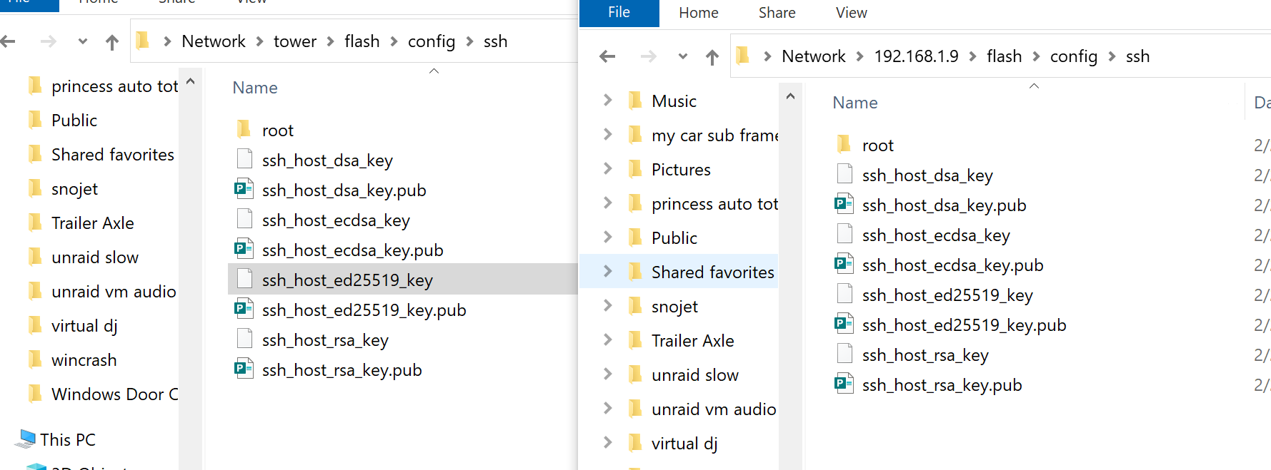

the folder ssh  got recreated.. on both servers with the same files  are they important?
i recreated tower.pub  that worked for the first time now..

but these files in the ssh folder on the flash what are they   i didnt have them before but now i do...   but least the luckybackup working so i practicing the file copy...  the gui is less headache then command line
Yes, they are needed for SSH, please leave them where they are, luckyBackup also creates these files in the container itself.

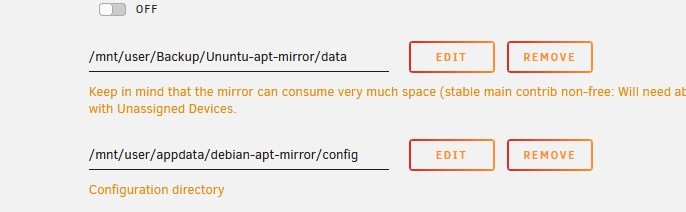

On 2/24/2022 at 2:32 PM, TexasUnraid said:
Trying to setup your Debian-APT-Mirror docker but having an odd issue.
---Checking if UID: 99 matches user---
usermod: no changes
---Checking if GID: 100 matches user---
usermod: no changes
---Adding user: debian to www-data---
The user `debian' is already a member of `www-data'.
---Setting umask to 0000---
---Starting cron---
---Starting apache2---
---Starting...---
---Something went horribly wrong, can't find the mirror directory!---
I have checked things over and over, I have the folder mapped to valid paths, if I manually create files in these folders, either inside the docker or on the server side, it is visible and editable from both ends.
I also manually created the mirror dir under the data folder but didn't help. It is like it is using another folder tree entirely.
I manually started apt-mirror and it ran but started filling up my docker image but I could not figure out where the files were going. It is using all default settings in the mirror.list file for now. The download itself seemed to be working fine.
