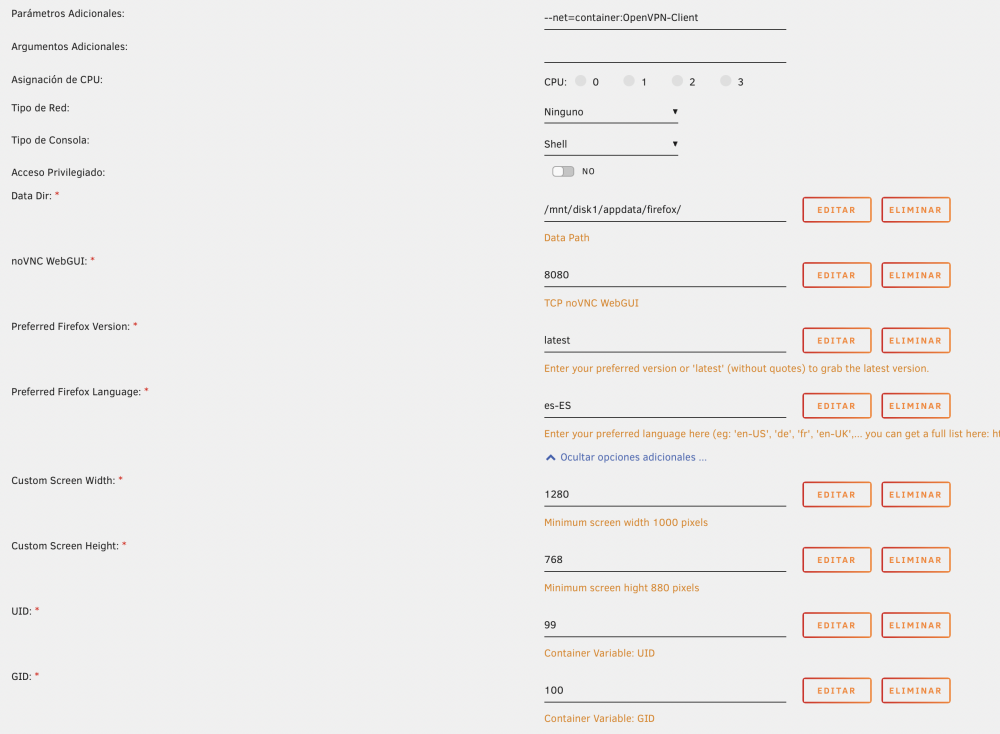

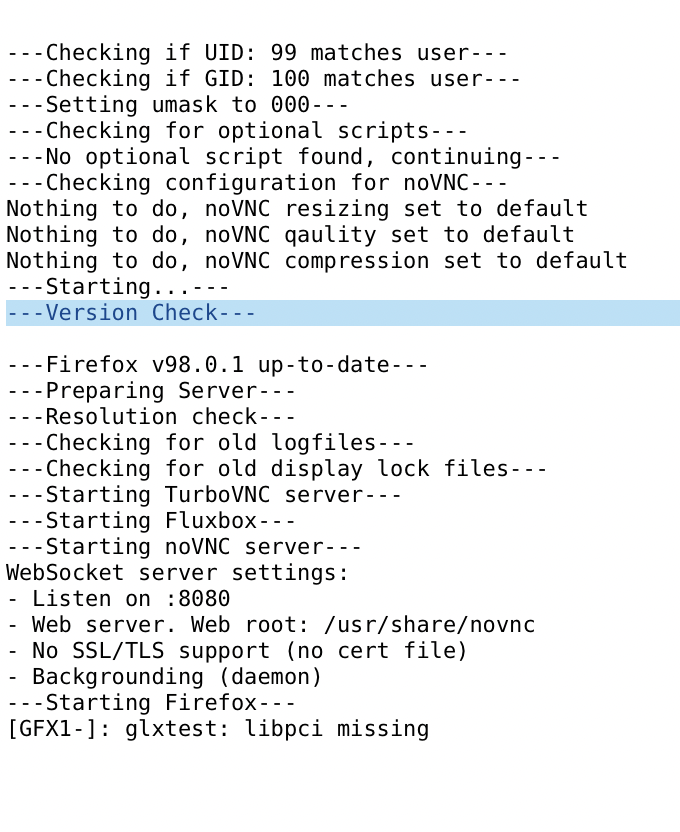

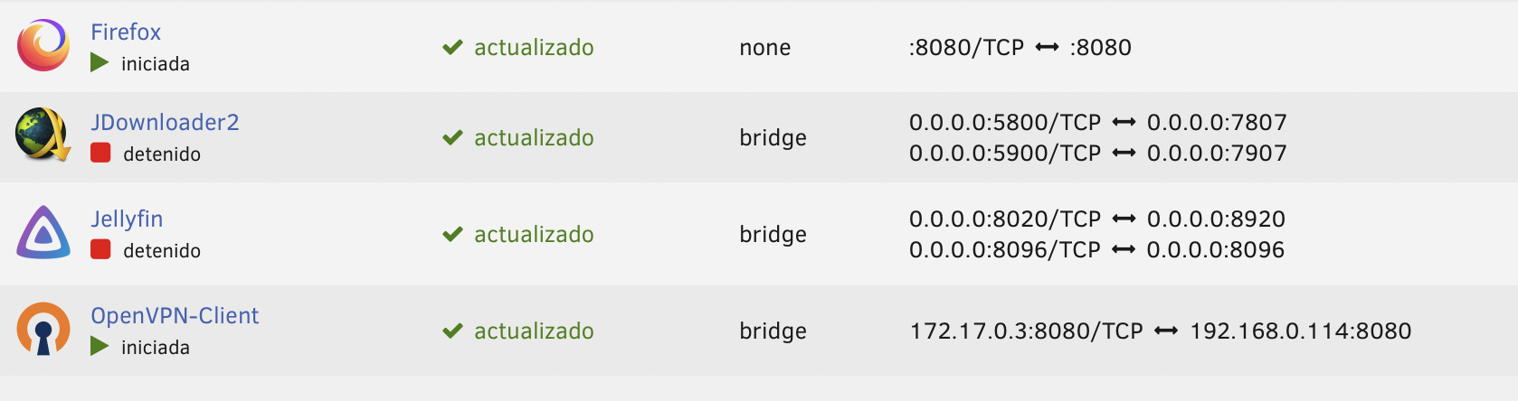

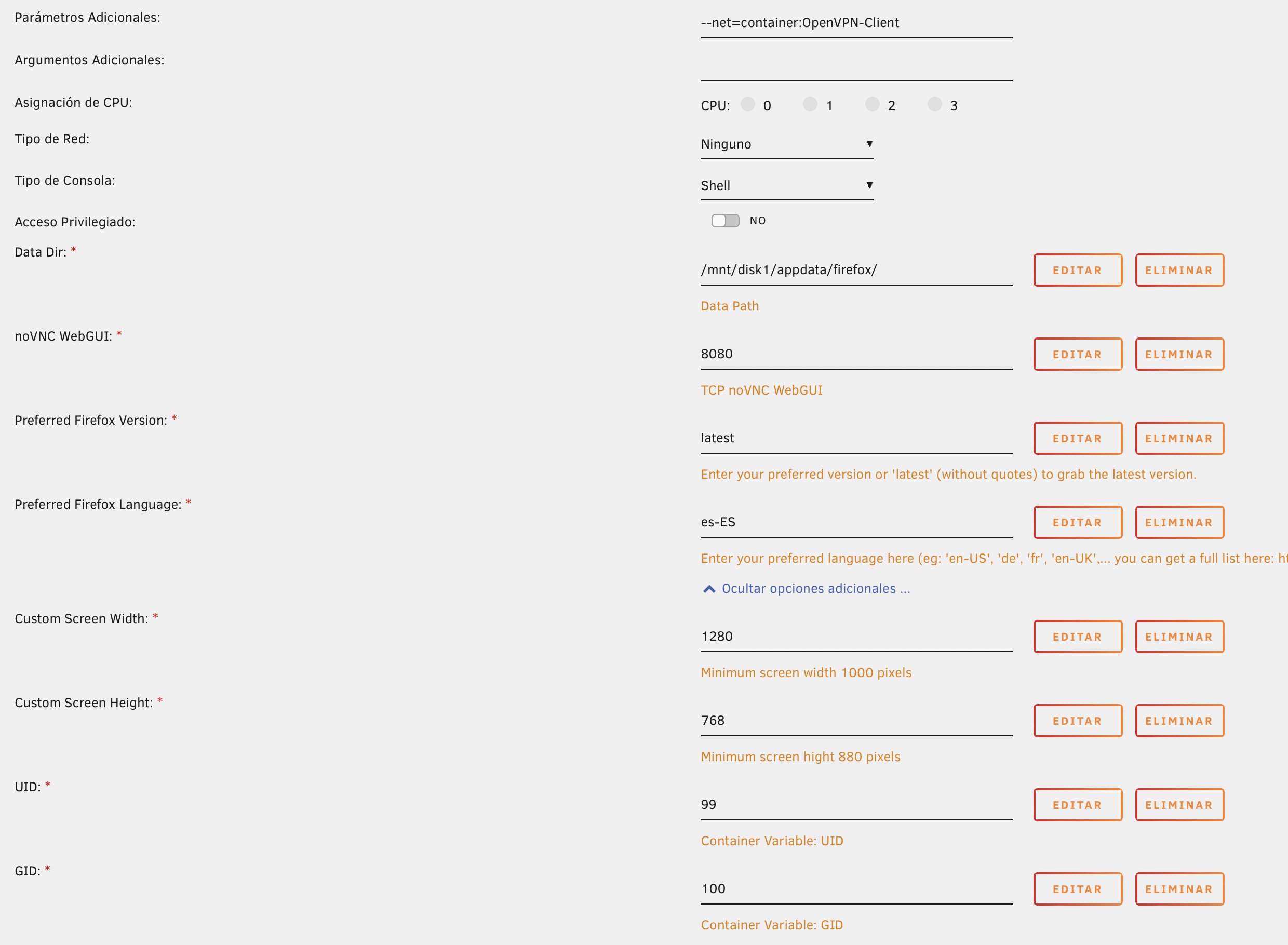

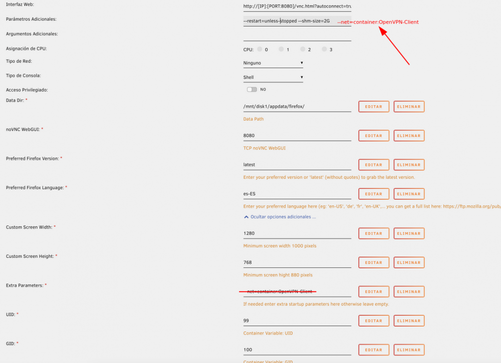

Hello,
I have installed Firefox and OpenVPN-Client and both separately work fine for me, but when I try to get Firefox out through the VPN client, Firefox doesn't have the WebUi. In the Firefox docker I set the network to "no" and add the variable "--net=container:OpenVPN-Client" and assign the Firefox port to the VPN client. I restart both containers and Firefox still has no WebUi. I do not know what I'm doing wrong. You can help?
Can you provide a few screenshots from the container what you've did so far, maybe I can see where the issue is.
Do you routed a second container through the OpenVPN-Client container that uses a noVNC web interface?
Edited by T0rrelles

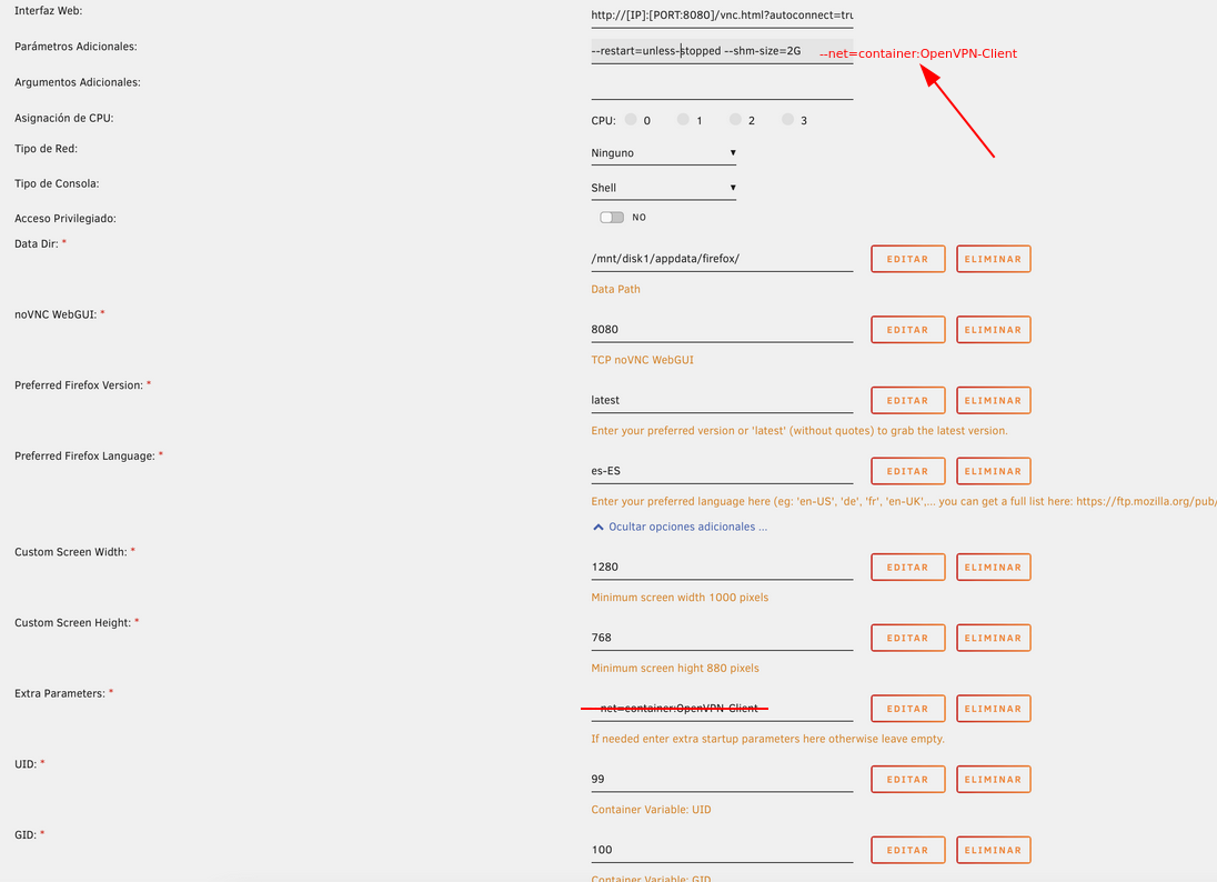

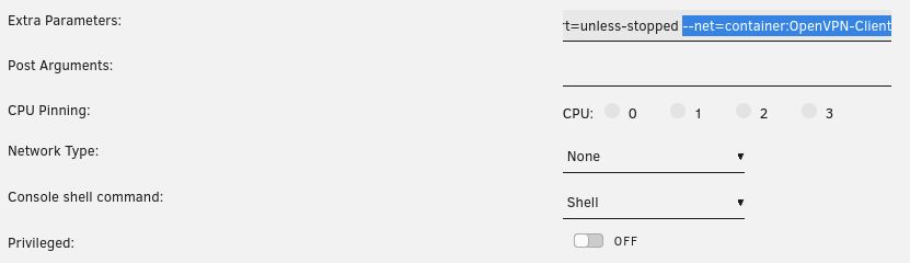

6 minutes ago, T0rrelles said:
You have to put "--net=container:OpenVPN-Client" in the extra parameters for the container not the application like this (in your case at "Parámetros Adicionales":

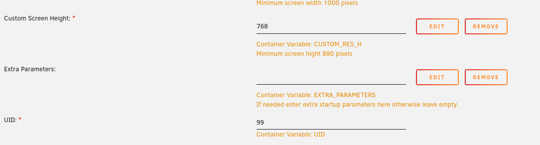

Why are the Extra Parameters in your Docker template under the advanced section marked as required? Should look like this:
To the docker OpenVpn-Client?
Edited by T0rrelles
Just now, T0rrelles said:
To the OpenVpn-Client container?
No, in your Firefox container like:
OK. Now I try.

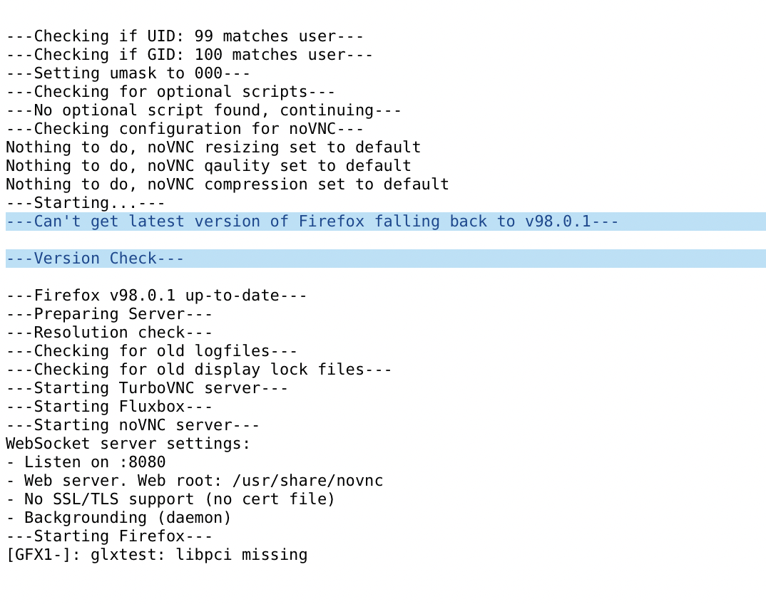

The same thing happens, it doesn't show me the WebUI
Edited by T0rrelles

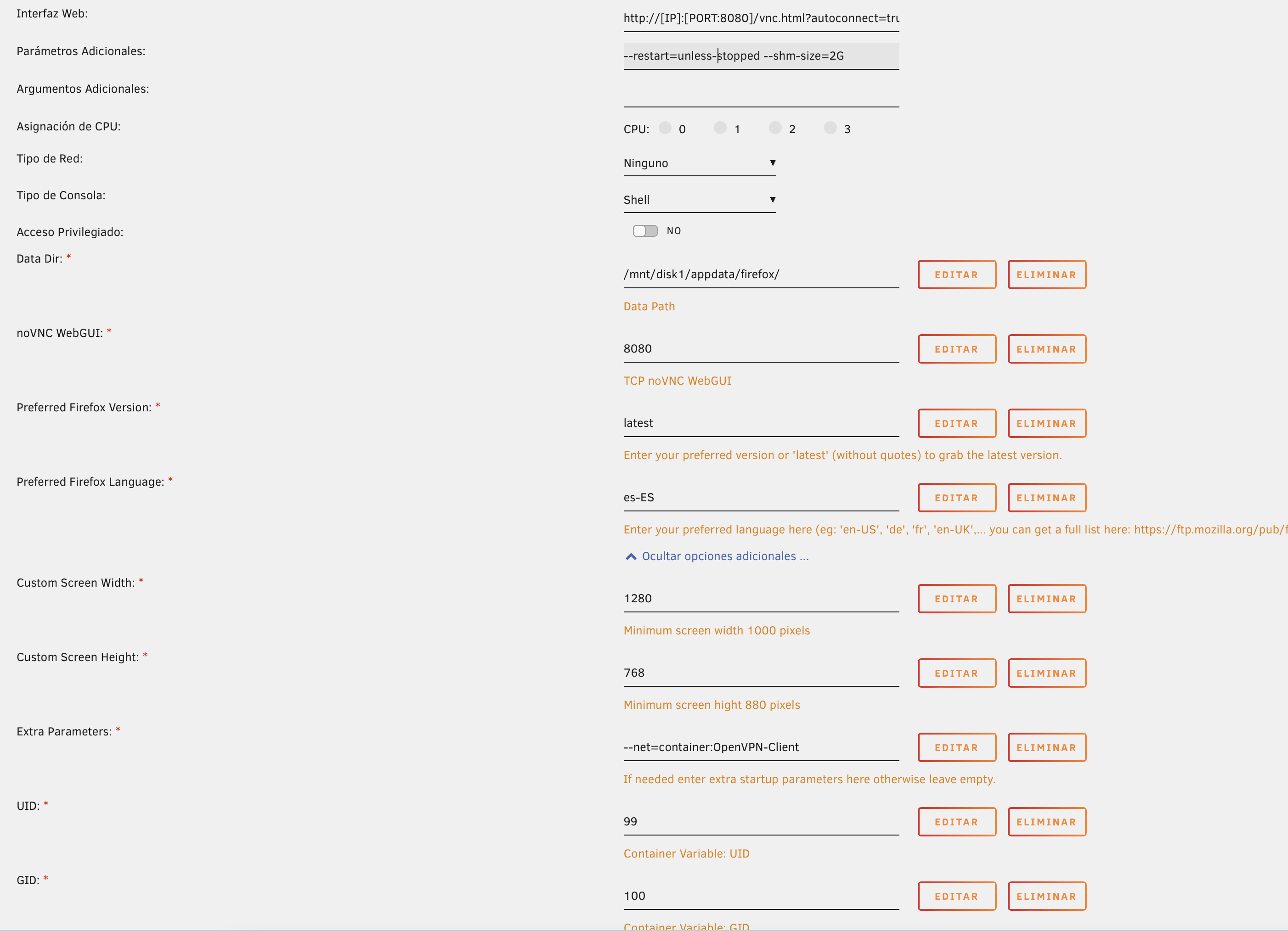

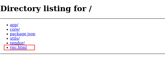

Yes, because you have to manually type it in your address line, simply type in the address from your server and the port that you've created for Firefox in the OpenVPN-Client container.
Where, I don't have WebUI?
In your web browser like:
The above IP and PORT is only a example, you have to change the IP to the IP from your server and also the port so that it reflects your mappings, you then simply click on vnc.html and then you are in the Firefox container:
You have to understand that the Firefox container has no own network anymore because you've set it to None and use the OpenVPN-Client container but that's fine and how you want it.
Thank you very much. Yes, from the laptop I can enter the Firefox docker and once in it I can use VNC.
I tried to start the docker from the WebUI of the server, as I did before trying to pass Firefox through the OpenVPN-Client, but it seems that it is not possible. Thank you very much again.
I still have a lot to learn about managing dockers 🙂

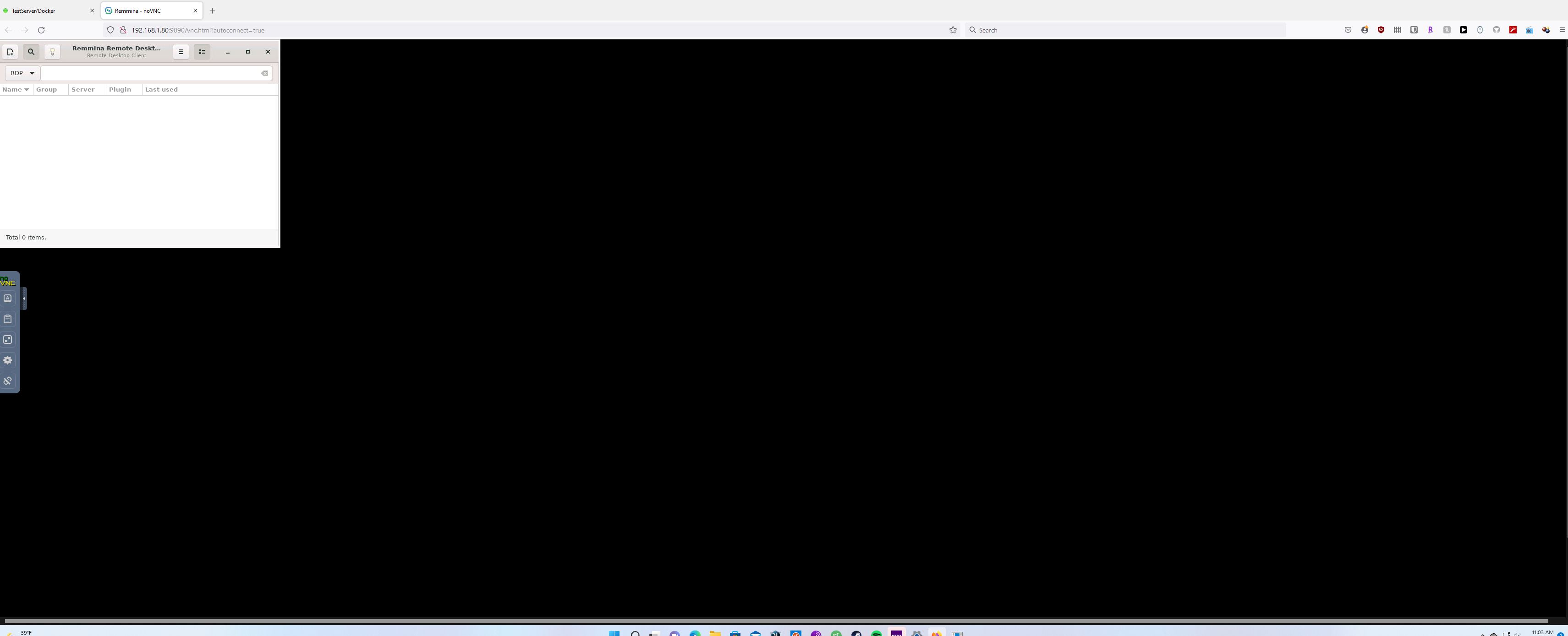

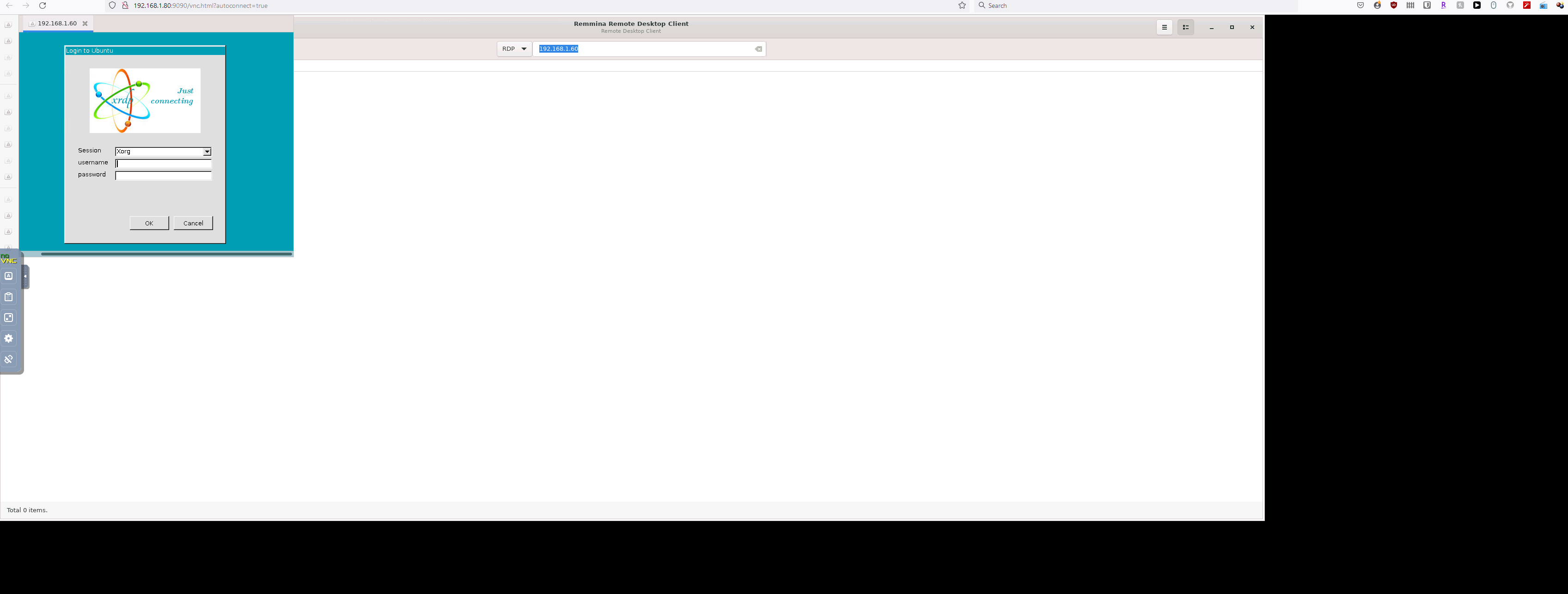

Hello - I am trying to use Remmina and have set the resolution to my default monitor which is 3440x1440.  When I run Remmina in the web brower, its a very small window, maybe 500x500 or so and doesnt nearly capture the width of the VM.  Is there a way to adjust this?  Otherwise I correct very easily to my VMs.  Thanks in advance.
Do I understand that correct that the VMs are full screen?
I will look into that.
Do you mean some kind of scaling so that the font is bigger or do you mean simply that the main window is fullscreen?

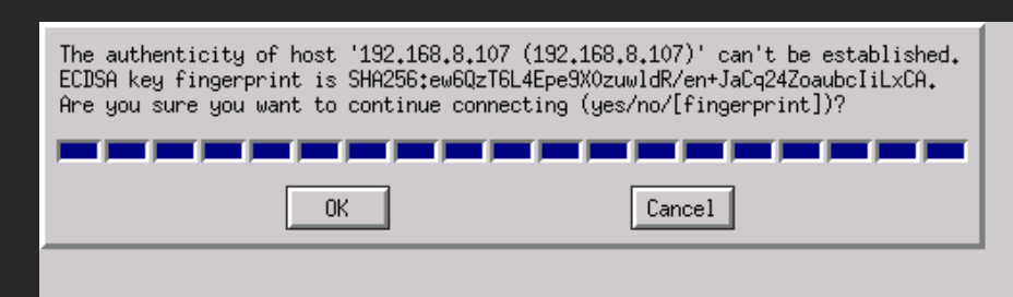

Hello,
I'm trying to setup luckybackup and i followed the guide but when i try to start a task i get this:
556746362_2022-03-2012_07_52-luckyBackup-noVNCMozillaFirefox.png.40a5b93569e483d3ad4339b5c8b70248.png
When i try to connect from the cli of the docker it did ask to confirm the first time, as usual for ssh, but then it goes no problem without asking.
If i try to launch the same command that the gui uses (you can check it on the validate button) it works without asking for the authenticity of host.
I already tried to remove the docker and remove all files in the /luckbackup folder but the problem persists.
Obviously pressing OK on this box does nothing, it asks again 2/3 times and then fails
Do you run the container as root?
Which keys are you using in the container and which one did you copy over (maybe send a screenshot)?
What do you mean by "which keys"? I did copy the public one and if i use the cli and "ssh root@IP" it doesnt ask for password so it is working and reading the key. I copied and added the correct key to the destination box authorized_keys
I did try to run it both in normal and as root user

Just now, exico said:
No idea of what was creating the problem
Keep in mind to always use the keys that are located in the /luckybackup directory and not the ones from the /root directory in the container regardless of running it as root or not.
Sorry, let me post a pic.  If you see in the pic, the VM in the browser is very small and no matter what I do I cannot make it bigger.  I tried to set it in the docker settings in unraid but it won't go bigger than the small window you see in the pic.  I also cannot stretch it via mouse, nor do any of the buttons related to the app make it larger.  Thanks for your help.390455963_Screenshot2022-03-20110330.thumb.png.13c15598391959e1353599490d6fb575.png
Edited by Vaslo
Added a second picture as I can extend remmina but not the VM window
