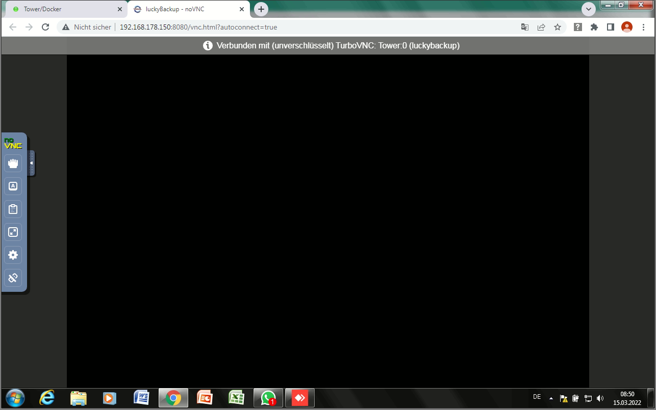

 How can i revive the GUI when i accidently clicked on minimize ?
What container?
Usually restart the container.
4 minutes ago, ich777 said:
What container?
lucky backup container. most of the time container restart works, but yesterday it didn't .. even after full unraid reboot. it startet flawless, but the gui was just black/blank. somehow, without any changes, this morning the gui of lucky backup appeared. two different devices were used to access the web gui, so no client issue.
Next time i will copy the log
Edited by Grobalt

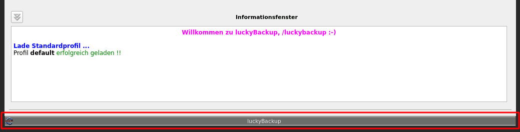

I will update the container in the next few days so that the taskbar will be displayed and you can bring up the GUI again if you minimized it.
Yes please. Maybe something else is preventing the GUI from coming up.
27 minutes ago, Grobalt said:
so no client issue.
Updated the container already, please update the container to apply the update.

yes, i updated.
i tried with incognito mode in chrome -> no change. deleted cache, pictures etc -> no change
I can't reproduce this on my Server and my Test Server.

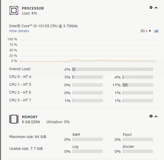

Can you try to start over? How much CPU and RAM does the container use currently?

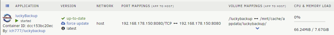

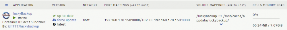

before starting the docker container (dont wonder, fresh installed last week)

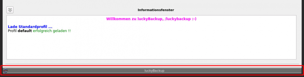

I really can't tell what's wrong on your system, I also don't see the task bar in the screenshot that you've posted above, at least it should show up:
Can you try to remove the container, remove the folder for luckybackup from your appdata directory and pull a fresh copy from the CA App.
Is your appdata share set to Use Cache "Only" or "Prefer", you can find this in the Share settings.
The usage looks completely normal:

2 days later. It seems the issue was the following. Somewhen during the luckybackup work the GUI was minimized. Then with the VNC settings was tested with scaling, the scroll bar disappeared. The old laptop where i have remote access to access the unraid server has 1200x800 resolution. Now with the wrong scaling applied it was even after updating no task bar visible to bring the application to forground. Most likely everyhing was running flawless, just "off" screen and minimized.
