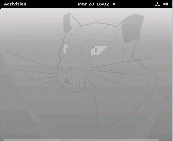

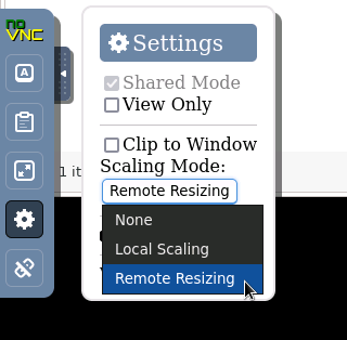

I would be really surprised if you limited it to that size - that's kind of small right? 500x500 for an Ubuntu desktop RDP?  The first picture is the interface for the app, which can be stretched as needed.
However to your question, the second picture shows is me using RDP to get into the VNC for an Ubuntu VNC.  It is not fullscreening after I RDP into the Ubuntu VNC, which I cannot change from that original size of the box.  Attached is a snapshot of just how I see Ubuntu - it resizes the wall paper but cuts everything off at the top.  If I put the terminal in there, it's like maybe 30 characters per line.  I guess I could make the font super tiny, but then I guess it wouldn't fill the need I'm looking for.
Maybe I have the wrong idea of the use of this?  When I RDP from Windows into this Ubuntu VM using the Windows RDP, I can resize it to be at least the 800 by 600 (or bigger on this wide screen).  Is that not the purpose of this - I've never used any other tools except the Windows RDP tool so maybe I have the wrong idea, and apologize if I'm wasting your time.1722401990_Screenshot2022-03-20160610.png.280d3d0081d52878b3ed426b0fd083f8.png
No, I,ve talked only about the main window.
Please give me a bit, will look into this.
something semms wrong, maybe it‘s because of the resolution.

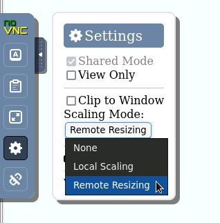

Container is now fixed, you have now multiple options of how scaling works.
First of all update the container, you don't have to set such a high resolution in the container template itself, simply leave it at 1280x1024 and start the container as usual, after that, click on the little arrow on the left side, click on the gear icon and at the drop down select Remote Resizing:
This will force noVNC to always resize it's size to the browser window size but please be aware that the resizing will work if you are connected to a RDP session but it will maybe not resize the RDP session window, this is dependent on the setting that you've set in Remmina itself and if the RDP server that you are connecting to supports this.
Hope this helps. ;)
Hope this helps. ;)

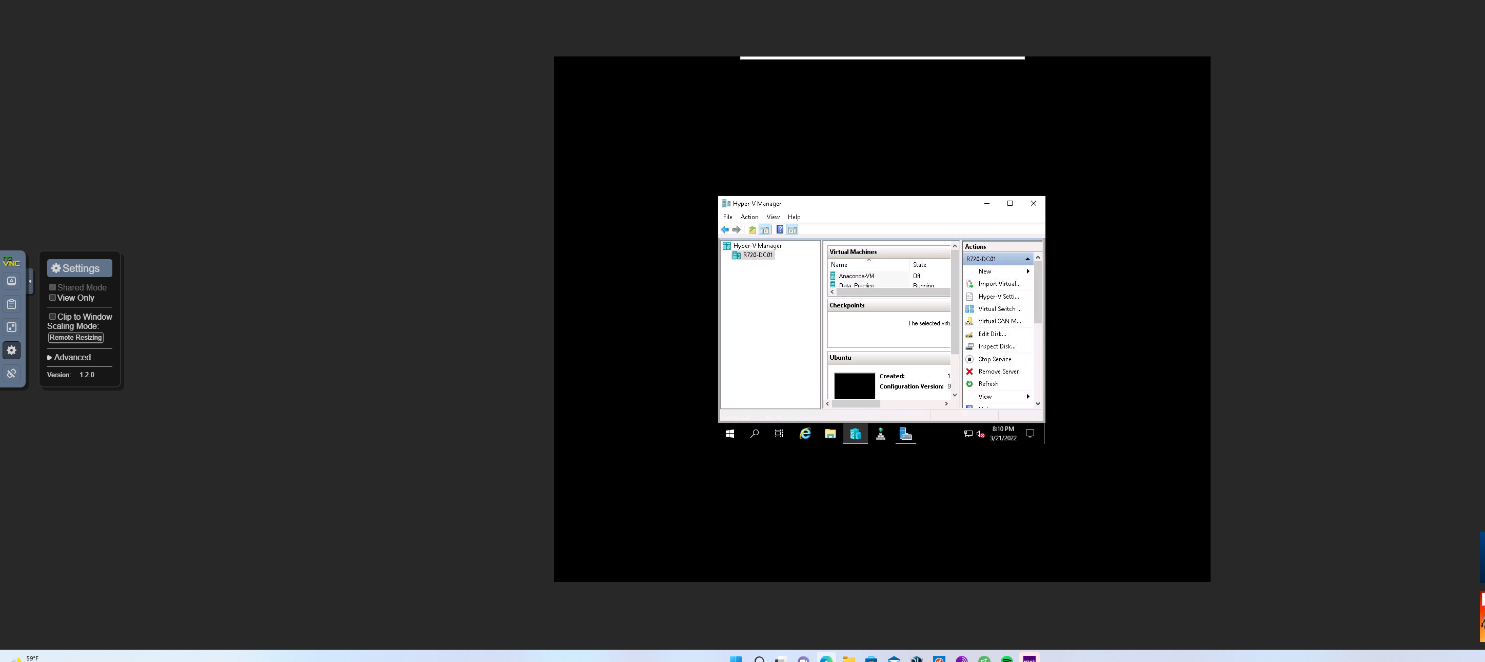

Thanks for doing this.  Unfortunately, it just continues to insist on the small window whether I use Local, remote, or none.  I reset the resolution per your instructions.  I don't know if its because XRDP is what I am using or what, but it's just not working on any of my pcs.  I also have a windows server that i RDP into from Windows without issue and the same problem there as you see in the attached.
Seems to work fine for others so I don't know, maybe an issue on my end.  I'll let some others get the help they need.  Thanks again for trying to help.
Edited by Vaslo
added Windows Server example as well
It seems that this is still the old version from the container?
The new version from the container has a task bar which the screenshot that you‘ve sent over doesn‘t have.
You also have to set the resolution in Remmina itself so that it reflects your resolution or set it to fit screen inside Remmina.

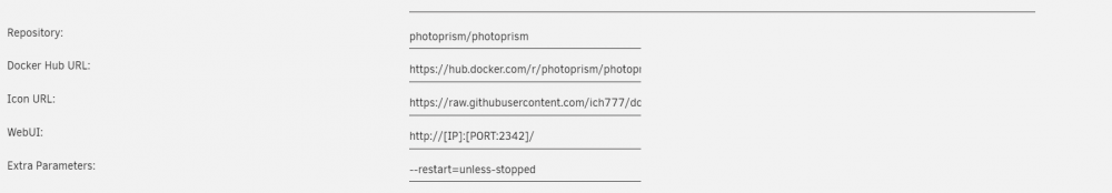

I followed the instructions from this reddit post and photoprism database guide but when I try to launch the photoprism webui it doesn't work. I'm not really sure what I did wrong or how to troubleshoot this, any help is appreciated!
Edit: per the photoprism LOGS
time="2022-03-22T10:38:54-04:00" level=fatal msg="Error 1045: Access denied for user 'photoprism'@'172.17.0.1' (using password: YES)"
How do I resolve this?
Edited by mag1c
Can you provide a bit more details? Maybe a screenshot from your Docker template, what IP does your MariaDB container have?
I would strongly recommend that you are using the variable with the name "MySQL Database Connection" and enter it something like that:
DBUSER:DBPASSWORD@tcp(DBIP:DBPORT)/photoprism?parseTime=true

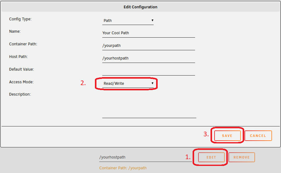

Hi All,
I recently learnt about PhotoPrism and I'm planning to try the Unraid docker for PhotoPrism. It seems that PhotoPrism supports a "read only" mode where it wouldn't modify anything in the original folders. Is there an easy way to enable this "read only" mode via the Unraid Docker? I tried skimming through the settings, but I couldn't find it. I think I can switch to the "advanced view" in the docker, and may be add the read-only flag to the "Extra Parameters" field (attached image). Would that work or did I miss the "read-only" option somewhere? Thanks in advance!
In the template at the path click:
  1. "Edit"
  2. At the drop down select "Read Only"
  3. "Save"
  4. "Apply"
  1. "Edit"
  3. "Save"
  4. "Apply"
@ich777, awesome, thanks for the quick reply!

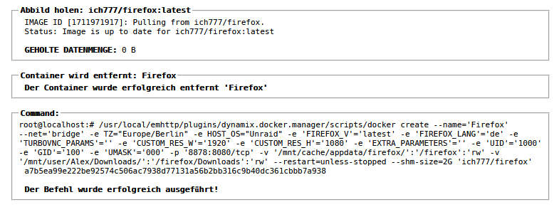

Today when I tryed to start the Firefox docker I was unable to connect to it. It was working fine couple of days ago.
Checking the log file I see this in a lopp.
---Firefox v98.0.2 up-to-date---
---Preparing Server---
---Resolution check---
---Checking for old logfiles---
---Checking for old display lock files---
---Starting TurboVNC server---
---Starting Fluxbox---
---Starting noVNC server---
WebSocket server settings:
- Listen on :8080
- Web server. Web root: /usr/share/novnc
- No SSL/TLS support (no cert file)
- Backgrounding (daemon)
---Starting Firefox---
Unable to init server: Could not connect: Connection refused
Error: cannot open display: :99
Can you try to do a force update on the Docker page with Advanced View turned on.
I tried to install it and it works as expected.
Have you changed anything in the template?
@ich777 I have changes in the template but this settings were running without problems couple of days ago.
I did as you asked. Not sure which information you are looking for.
That's what it looked like before the update:
The update:
The problem still persists.
Note: I have the access password protected as you have described it in the pinned reply on the first page of this thread.
Edited by Pete0
Why is the UID 1000 and not 99?
This was set by me. In that case I might have misunderstood what I was setting there.
I have set it to 1000 because this is the user ID for my user in unraid. I got it from /etc/passwd.
And I have set it to 1000 because I thought this would write the downloaded files with permissions to my user since the files are downloaded to my users share. Am I wrong here?
I changed the UID to 99 but this did not fix the problem.
