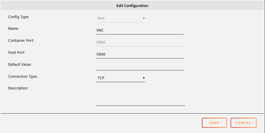

Is it possible to connect with a VNC client?
I've tried but without succeed.
Edited by Roukmoute
Sure thing, you have to create another port mapping in the container template so that you can connect directly like:
(5900 is the default port in the container you can take whatever host port you want as long as it is not already in use)

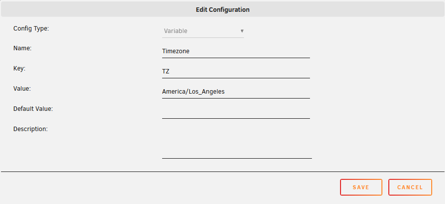

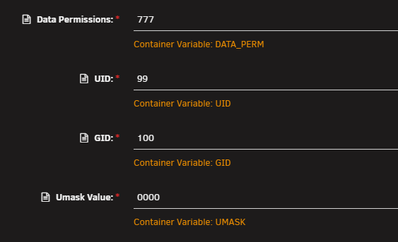

That's really strange, it should basically match the timezone from the host, to change it to PDT create a Variable like this:
(I don't know where you are exactly but America/Los_Angeles should do the job fine if you want to change it to PDT)

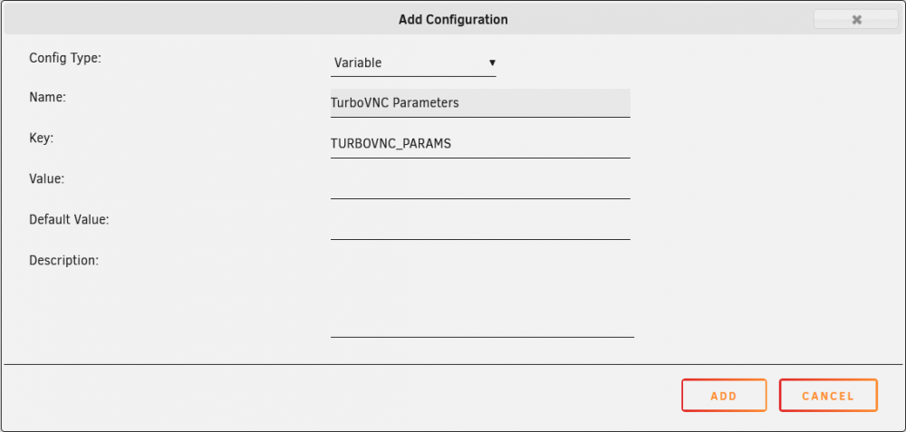

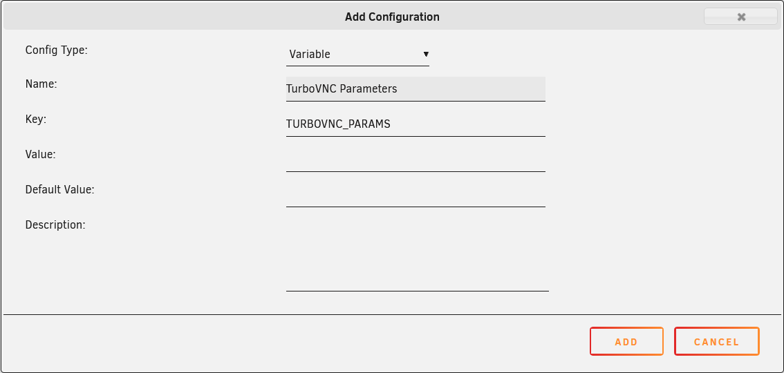

Things have changed a little bit since I'm switched to TurboVNC.
Please be sure to create the password first inside the container, to do that open up a terminal from the container (click on the container icon and on 'Console' then type in the following:
  1. su $USER
  2. vncpasswd
  3. ENTER YOUR PASSWORD TWO TIMES AND PRESS ENTER
After that close the terminal and edit the template and create a variable with the Key: 'TURBOVNC_PARAMS' and leave it empty like in this example:
Click on 'Apply' and connect again to the noVNC WebGUI, you should now be greeted with a password. :)
