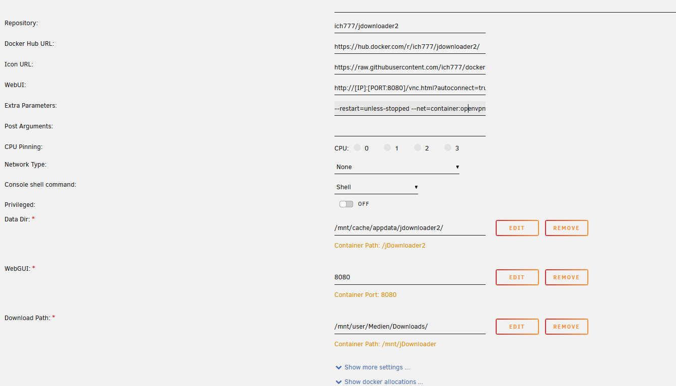

Problems with jDownloader,
Hei there, I am a huge fan of your jDownloader Docker, and I use it really often. The problem is, every once in a while, the docker stops on itself, the log files just say the same as if I stop it manually. I routet the jDownloader Docker through an OpenVPN Docker.
Also when I restart my server, the jDownloader Docker wont autostart, even though autostart is activatet. Also the extra parameters: --restart=unless-stopped or --restart=always do not work.
I already had the idea to use a user script that starts my jDownloader Docker and that runs hourly, but I do not know how to set this up (what needs to be writen in the script ;).
Would be nice if anyone could help or has a solution for my problem.
Thank you for your great work!!!
Eric
Do you maybe have other containers involved that maybe stop the jDownloader container?
What VPN container are you using?
Then it seems there is something else wrong…
Never experienced anything like that…
restart=unless-stopped will always restart the container as long as nothing else is stopping the container (keep in mind this is something that Docker itself watches and even if that option isnt working something must be really wrong.
Not that I know, there shouldnt be any other dockers involved.
I am using the openvpn-client from Muwahhidun. I have the issue since I first routet it through my vpn. When I dont use the --net=container:openvpn-client command, everything works fine.

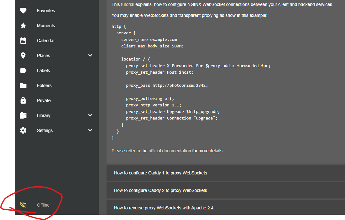

I've read, reread, implemented all the instructions and tutorials several times over and I just can't get rid of the <offline> status of my photoprism instance.  I am running Swag (formerly Let's Encrypt) and used the photoprism sudomain config file.  Everything is online and works fine except the websockets issue.  Can anybody help me out?  Thanks in advance!image.thumb.png.7f7f7167dd5640d03cfcb756356fcf53.png
Edited by GitBoxer
I would recommend to create a issue over on their Github here: Click

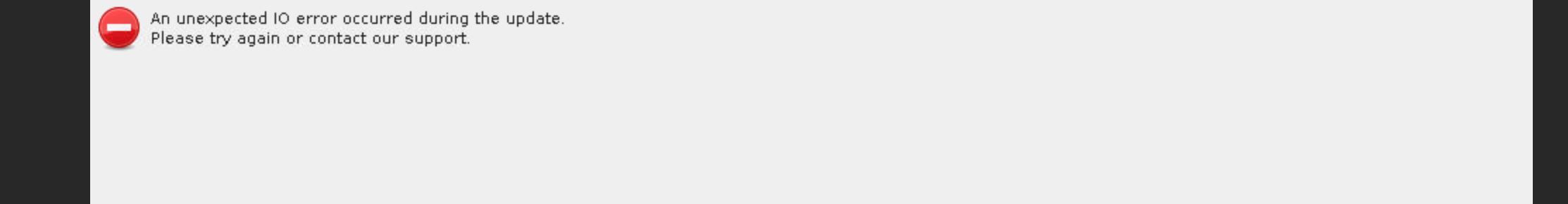

Currently running into issues with Jdownloader today.
Do the following:
  1. Stop the container
  2. Got to the jdownloader2 folder in your appdata directory
  3. Delete the files "jdownloader2.jar"
  4. Delete the file "core.jar"
  5. Delete the "folder" tmp
  6. Delete the "update" folder
  7. Start the container again
8 minutes ago, ich777 said:
Do the following:
Fixed my Problem, thank you. Small correction here, its "jdownloader.jar" and not "jdownloader2.jar".
But so far, thanks for your awesome Container and the quick reply.

50 minutes ago, PitRejection2359 said:
PhotoPrism - is there a way to add this preview build as an option in your container?
This is the official container, I've only made the template.
I think this is the issue that you've created on Github.
To change to the preview branch simply change the repository from "photoprism/photoprism" to "photoprism/photoprism:preview" (without double quotes):
