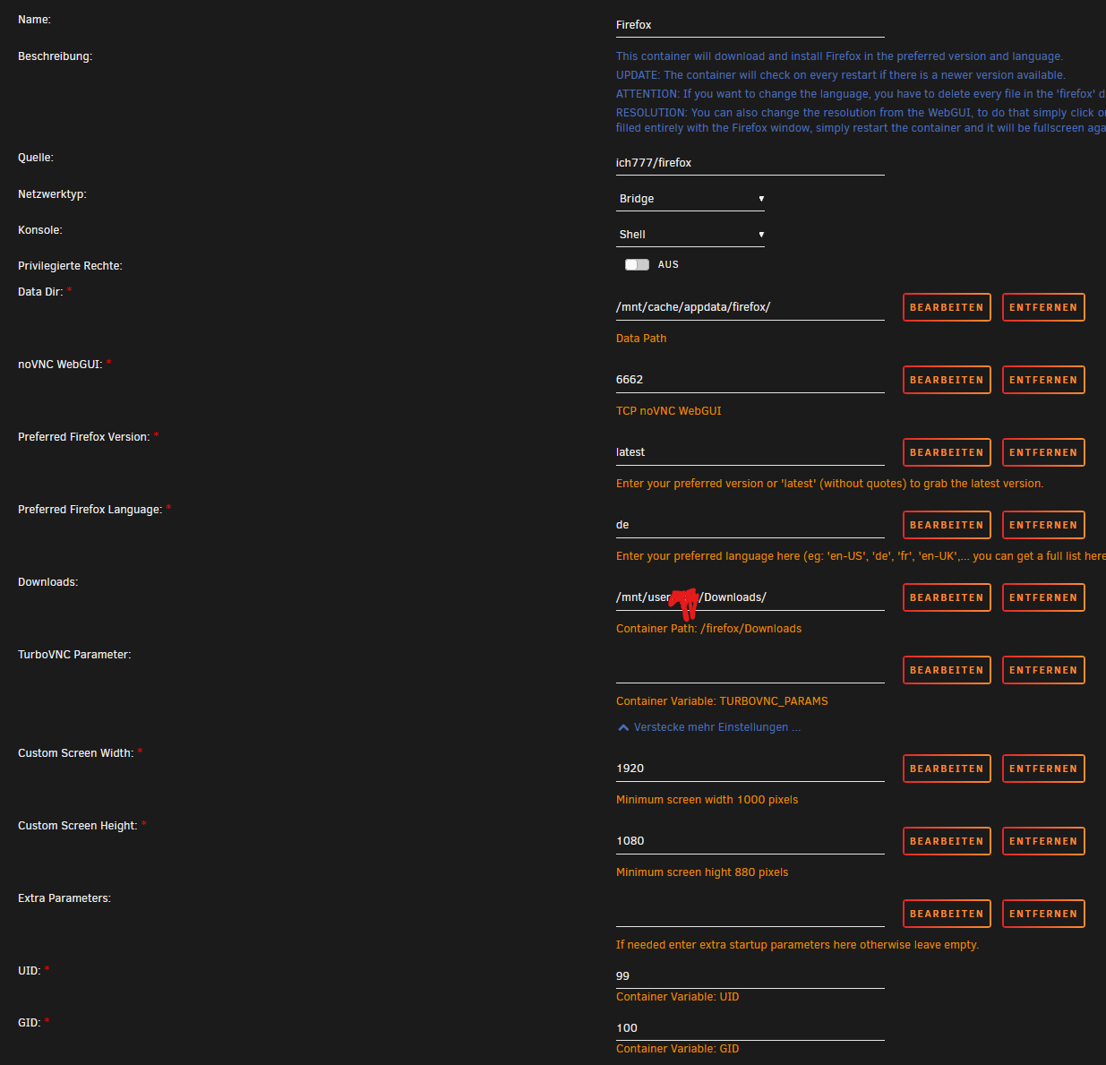

@ich777 some time ago I had this issue
Today I am having exact same problem but I think this time I did not mess up any configuration, see picture:
Or, at least I hope I did notwhing wrong. Last time I fixed it by removing and reinstalling the contianer. The suggestions you made last time did not help.
Not sure what is going wrong here. All I know is that I hadn't the container running for a couple of weeks but the contianer was updated multiple times meanwhile.
Edit: a fresh installation fixed it again but having to configure everything again sucks.
Did you maybe run a fix permissions on the appdata share itself or something similar?
Yes, those where mandatory and necessary updates to the base image and I now also push all my images to the GitHub container registry too.
Nothing has been changed so that it won't work anymore...
Your appdata share is set to use cache only or prefer IIRC.
That is correct.
No, haven't done that.
Since I had the problem last time I am pretty sure not to have messed with the container or it's configruation too much. Only thing that I see that is different from other working containers is that the appdata directory of firefox has permissions
drwxrwx---
while every other directory has
drwxrwxrwx
