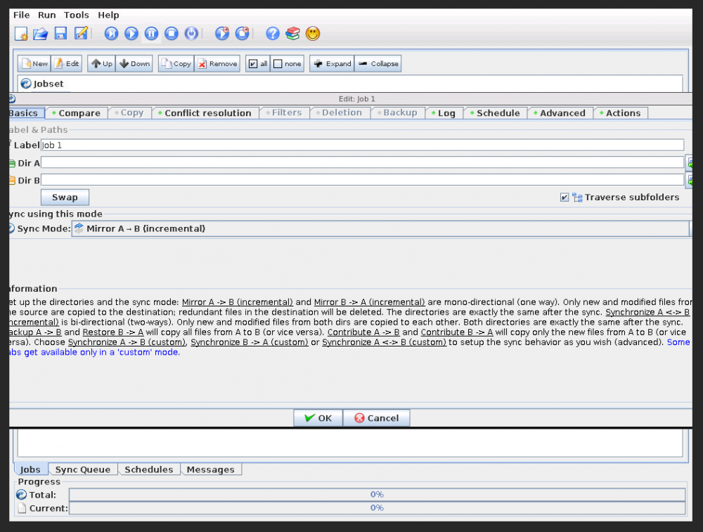

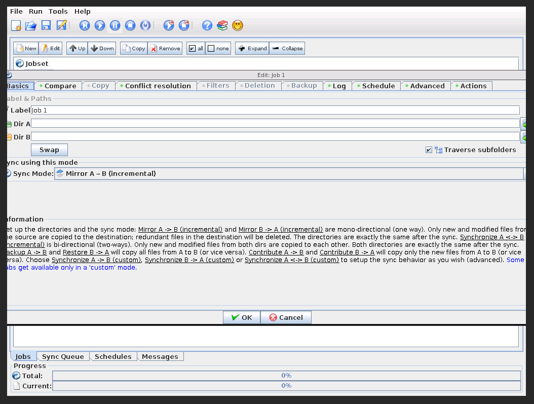

Is increasing the resolution in DirSyncPro possible?
Menus are going off the edges of the screen for me.
Sure thing, create a variable with the Key: CUSTOM_RES_W and the Value: 1280 to set the width and a second variable with the Key: CUSTOM_RES_H and the Value: 768 if you want to set the height in the Docker template.
But keep in mind this should be the only menu that is slightly "bigger" than the pre set screen size of 1024x768 and you should be able to reach all buttons and drop downs.

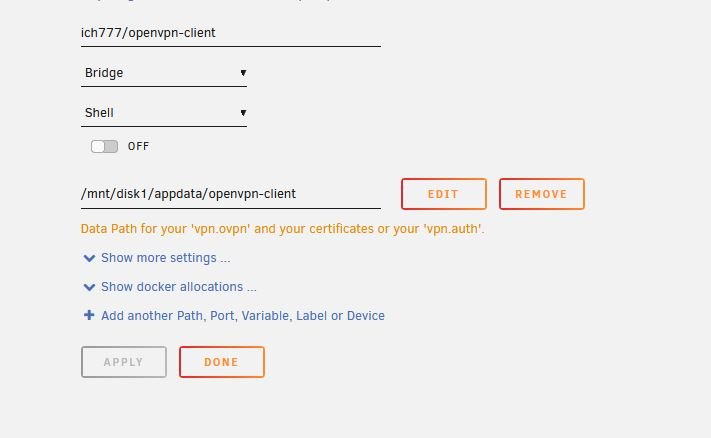

Hello,
I have been trying to connect unraid to PIA VPN for hours thanks to openVPN client but I am stuck.
First, I have downloaded a fresh openvpn config files from PIA
Then, I have downloaded the right container from apps : OpenVPN-Client by ich777
and I followed carrefully the steps :
- 1) Rename your *.ovpn to 'vpn.ovpn' and place it in your OpenVPN-Client directory : done (capture 1)
- 2) Create in the same directory a file named 'vpn.auth' and place your Username in the first line and the Password for the connection in the second line and save it : done
- 3) Restart the container open the logs and see if the connection to your VPN establishes successfully.

It looks like container doesn't find conf files at /mnt/disk1/appdata/openvpn-client:
cannot access '/vpn/*': No such file or directory
You can see in my previous capture that all the files are present in the directory.
I don't understand..
