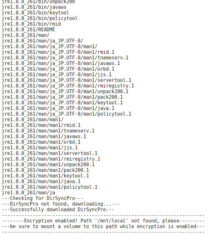

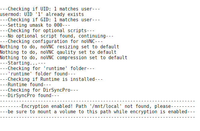

---检查 UID:1
是否与用户匹配---用户模式:UID "1" 已存在
---检查 GID:1 是否与用户匹配
------将掩码设置为
000------检查可选脚本
------找不到可选脚本,继续
------检查 noVNC 的配置---
无操作,noVNC 调整大小设置为默认值
"无操作",noVNC 质量设置为默认值
"无操作",noVNC 压缩设置为默认值
---启动...------检查找到"runtime"
文件夹------"runtime"文件夹
------检查是否安装了
Runtime------Runtime
found------检查
DirSyncPro------DirSyncPro 是否已启用

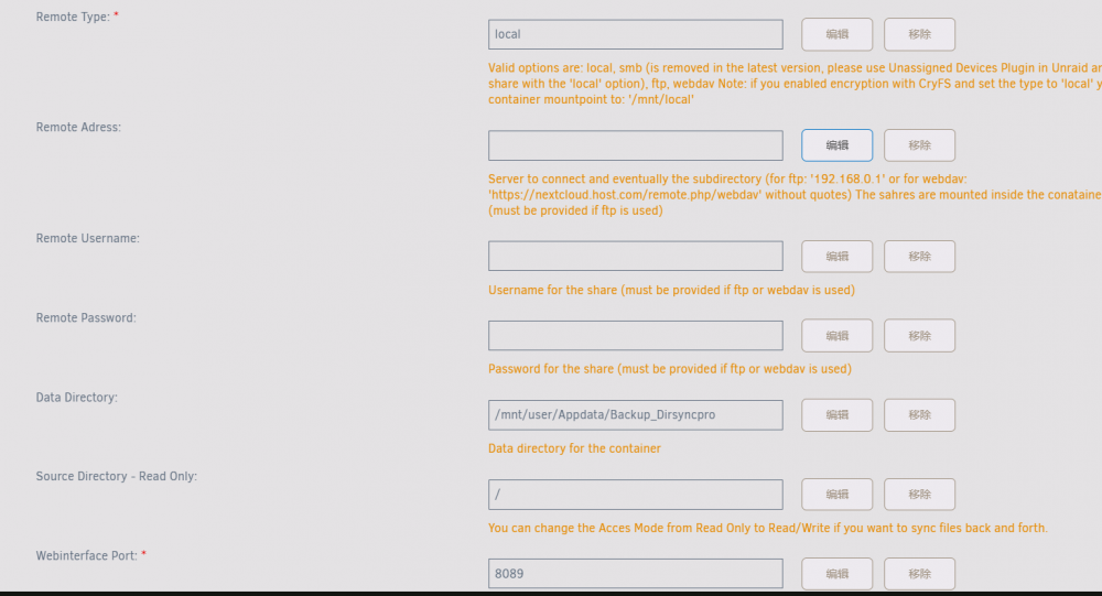

-----------------------------------------------------------------------------------启用加密!找不到路径"/mnt/local",请
------------请确保在启用加密时将卷装载到此路径---
问一下  是哪个目录需要挂载到"/mnt/local" 是备份原始目录?还是备份目的地目录?

5 minutes ago, ich777 said:
就是把哪个卷挂载到这个"/mnt/local",还有就是有在local模式下的配置详情吗,我就一直没弄明白在local模式下把哪一个卷挂载到/mnt/local
I think this should mean something like this:
Which volume is mounted to this "/mnt/local", and is there any configuration details in local mode? I have not figured out which volume to mount to /mnt/local in local mode.
@JavyLiu or @lyqalex I hope I translated that correctly?

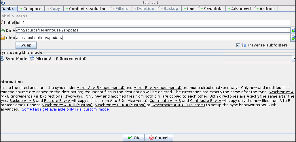

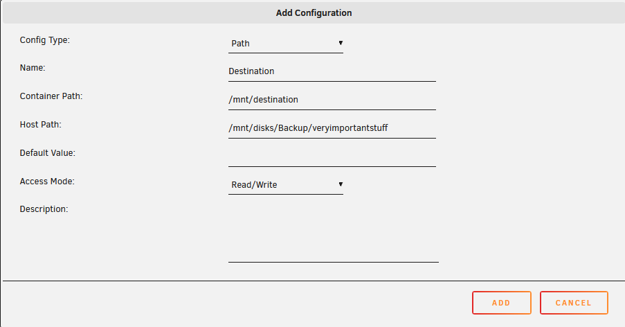

You can access your whole unRAID server from inside the container from /mnt/sourcefiles:
In local mode you have to add a dedicated path mapping to the container where you want to sync the files to because the Source Directory is Read Only.
Something like this should get you covered (in this example I mapped the path to a disk assigned in Unassigned Devices):
When you created it something like that you can add a synchronisation like:
This will synchronize the appdata folder from unRAID to the above set backup disk from Unassigned Devices.
Hope that helps.

2 hours ago, ich777 said:
我认为这应该意味着这样的事情:
@JavyLiu或@lyqalex我希望我翻译正确了吗?
您可以从 /mnt/sourcefiles 从容器内部访问整个 unRAID 服务器:
在本地模式下,必须将专用路径映射添加到要将文件同步到的容器,因为源目录是只读的。
像这样的东西应该可以让你覆盖(在这个例子中,我将路径映射到未分配设备中分配的磁盘):
当您创建它时,您可以添加同步,例如:
这会将 appdata 文件夹从 unRAID 同步到上述设置的备份磁盘(未分配设备)。
希望有所帮助。

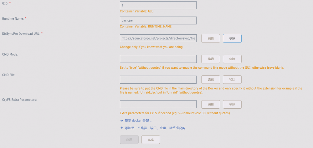

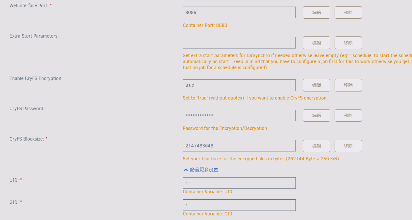

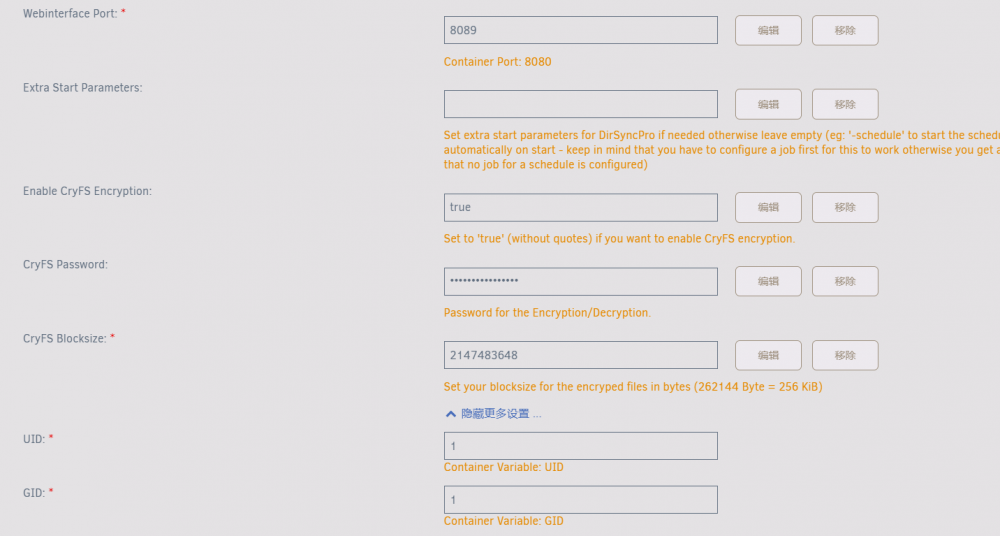

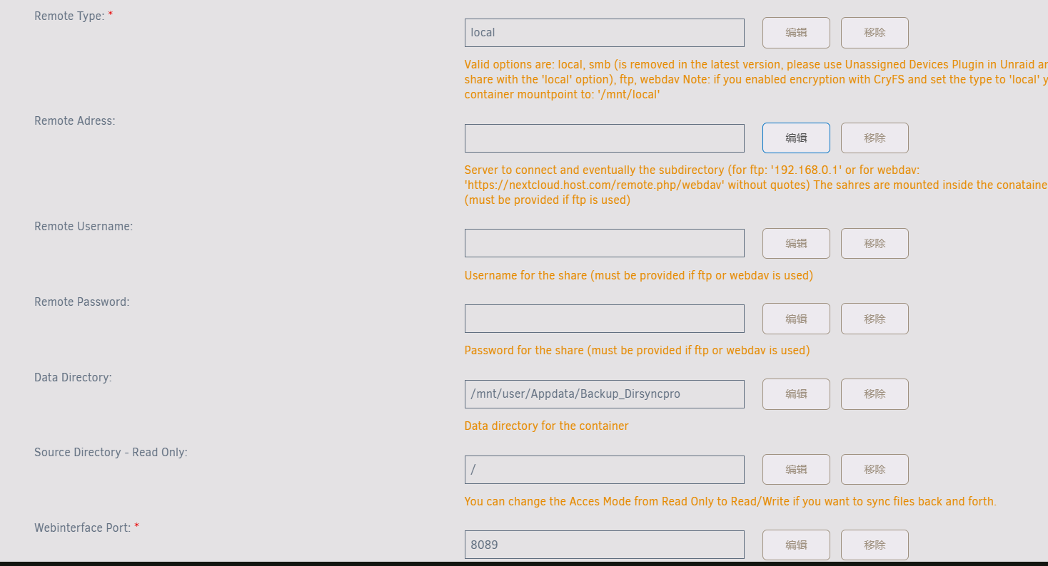

在本地模式下并且有加密需求的话,要求是需要挂载到/mnt/local,但是一直是报找不到/mnt/local,哪怕是重新添加容器后
Yes, your translation engine works really well! I shall apologize for his limited information. What he wants to know is in the container DirSyncPro , when Remote Type is set as "local", there should be a mountpoint to "/mnt/local", and he doesn't know what this is and where it should be. I think he may not read the info above the option. I'll help him with the problem in Chinese.
@NAS123 local 模式需要配合插件 “Unassigned Devices Plugin” 使用。你需要使用该插件挂载一个未被挂载进入阵列池的存储设备,然后在 DirSyncPro 的容器安装界面中,手动增加一个挂载的目录,将上述的存储设备的地址挂载到 “/mnt/local” 目录中。
另外,按照你的理解,这个挂载到 /mnt/local 的目录应该是用于备份的目的地目录。

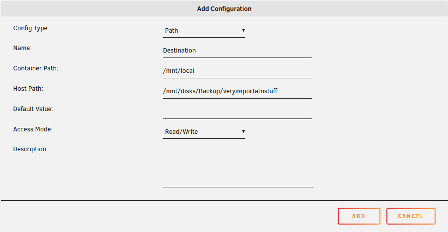

Oh, you have turned encryption through CryFS.
Then you have to create your local storage like this:

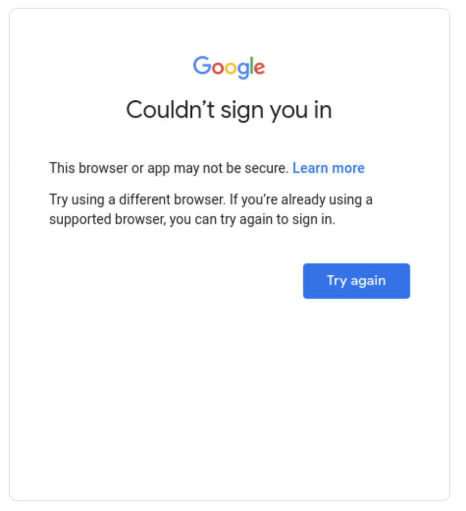

Ey ich777,
Thanks for developing this docker container, have been happily using it for the past few months.
However, recently hit an issue when trying to log into my google account through this container (see image below).
Anything on the docker end that we need to change? Or is this just google blocking linux browsers again?
Thanks
I think it's because the sandbox is disable because, well you don't need the sandbox in a Docker container because Docker is a sandbox and it is also using the test type flag, I think there is nothing I can do about this...
Have to investigate further but as said above I don't think I can do anything in this case... :/

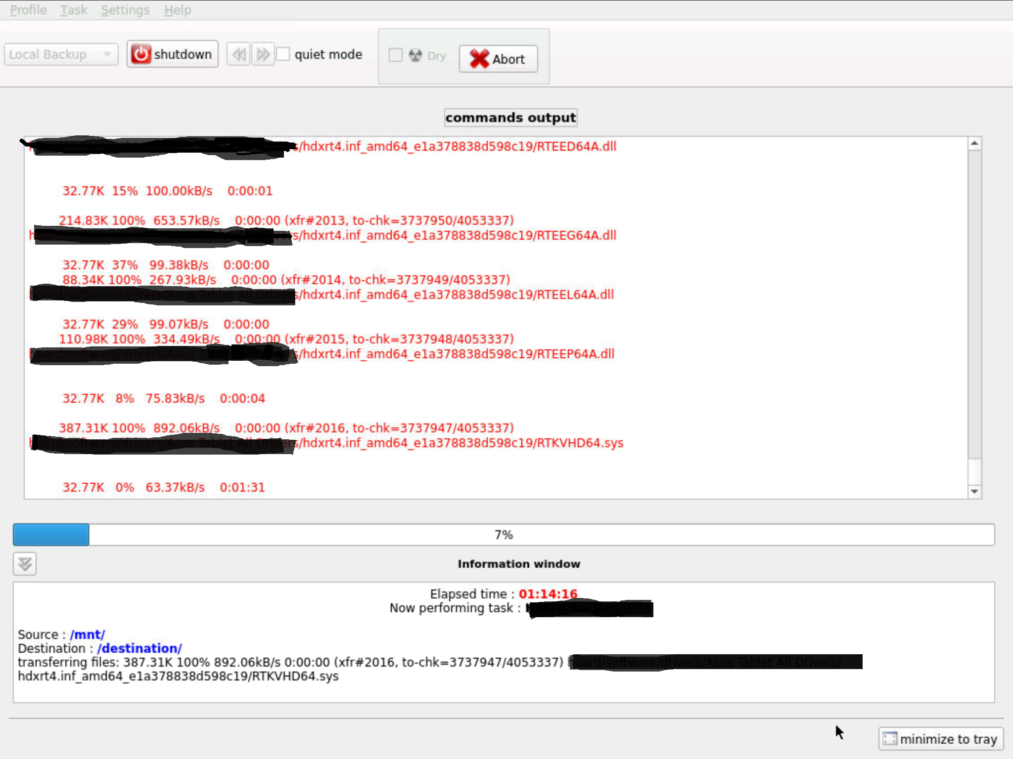

@ich777 What I dont quite get is why do i text in red when backing up, when I check the external drive, all files are fine can be opened without issue. I have external drive mounted as read write slave. So why red text which according to here http://luckybackup.sourceforge.net/manual.html#mainWindow means errors. So why display text in read is if there's an error, if there isn't an error? I have my /mnt as read only.
I hope this answers your question: Click
It is not strictly an error, it is more a "warning" or "alert".
Thank you.
but a warning or alert for what? I get nervous if I see read text for mission critical files.
Please read the last paragraph from the linked post:
In this example, the file was 1,238,099 bytes long in total, the average rate of transfer for the whole file was 146.38 kilobytes per second over the 8 seconds that it took to complete, it was the 5th transfer of a regular file during the current rsync session, and there are 169 more files for the receiver to check (to see if they are up-to-date or not) remaining out of the 396 total files in the file-list.
In an incremental recursion scan, rsync won’t know the total number of files in the file-list until it reaches the ends of the scan, but since it starts to transfer files during the scan, it will display a line with the text "ir-chk" (for incremental recursion check) instead of "to-chk" until the point that it knows the full size of the list, at which point it will switch to using "to-chk". Thus, seeing "ir-chk" lets you know that the total count of files in the file list is still going to increase (and each time it does, the count of files left to check will increase by the number of the files added to the list).
