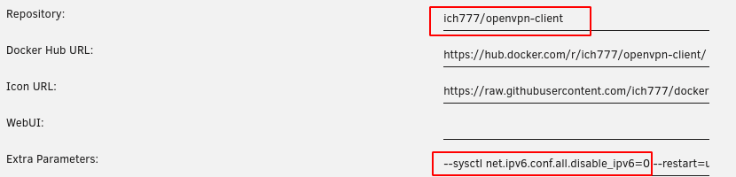

@062bel313 & @lovingHDTV I've now forked the OpenVPN container, rebased it to Debian Bullseye and pushed it to DockerHub.
You only have to switch the Repository from 'dperson/openvpn-client' to 'ich777/openvpn-client' and maybe add '--sysctl net.ipv6.conf.all.disable_ipv6=0' (without quotes) to the Extra Parameters (you have to turn on the 'Advanced View' to see the 'Extra Parameters') if you don't use/need IPv6 like in this screenshot:
