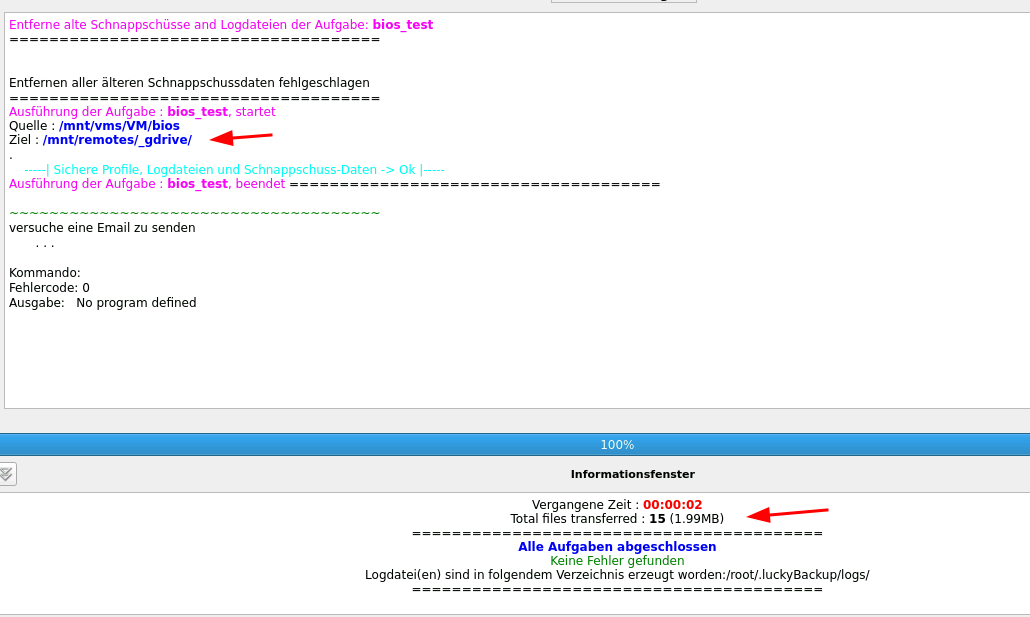

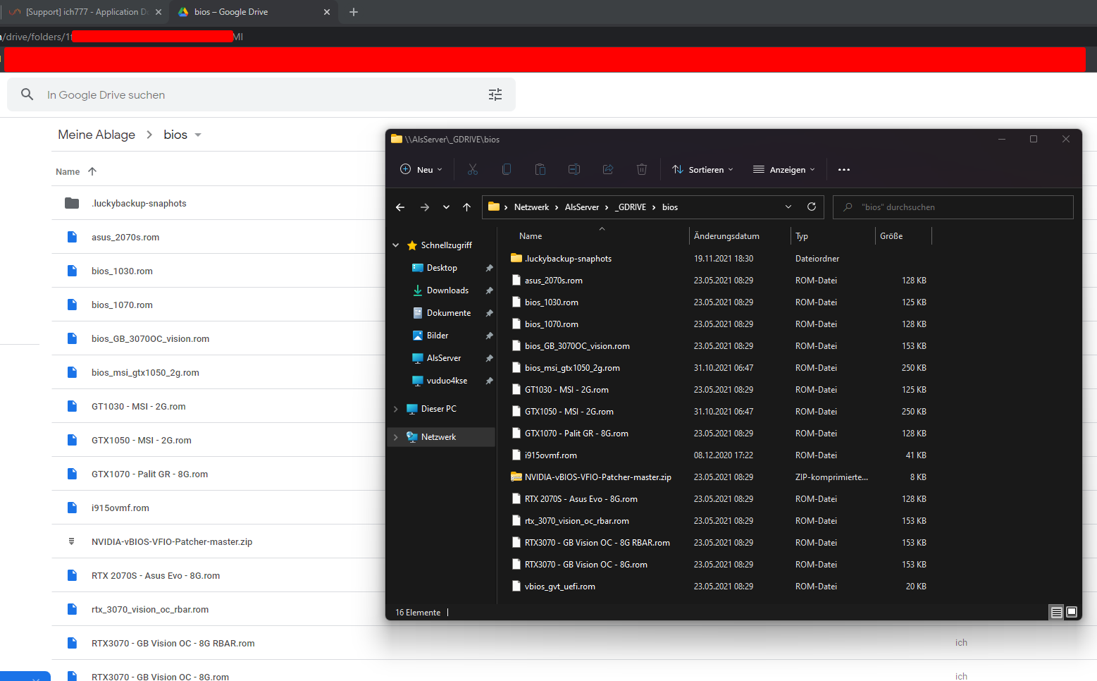

On 11/18/2021 at 11:30 AM, Goldmaster said:
this is what my rclone drives are set to, unless something there is causing the issue?
rclone mount --daemon --max-read-ahead 1024k --allow-other --vfs-cache-mode writes $remoteshare $mntpoint &
made a quick test now with gdrive and luckybackup
while gdrive is mounted in rclone mount, so looking ok now as small test
here a cross view, local mount and gdrive, all ok here

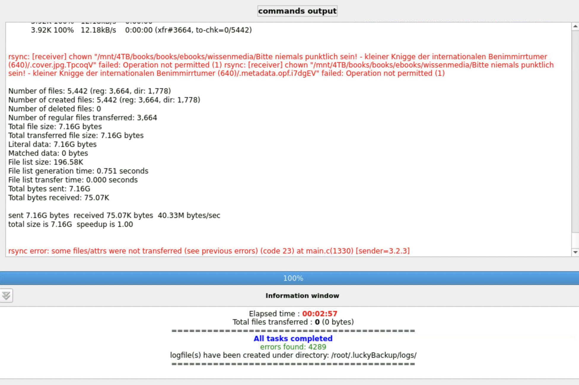

Hello,
I want to backup some shares to my external HDD.
The external HDD is formatted with exfat and mount with "Unassigned Devices".
It seems that luckyBackup is copying all files but I get many errors: Operation not permitted (1)
Do I have a wrong configuration?
Thanks in advance.
But the file gets transferred from what I see...?
This is a limitation of Windows file systems because they don't support all feature sets as a Linux filesystem.
Please go to the synchronization options and tick the boxes where it says that the Destination is on a NTFS or FAT filesystem.

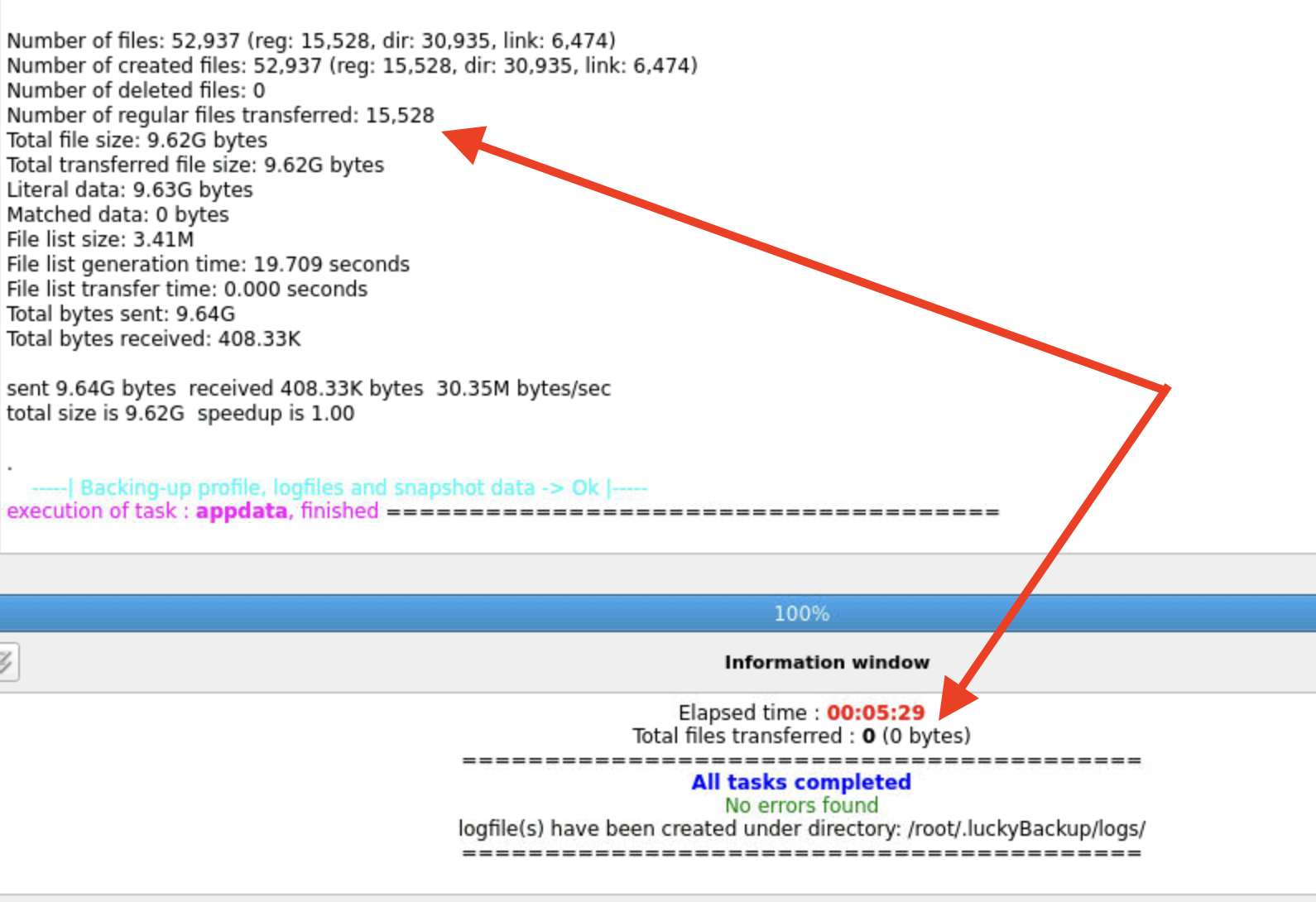

I'm just wondering about the info "Total files transferred: 0"
In this case I copied the whole share of appdata and the files are copied.
