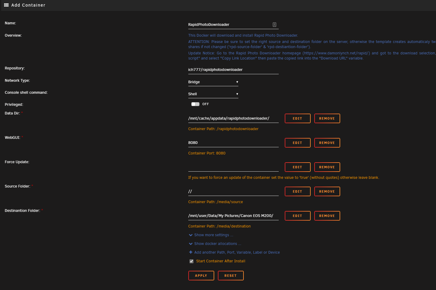

hi i want the source folder to be an usb card reader is that possible ?
if yes what's the folder path for source folder to use the usb card reader?
Thanks in advance
Thanks in advance
Never tried this but at least you could try.
I would recommend to do that in combination with Unassigned Devices and auto mount the media if inserted, but I also can think of various other problems that if the media is not connected the container won't start or if the media is ejected and you reinsert the media that it is not recognized again, maybe try to add the path with R/W Slave to the template.

thanks for your replay
so what should i put in source folder how can i find my sd card/card reader?
You have to mount it through Unassigned Devices first, then you have a mount point, for example '/mnt/disks/NAMEOFYOURCARDREADER'

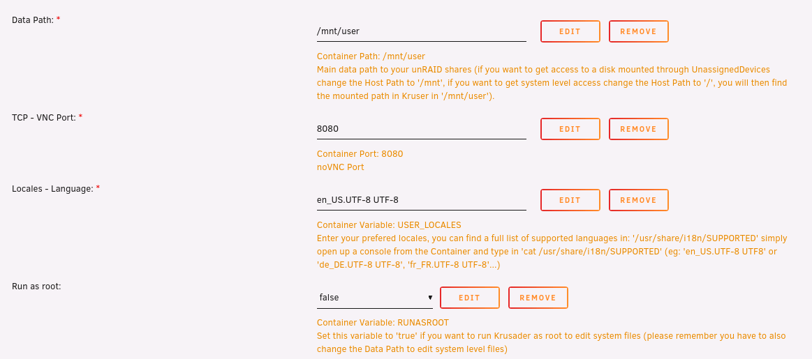

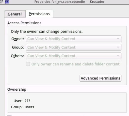

Potentially a noob query about krusader so bear with me;)
Some folders (with files and subfolders inside) when I try to delete them, do not respond to Delete/F8 command, literally nothing happens when I press Delete button.
If I however invoke terminal window in Krusader and rm -r the same folder it is deleted immediately every single time.
I used to remember Delete button worked with no problems. I did get the warning message that the folder contains files/subfolders inside but confirming these made the folders deleted.
Anyone knows what settings should be changed to bring back the functionality to Delete button? Thanks.
14 minutes ago, Januszmirek said:
Some folders
So this happens not to all folders/files? I really can't think why it is working on some and on some not...
I tried it now on a few locations on my installation and it works just flawlessly?
Is the context menu also not working when you right click the folder/file and click on Delete?
Do you run Krusader as root?
OK, so a bit more context then, I believe this all goes down to permissions.
So the folders with subfolders and files that are created by me in krusader can be easily removed.
The folders I have issues with are the ones created by other docker containers, for example CA backup plugin, or created on a windows vm and copied across a network share.
Some folders permissions tab is greyed out like in the attached screen. But other folders have User: krusader, but are still non-removable with Delete button.
I think a setting that would give krusader root access might be the solution but I don't know how to set it up.
Oh, I think you got a pretty old template from Krusader...
You can create a variable in the Docker template with the Key: 'RUNASROOT' and the Value: 'true' (both without quotes) to start the container as root.
You can also pull a new copy from the template from the CA App.
This is how it should look like or at least is looking in the "new" template (the value 'true' is missing in the screenshot but I think you get what I mean):
Sent from my C64

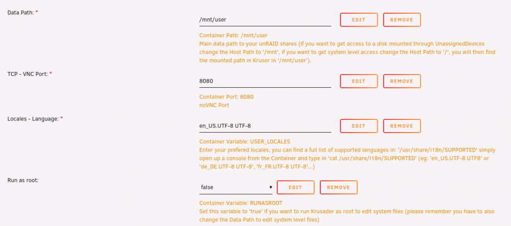

Wow;) that did the trick with the permissions ;) Thanks!
I don't get what you mean by an old template, though. I use ich777 repository and it is on its latest update. What else can I update to a new 'template'?
You have to delete the container entirely and download a new copy from the CA App to get the latest template since my container doesn't do updates to the Docker templates because that gave me some troubles back in the days with my game containers.
If you delete the container and re pull it from the CA App your settings should be there too, just be sure to note down your current paths and port configs and add or modify them in the template.
This is what the template currently looks like:
Thanks! All updated now and works as it should;)
