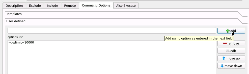

Hi all
With luckybackup is there a way to limit the transfert download or upload speed.
Using it with an rclone share
thx
Should be possible when you put this in as an extra argument:
--bwlimit=KBPS
Just add it like this (in this example 10Mbit/s):

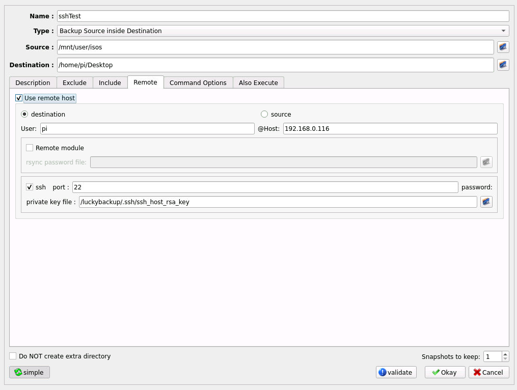

I want to create an offsite backup using the luckyBackup docker and connect to a raspberry (running raspian) using ssh. I read (in a german thread) that I should be able to use the ssh keys within the docker itself (/luckybackup/.ssh) and copy them using scp or ssh-copy-id.
My first problem is that even after copying the public keys onto the pi, I am still prompted to enter the password when ssh-ing into the pi from the luckyBackup console.
My more important problem: when I create a task and check the boxes for "Use remote host" and "ssh", enter the port and the private key location and click "validate" or "okay", the docker crashes with a segmentation fault, e.g.:
"/opt/scripts/start-server.sh: line 82: 107 Segmentation fault /usr/bin/luckybackup"
And the container restarts automatically.
Any help would be appreciated!
What key are you using and do you want to sync to the Pi or from the Pi?
Do you copy the keys from the luckyBackup container to the Pi or the other way around. Keep in mind you ron't have to copy the whole certificate you only have to copy the public key to the Pi  in the authorized hosts file if you are connecting from luckyBackup to the Pi and in luckyBackup you have to select the keyfile and not the public key.
Hope that makes sense to you.
Thanks for the quick reply!
I was using the ssh_host_rsa_key and want to have the Pi as my destination.
I opened the lucky backup terminal and copied the key using "scp ssh_host_rsa_key.pub [email protected]:/tmp" and then ran "cat /tmp/ssh_host_rsa_key.pub >> /home/pi/.ssh/authorized_keys" on the Pi.
My luckyBackup task looks like this. After clicking validate, I got a Segmentation fault ("/opt/scripts/start-server.sh: line 82: 113 Segmentation fault /usr/bin/luckybackup") and the container restarted.
--bwlimit=KBPS
Wow Thank you so much !!!
This looks correct to me, have to look into this on a fresh installation from luckyBackup since on my Backupserver it works just flawlessly, have you already restarted the Pi or the SSH Daemon after you've added the public key?
 Yes, I restarted the Pi after copying. Also set up a ubuntu VM to test and I am having the same issues.
Just ran it as root user and sadly it did not help
Did you always get a segmentation fault?
Have you something set that luckyBackup is put into background?
I have another idea how to solve this, have to test this first.
Yes, whenever I set up a remote task and click "validate" or "okay", the container restarts, and I can find a segmentation fault in the logs.
I am pretty sure that I didn't push it to the background; to be honest I would not know how to do it.
Can you try to setup a local task just to test if it segfaults there too?
Just tested and I can create and also run local tasks without any problems.
Have to look into this since on my backup server it runs without a problem.
Will soin it up today or tomorrow and test there a few things.
Maybe something is wrong with rsync.
I tested a little more and found that I can create (and run) remote tasks if I create a regular task first and then modify it to a remote one.
(I am also running as root user, have not tested without it yet)
I will try to narrow down the problem I am facing a little more and post an update in the next week.
Thanks for the help!

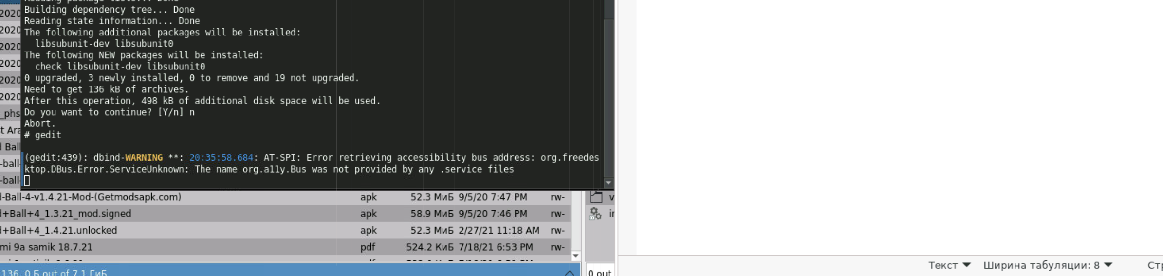

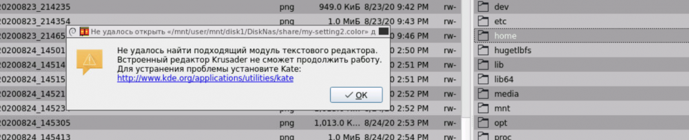

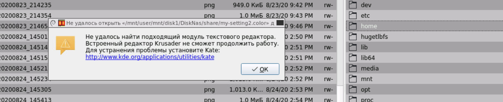

@ich777 Thanks for Krusader in Russian , founded that editor not working somehow ......
Running in Root mode ON , the viewver is working. but when launch editor haveing message " install Kate"
This should not happen, in my container I haven't installed Kate instead there should be Gedit.
Try to open up a terminal in the Krusader GUI and type in 'gedit' (without quotes).
Maybe look at the settings within Krusader the only thing that I can imagine is that the default text editor is reset somehow...
i removed container ,deleted folder and reinstalled but having same isure , i will check it again ..
yes gedit is working with some errors in terminal
