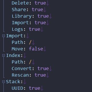

The config seems fine, in what folder did you copy the pictures that you want to import?
Please also look at this Github issue: Click
/mnt/user/Import Pictures
is the sub folders also checking when auto import from import folder ?
Edited by Masterwishx
From what I know no.
You have to upload the pictures directly to the main import directory.

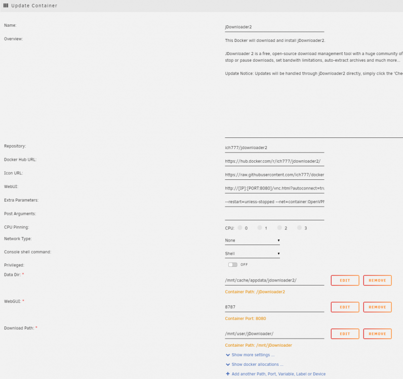

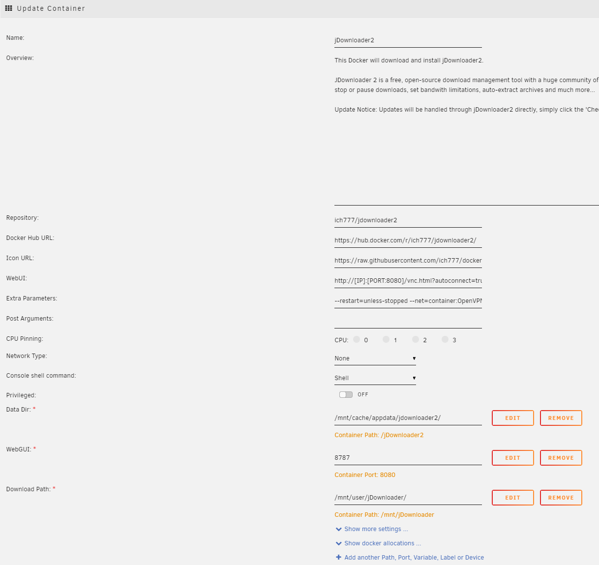

ok, now i tried with your jDownloader but i'm still not getting anywhere.
here's my jDownloader Container:
i changed the WebGUI port (because i have another container on 8080) to 8787.
What settings should i enter here on the extra port in the openVPN Docker?
Container Port 8080, Host Port whatever you want.
What is the IP from your OpenVPN container in your network, not in the container?
You can delete this entry from the jDownloader template because it does nothing when you route the traffic trough the OpenVPN container and set the network to none.
deleted the port entry in jDownloader template, configured the container port to 8080 and host port to 8987 and tried to restart the jDownloader Container:
removed the container and redownloaded it, now i can access the vnc/webgui!
speed is still not very good (600 kb/s vs 20 mb/s withtout openVPN routing).
But its working when import manualy
also checked in /config/setting.yml is no path but its setuped in docker ...
i can understand its more for Webdav to avoid some errors but we can run cron jobs for it:
so can we run it in user script ?
i dont know how to do it in user script ....
/usr/bin/docker exec PhotoPrism PhotoPrism/bin/photoprism index
/usr/bin/docker exec PhotoPrism PhotoPrism/bin/photoprism import
Yes, why not...

10 hours ago, ich777 said:
Yes, why not...
But after thouse lines nothing happen, maybe I wrote wrong command to execute import and index by docker run?
Usually you have to do something like:
docker exec -i DOCKERNAME YOURCOMMAND
3 hours ago, pika said:
edit: just tried binhex privoxyvpn but i can't reach the jDownloader Docker through that container...

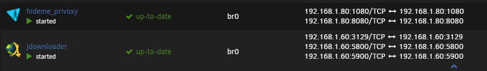

the Test is NOT to route the jdown container through the vpn docker by --container as network.
jdown has a buildin proxy option, just start jdown as bridge or whatever you like to use mode and enter the proxy settings in jdownloader, you reach jdown directly ...
sample from here
as you see, my VPN Docker (which you cant use as its a wireguard hide.me only) is on its ip, my jdownload is on its own ip, so i reach my jdownloader simple by 192.168.1.60:5800 or VNC direct 192.168.1.60:5900
inside jdown you configure now your http and/or socks proxy, name or ip (recommended to make sure), port(s), and disable "no proxy" to make sure all external traffic is going through there.
and my extra point is, this scenario you can test from your jdown docker, from any jdown on a VM, Windows client, ...
lets say the jdown docker would be very slow like you described and the windows Test Jdown would be fast, it may would be then a jdown docker issue (what i cant imagine)

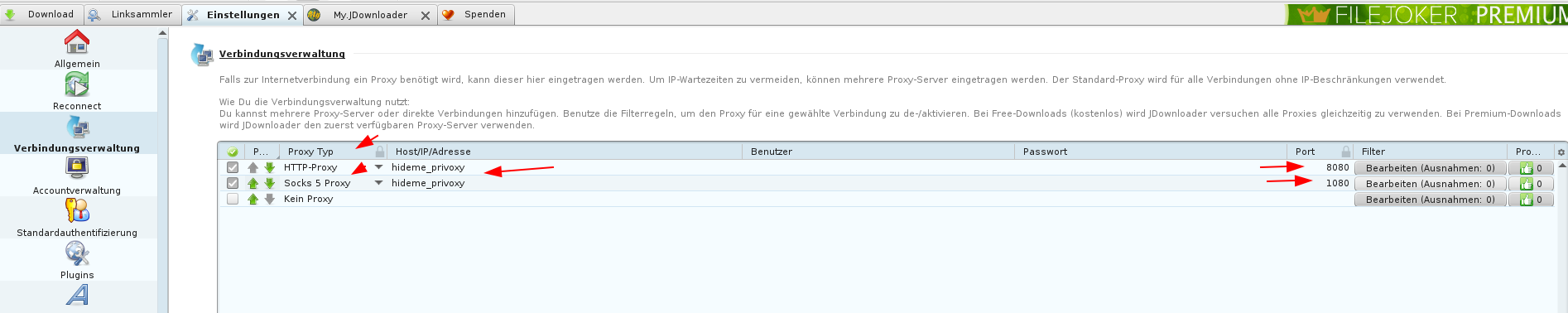

but how do i configure it? i still don't get it, sorry.
do i have to configure this in combination with f.e. binhex-privoxyvpn or do i have to configure it only on jDownloader?
Finally worked :
docker exec -i PhotoPrism /photoprism/bin/photoprism import

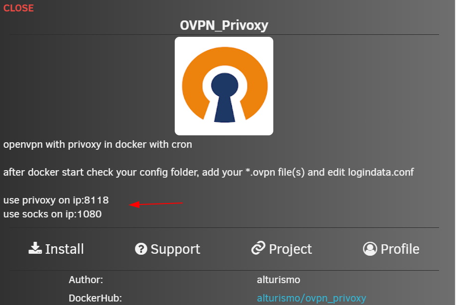

sure, either binhex/privoxy, i also provide a ovpn docker with privoxy and socks proxy, ...

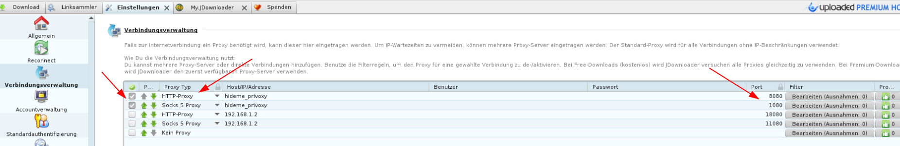

thank you! got it working.
download speed is the same (~500kb/s) as with the openVPN container.
without proxy ("no proxy") it's fullspeed (~20mb/s). :-\
ok, so now we can say its not a jdown docker issue, its more a ovpn docker with your rpovider when you get better speeds on your test with your vpn app on your desktop pc when i remember correctly.
