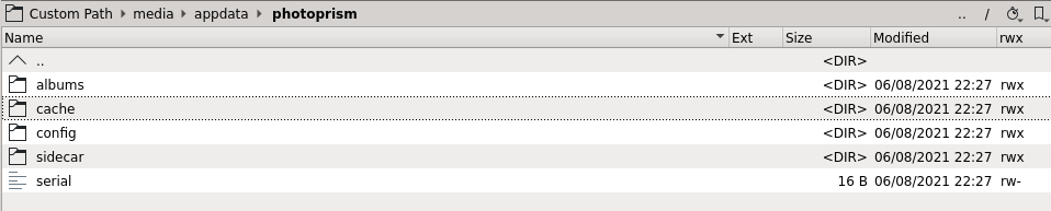

These are the folders created in appdata:
Any idea what could be wrong?

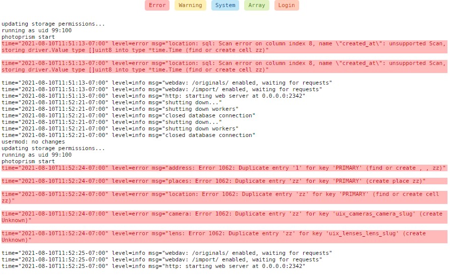

this is the photoprism log, not certain what these errors are. This is a result of a fresh install of both mariadb and photoprism.
1273936623_photoprismsetup.thumb.jpg.1ddeff4ccedf9be3e12976714ca598e2.jpg1877915219_photoprismerror.jpg.ae45789ccf4727f92fa4fbd89bcb847b.jpg
Edited by UnBeastRaid
Something seems wrong with the database connection.
Have you deleted the database for photoprism?

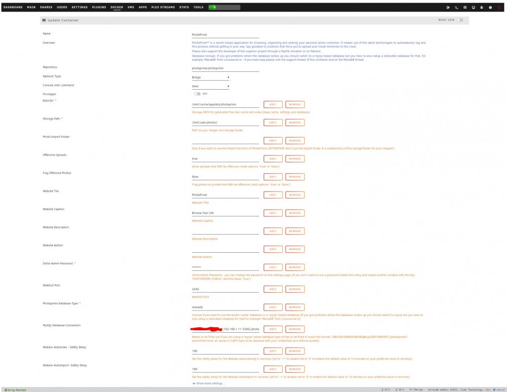

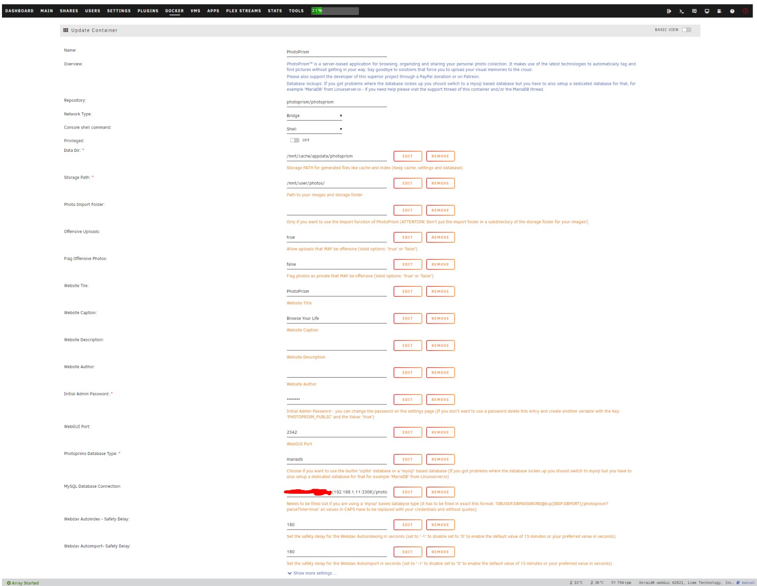

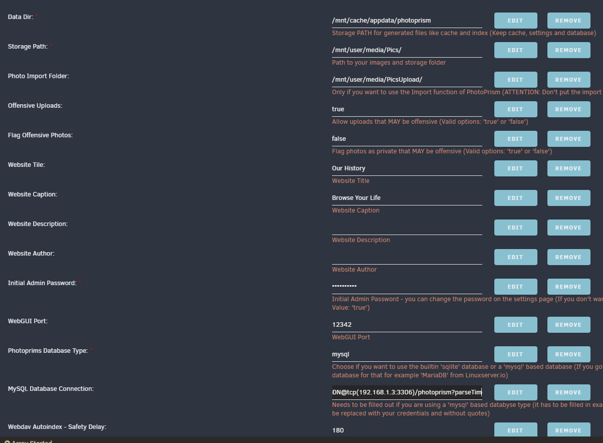

Can you post your Docker template settings? Maybe there is something else wrong?
By default the container will use a SQLite database.
here it is
11 minutes ago, ich777 said:
You've also made sure that the database is created and also the user in the database has read/write access to it?
Eventually this issue on Github is related: https://github.com/photoprism/photoprism/issues/478Click
I only can recommend to create a issue on Github if the problem persists.

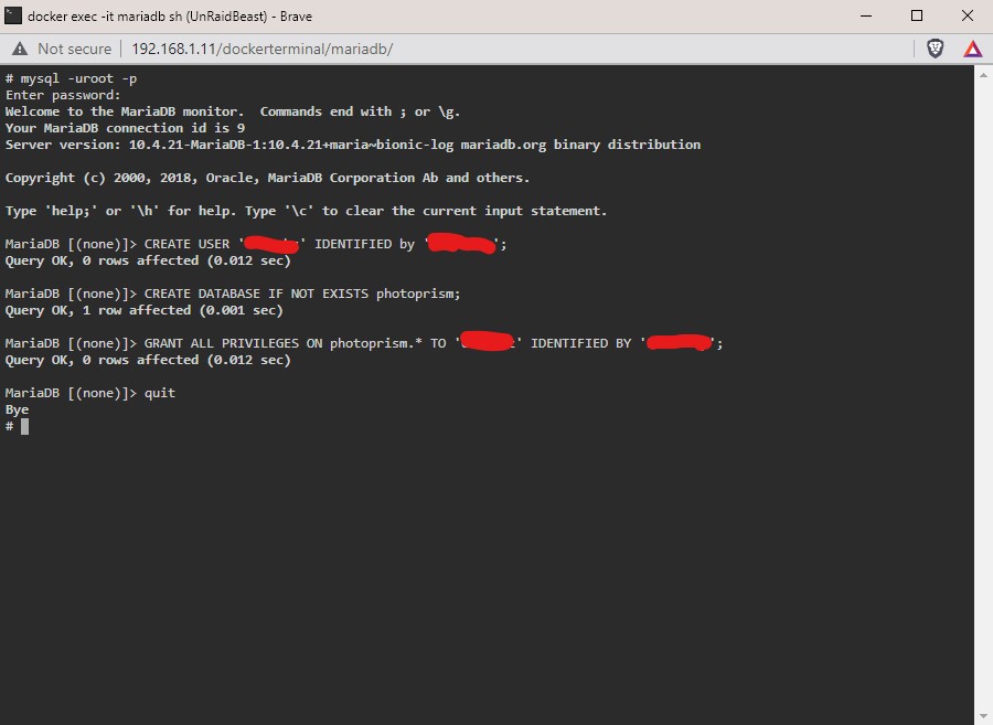

This is the Mariadb setup
Seems good to me. Try to create a Github issue please, maybe the developers can help here better than me.
