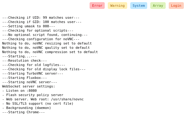

I'm using the chrome container and my chrome browser keeps crashing/restarting.  I enabled logging with --enable-logging with the additional parameter to see what  was happening.
Failed to connect to the bus: Could not parse server address: Unknown address type (examples of valid types are "tcp" and on UNIX "unix")
To clarify, the docker doesn't restart, but I get a 'Chrome closed unexpectedly, click here to restore session' constantly.
Any ideas?

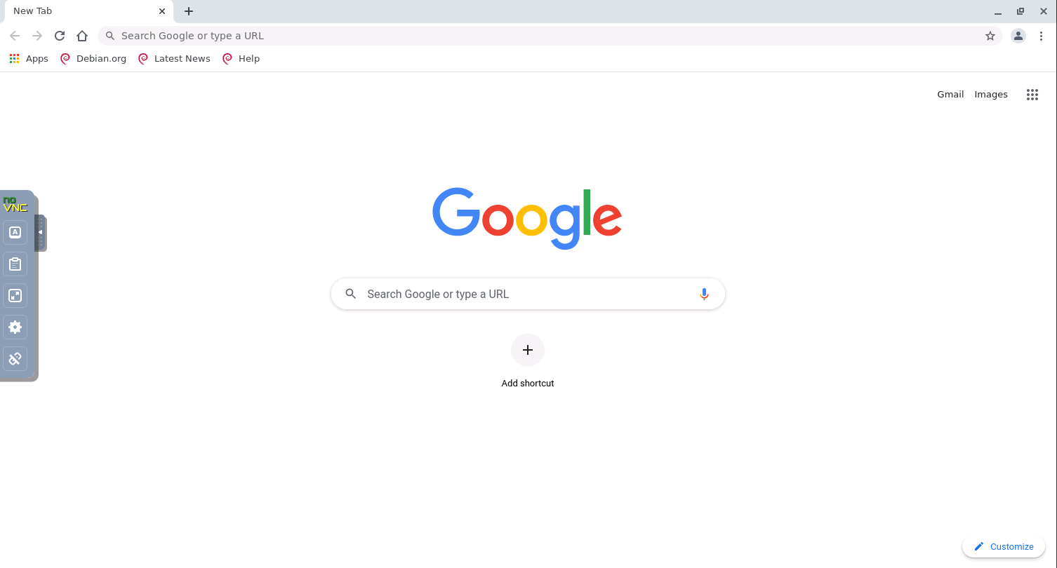

Please post a screenshot from the Container log output where the error is visible, if possible also include a screenshot from the full Docker template.
I tried it now on a fresh installed instance and it runs flawlessly:
Log:

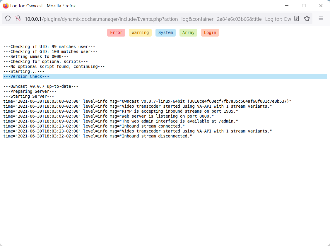

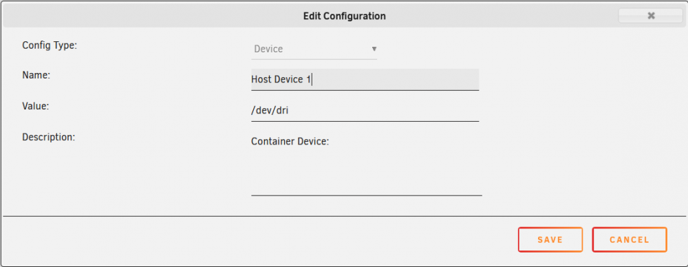

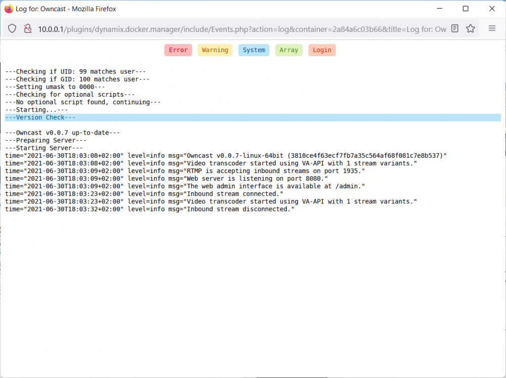

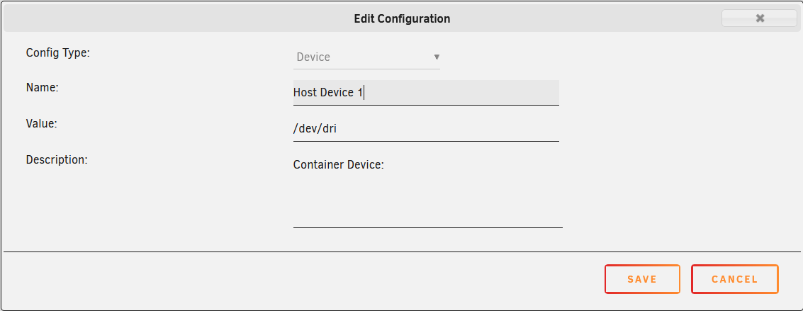

Can you please try to switch the branch to :test like this:
and also pass throught the path /dev/dri like this (please be sure to do a: 'chmod -R 777 /dev/dri' first on a Unraid console):
I've tried it with my Intel iGPU and it works flawlessly in the test branch Container:
