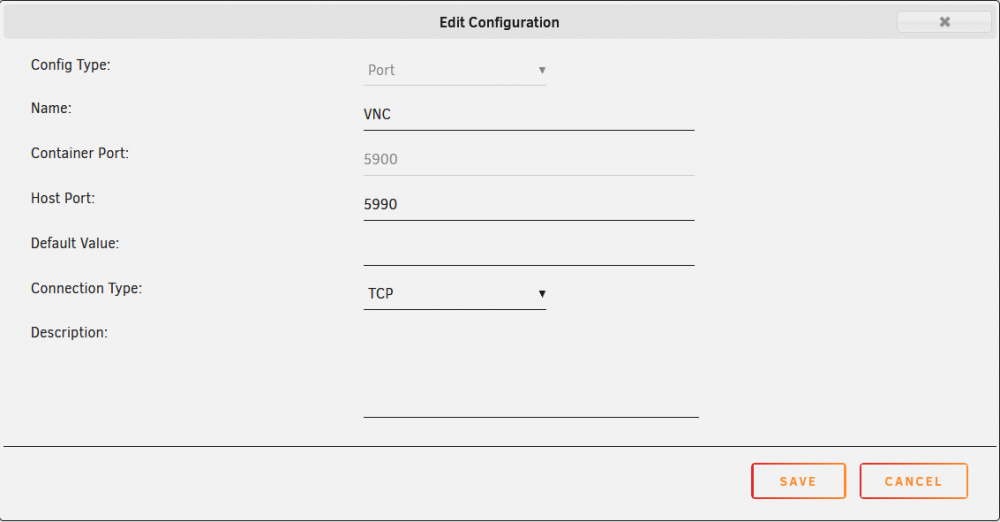

48 minutes ago, geek_diruendis said:
Maybe it didn't properly post.
Oh I can't open the link... Eventually my PiHole is blocking it.
i've also tried swapping UID & GID for PUID & PGID to both = 1000, because I've found my other containers work better with that in the past
Oh, from what I've see you don't run this on Unraid? But this is a x86_64 platfoem? Also PUID & PGID work with my container, you have to use UID=1000 and GID=1000 if you want to apply this properly.

12 hours ago, ich777 said:
x86_64
Snap. That may be the problem. it's aarch64. Sorry to waste your time.
But the rest of it works great! Thank you for you dedication on these projects!
Not a waste in any way... :)

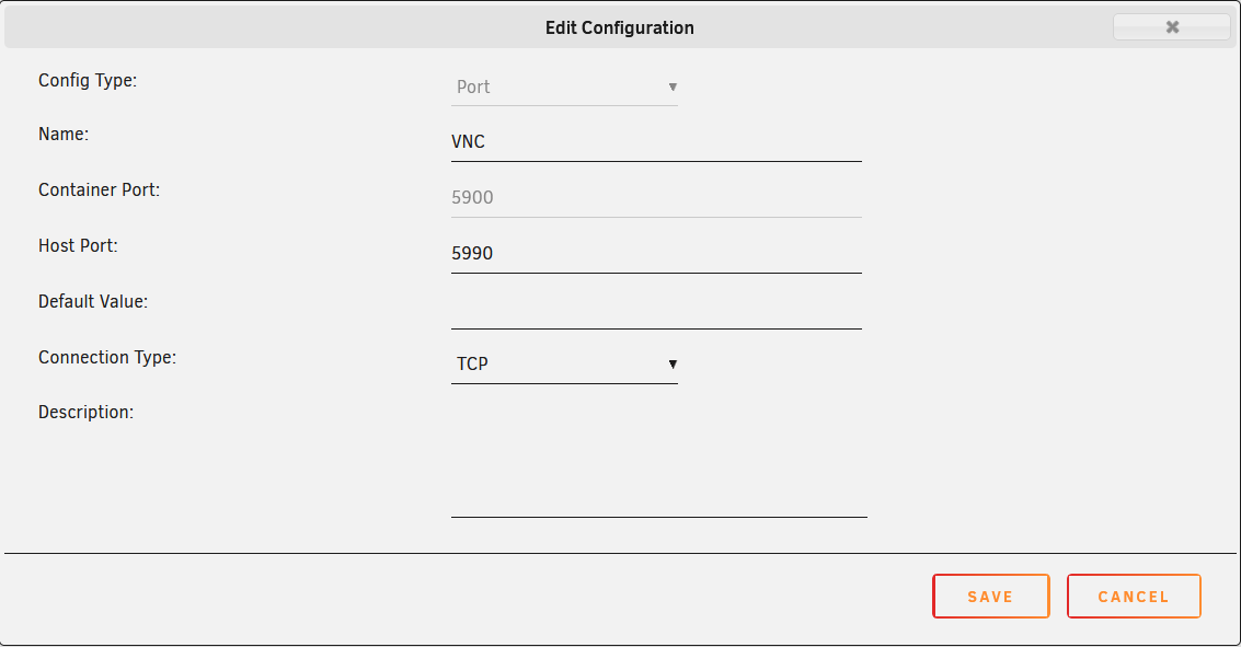

I tesing currently the chromium docker, is it possible to install RealVNC Connect in the container instead of noVNC?
What is the advantage of RealVNC connect over TigerVNC?
You can directly connect to the containers VNC server when you create another port in the the template with the container port 5900 and host port whatever do you want like so:
Then you can connect to the container with YOURUNRAIDIP:5900
