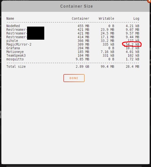

need help with the magicmirro2 docker. How to turn off logging? Mine is eating up my diskspace with its logs. So far arround 18GB... Want to delete them and turning off logging for that docker. Thanks for help!
Can you please be a little bit lore specific? Which file does grow to that size and where is it located, do you also have screenshots? Eventually a plugin that doesn't work properly is causing this.
Mh did nothing other then restart the MagicMirror2 Docker. Now the Log is no longer 18GB in size. The Logfiles of MM did grow over the last weeks. I restarted unraid and the docker multible times. feels like the docker knew i would open a helpthread and deleted it it self. sorry for your time.
Edited by CyrusThe-
If it happens aigain please be sure to make a few screenshots and feel free to reach out to me again. ;)
