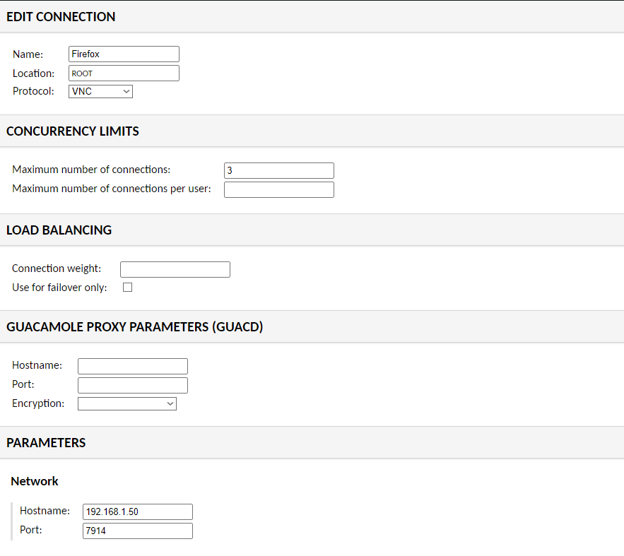

hi
anyway to get chrome to work with guacamole? found a guide using firefox but its very unreliable.
Eventually someone has it running with guacamole but I can't really help since I don't use it that way...
shame. would be really useful. I cant find anyway of getting it to work
I don't know how Guacamole works, does it connect to VNC or what, a little more information would be helpful since I don't know Guacamole.
If it can connect to VNC you can always create a port forwarding from the Container port 5900 to 5900 Host (or whatever Hostport do you want) and then should be able to connect to it. ;)
It does use VNC and works with firefox but i have issue with that browser. https://technicalramblings.com/blog/remotely-accessing-the-unraid-gui-with-guacamole-and-vnc-web-browser/
port forwarding isnt secure. Guacamole is a platform that allows you to access RDP VNC to your servers is in a more secure way. It has mfa to access to the dashboard where you can access your systems.
This chrome version doesnt like what ever settings i use to VNC to it from guacamole.

@dfox1787 may show your setup what you did.
im pretty sure you are connecting wrong from guac to your chrome docker, in terms you use VNC protocol i guess, you have to point to the native vnc port in the chrome docker and by default this port aint added to the template.

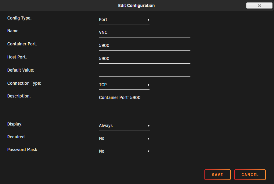

by default the bridged port from the template is for the webui and not from vnc, you should add a port forward in the docker like 5900 5900 and no, this has nothing todo with security ... then guac can connect via vnc.
sample
sample
i understand. By default the chromium container doesnt connect via VNC that correct? Guac and Chromium are on the same network using the default ports. i assumed this would just work like i am connecting locally.
like described, this wont work, you try now to connect to the webinterface which is used in the chromium docker and not directly vnc.
this docker also provides its own web interface for vnc, like guac is ... but guac wont work with this, im pretty sure its listening locally on 5900 (standard vnc port)
and if you try to keep inside your proxynet its overall completely wrong.
then you should use as host your dockername like "chromium" lower case ONLY and as port 8080 (the local port, not the port provided to your net) ... but as mentioned is NOT the VNC port ...
i would suggest to add the port variable like described and try port 5900 then

@dfox1787 and as you use(d) firefox browser (i guess djoss one) you should be aware about the 2 different ports, its explained in his template about web front end and vnc direct ...
i did use it but it caused me issue so im trying to get chromium working.  Are you saying use his guide but for chromium? option are not the same
no, i say add a port maping in chromium docker and setup with 5900, thats it.
Edited by alturismo
i know i did try that but it doesn't connect on that port. Page cannot be displayed on port 5900
then you do something wrong, just tested here and works
thanks ill take a look into it
Try a different port Container port 5900 and Host port something completely different for example 5950 or something like that.
In my case I got many containers running with this setting to connect with a VNC Viewer to it from my local network for example Thunderbird.
