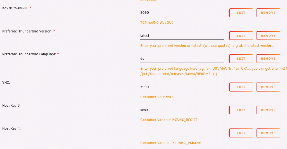

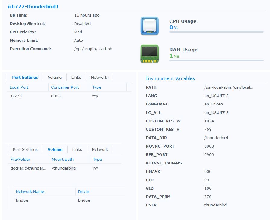

Hello,
I try using ich/thunderbird docker on Synology (having a few other containers already active and working fine).
I have installed and configured Thunderbird docker, but I cannot get it to work
the log files says:
---Starting...---
---Version Check---
---Thunderbird not installed, installing---
---Something went wrong, can't download Thunderbird, putting container in sleep mode---
the network is set to bridge, so it should have full access to internet.
edit:
I looked in the respective docker folder and only found 3 files
15 Feb was my first try... 21 is from today..
15.02.2021  14:36               215 .wget-hsts
21.02.2021  16:49                 0 Thunderbird--.tar.bz2
15.02.2021  14:23                 0 Thunderbird-78.3.2-.tar.bz2
Where can I start locking to get it to work?
Edited by Wolf
updated details
36 minutes ago, Wolf said:
Hello,
the log files says:
---Starting...---
---Version Check---
edit:
Can you try to stop the container and then delete the thunderbird files and then give it some time so that it can download the files?

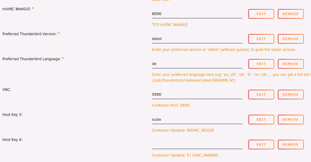

Are you sure that the container has exclusive access to the Internet without any blocking software infront of it like PiHole?
Also can you post a screenshot from the Docker Template itself?
pihole is active and running.. but github, thunderbird are all available.. I will try agin with pihole completely deactivated...
I do not understand what you mean by post a screensot of the docker template itself.. do you mean the config or var. settings?
Something like this:
ok, here we go..
