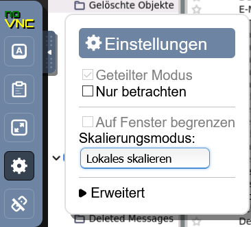

What you also can do is to enable 'local scaling' in the noVNC options like this (but keep in mind this can look a bit washed out depending on the screensize):
(the picture is actually German but I think where you can find it)
Thanks for the tip. That stretches everything out a bit and more legible. Was hoping for more dirsyncpro screen real estate though.

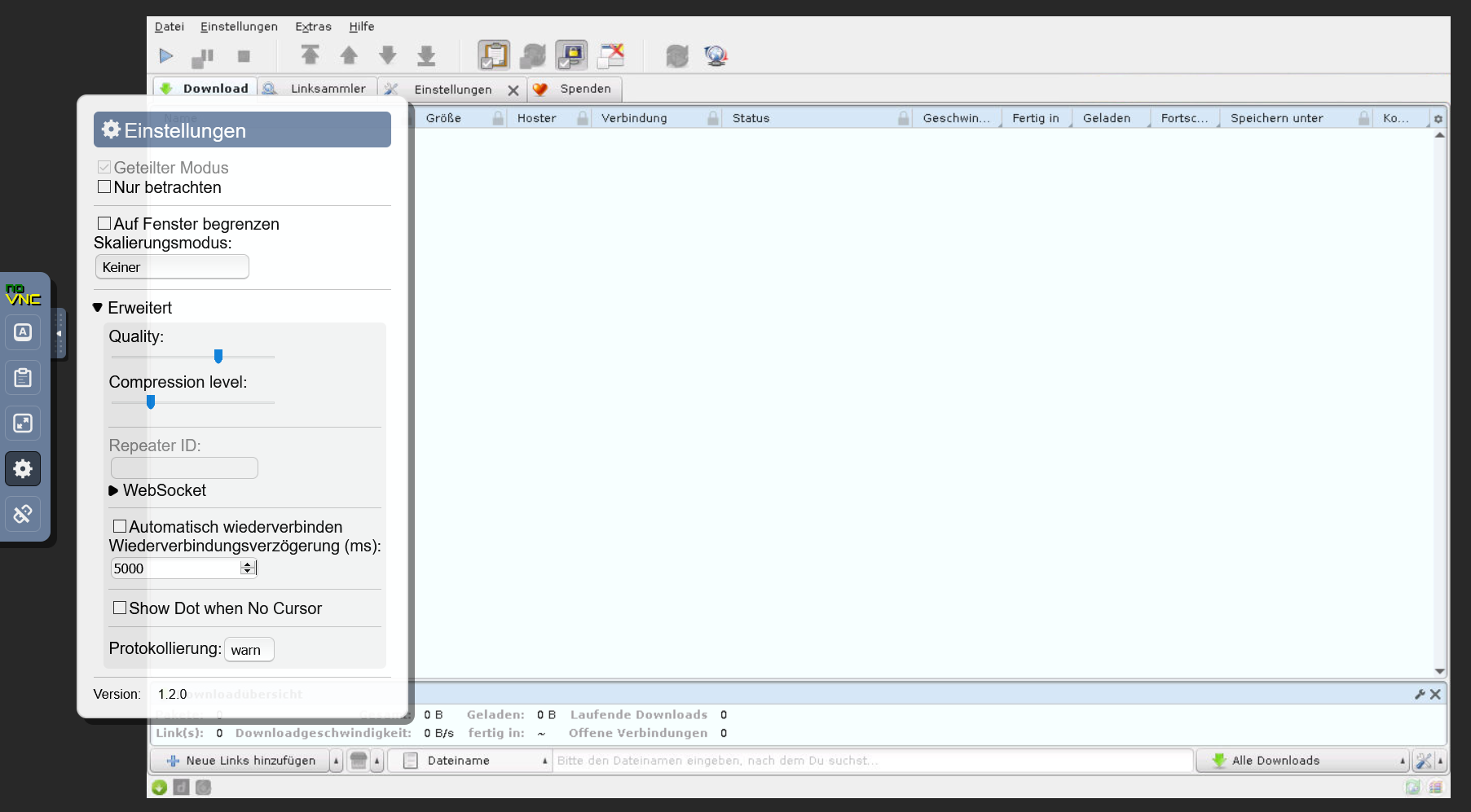

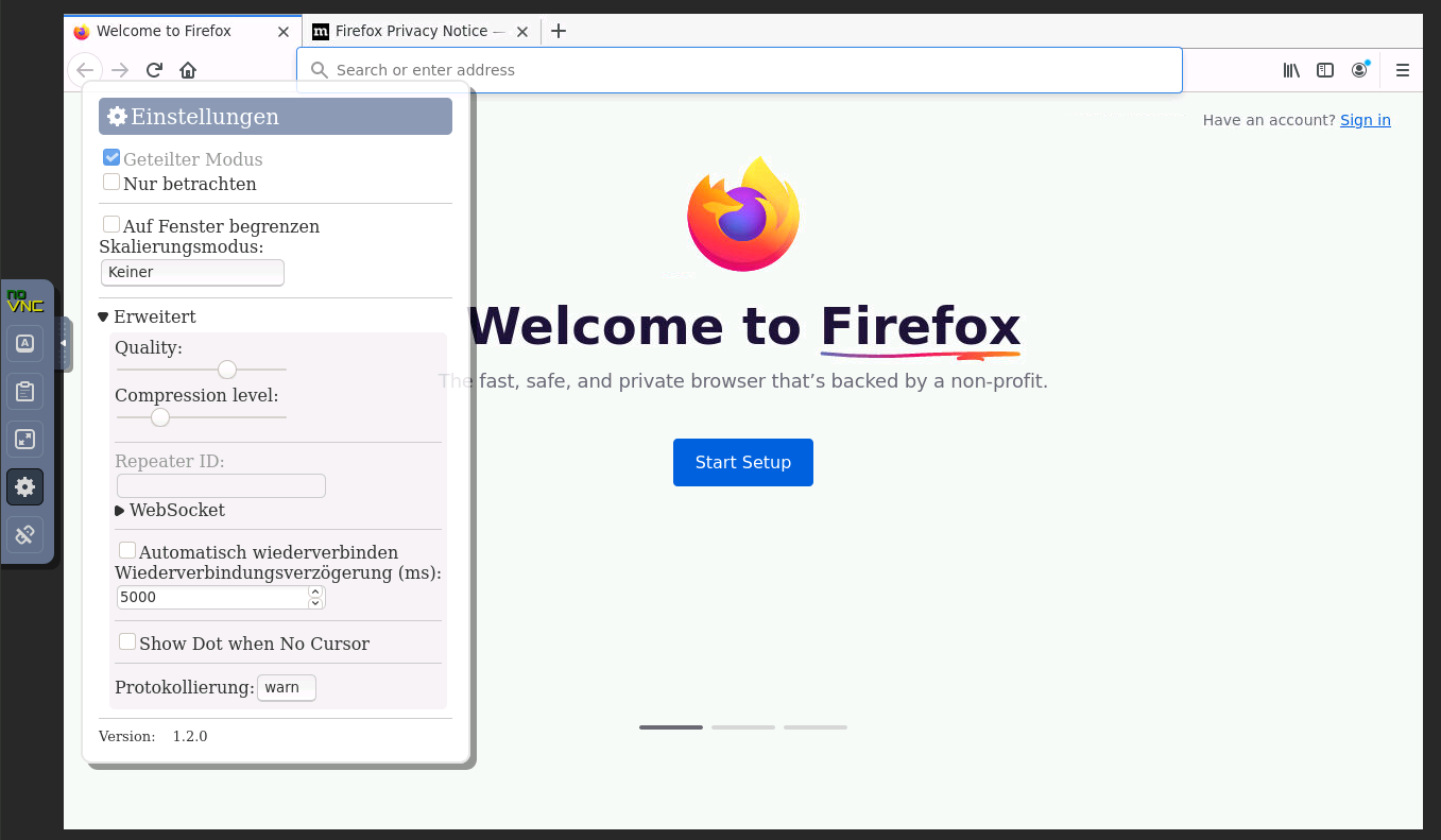

Bumped noVNC to version 1.2.0, you now have the ability to use the sliders like you have it in other containers.
That worked! It looks so much better now. Thank you!

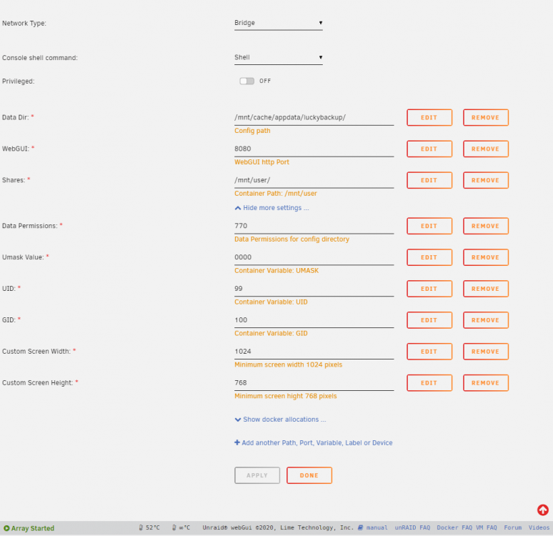

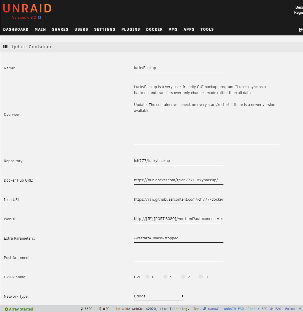

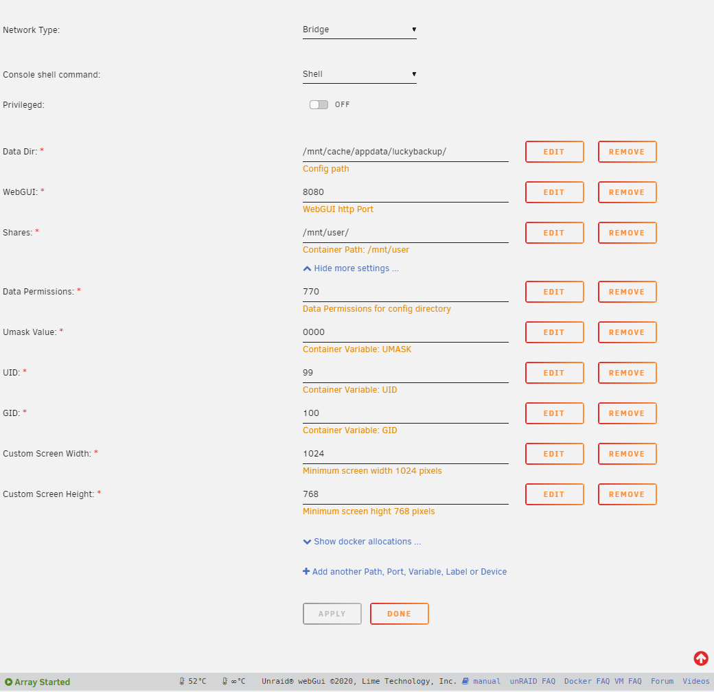

Can you also post a screenshot from your template configuration, have you included something custom?
EDIT: You should now have this options:

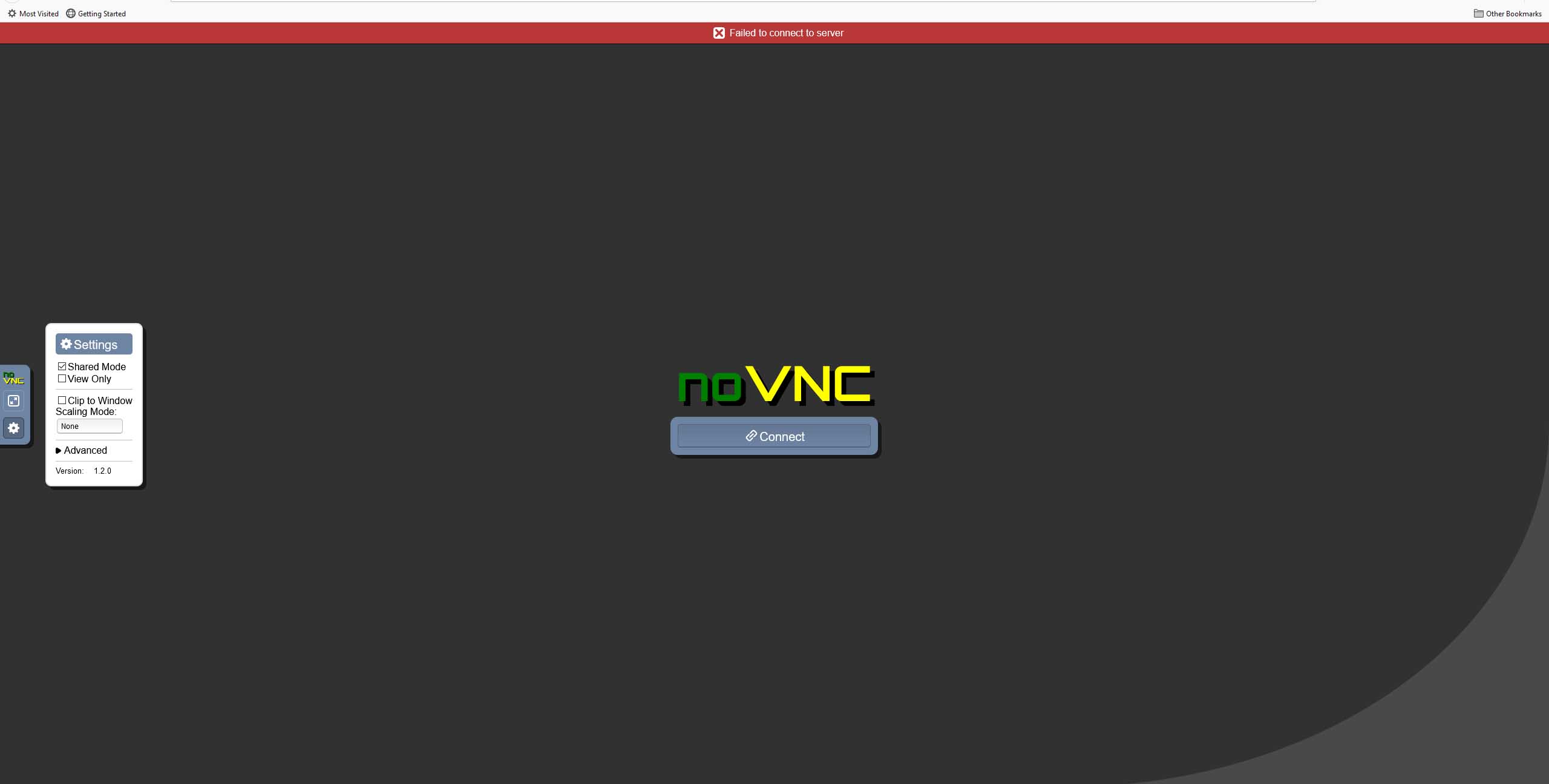

I may have the same issue as xtrips... unRAID 6.8.3, CA said there was an update to luckyBackup, so I updated. Now, launching the WebUI results in a noVNC screen with, "Failed to connect to server" across the top in a red banner.
Unfortunately, I've only been using unRAID for a little over a month and I'm not very familiar with trouble-shooting things within it, or Dockers. The one thing I found, in the log, that looked odd was...

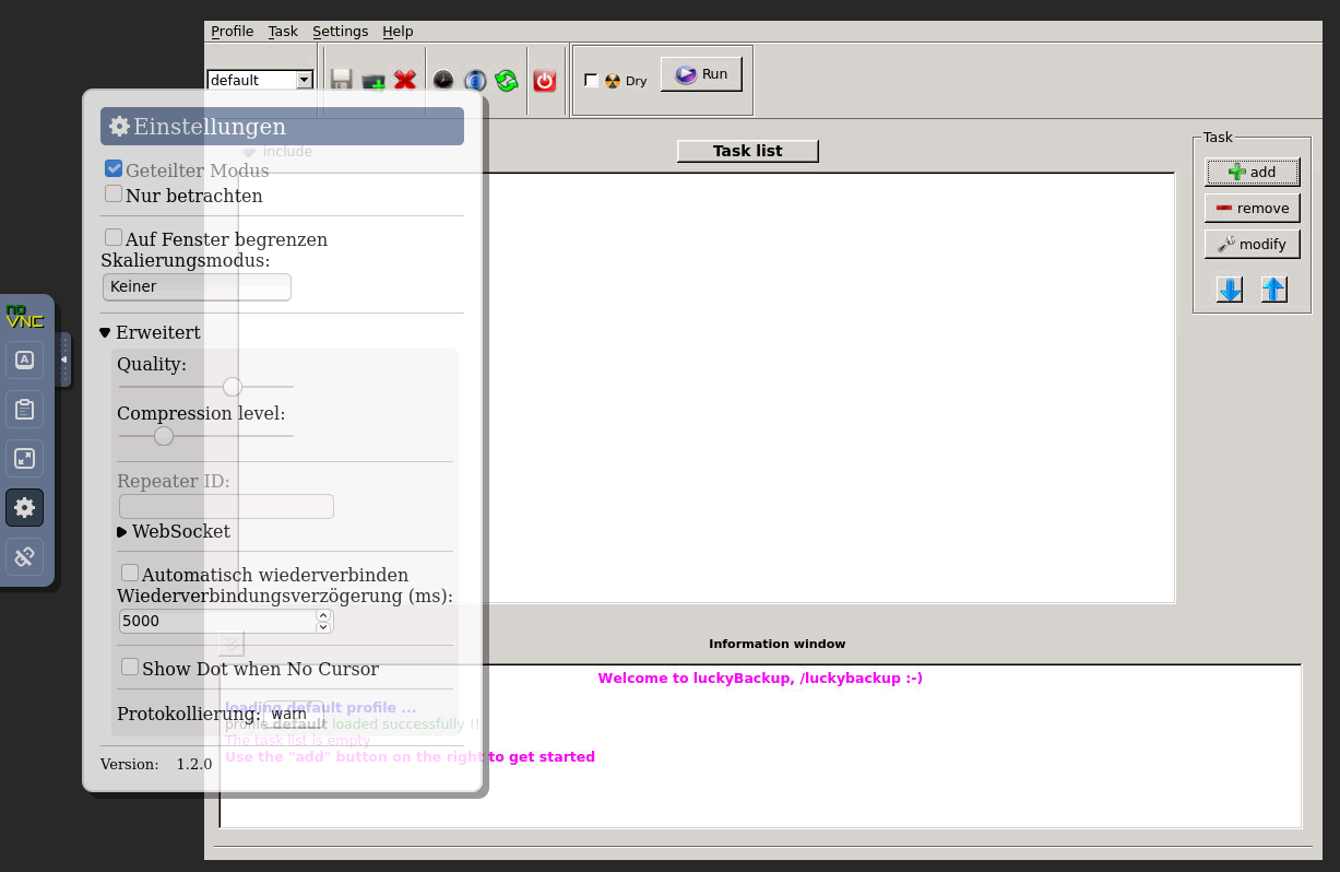

Are you sure that you completely refreshed the page? I tried it now and it works flawlessly:
Can you open up the side panel of noVNC and click on the gear icon and on 'Advanced' and see if you got the Quality and Compression level options?
EDIT: On the bottom it should say 'Version: 1.2.0' like in the screenshot.
If not the page refresh wasn't successful.

I have completely refreshed the page (and checked myscript-blockers very thoughly).
My "left menu/novnc menu" only has the "cog/settings" and the "resize screen?" the icon above the cog as you display it.
Hah? :)... Learned to attach an image without having to host it myself... maybe... guess I won't know until the big delay posting this message.
Anyway... there's my screen. I hope (fingers crossed)
Looks good.

Have you any special configurations in the template, eventually a screenshot from the template also would be helpful.
