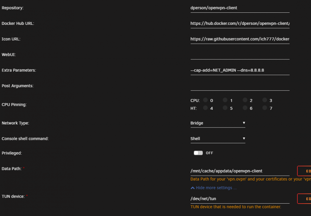

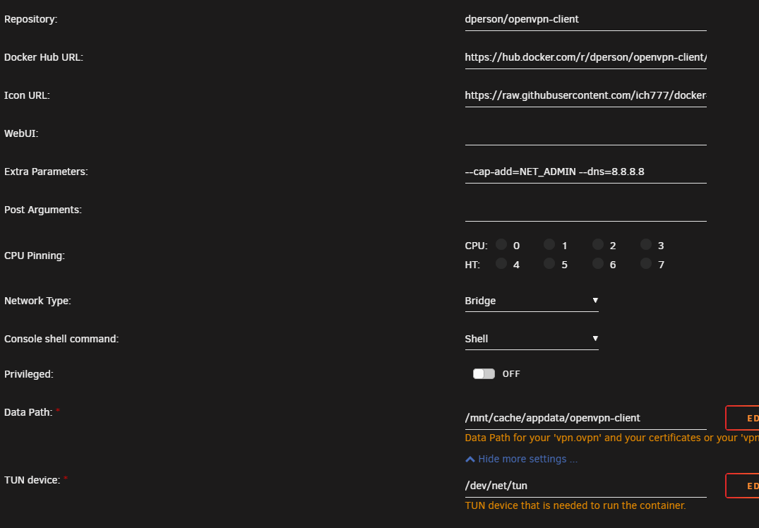

EDIT: are you running a second container that is connecting via openvpn? Which unraid version are you running?
Screen shot below. Didn't make any changes to template. After multiple attempts, tried putting the --device.... line in extra parms. Tried host instead of bridge. And yes, I do have another docker running OpenVPN (binhex-qbittorrent). I was looking to set this up and then just run straight dockers (non-vpn-combo) through this. I did try and shutdown the other docker, but no luck. Unraid is 6.8.3.
2 hours ago, jmbailey2000 said:
Screen shot below.
Thank you.
The device is mapped at the advanced settings so you don't have to add it again.
Unraid is 6.8.3
I'm on 6.8.9beta30 and there is no problem but what you can try is to look if the directory '/dev/net' exists on Unraid itself.
Open up a terminal and type in 'ls -la /dev/net' then you should see something like this:
You can also try to create the base directory /dev/net with 'mkdir -p /dev/net' and then try to start the container.
Have you put in any files in the directory of the container (if so please remove them and see if the container start fine without them, it should at least start and wait for commands, if it starts please also attach a screenshot)?
Please let me know if it works.

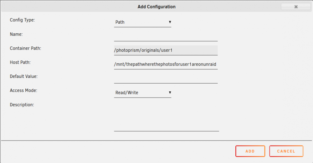

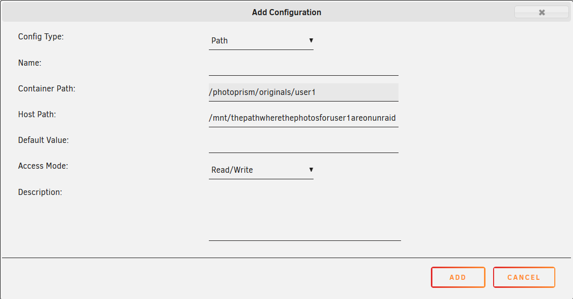

Yep, this I also read, including yamls, but where do I put this into template (web)?
Oh sorry, yes, here is an example just edit the container and click on the button 'Add another Path, Port, Variable, Label or Device' and create it like so (and eventually change the acces mode to 'Read only', you can also type in a name if you want to):
