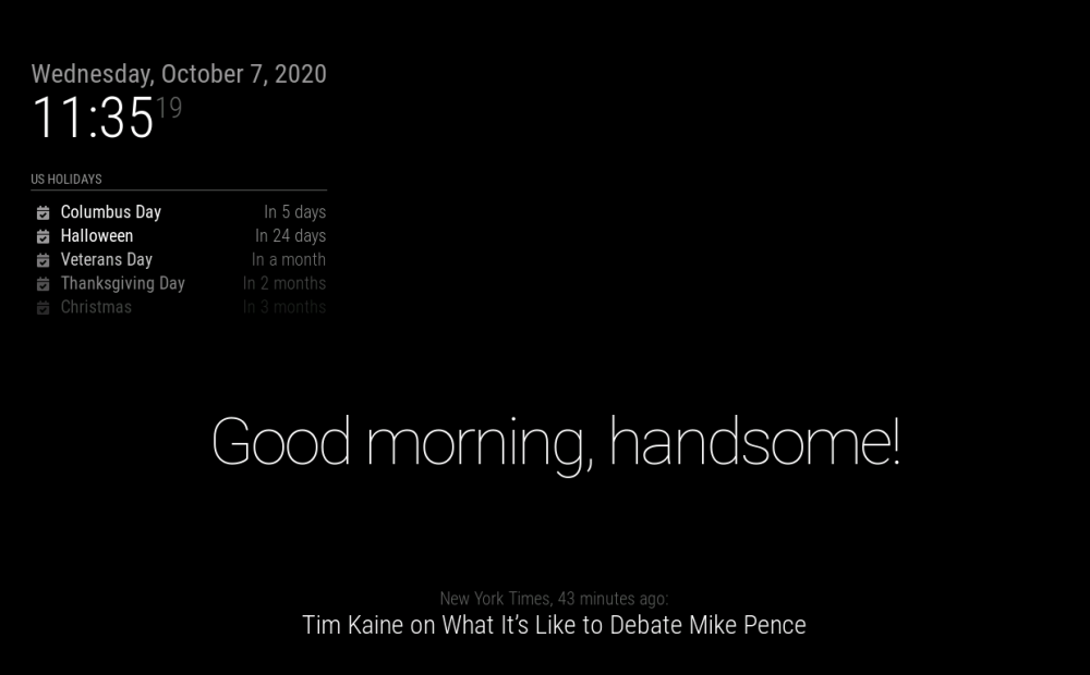

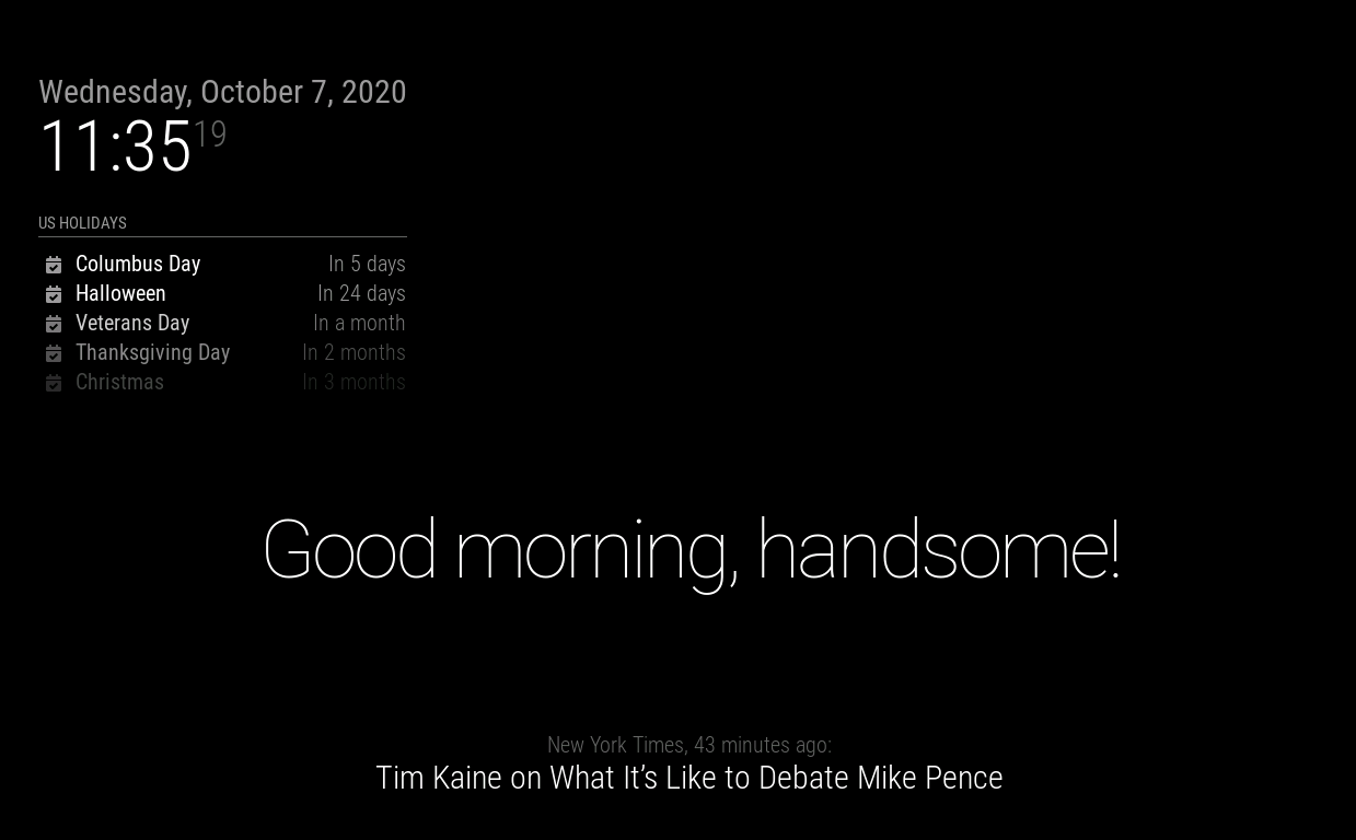

I now tested the MagicMirror and it seems to work fine, at least without any addons (don't use it personally).
Can you provide your log (on the dockerpage the little sheet icon on the right side or the blue text right - dependent on which View you enabled) so that I can look into it? I think that some plugin/addon causes the issue.
Attached the startup log magicmirror2.log and also a screenshot:

No, don't want a screenshoot. :D
This was only to show you that it works OOB. ;)
Hmm really strange since the last entry says: 'Ready to go! Please point your browser to: http://0.0.0.0:8080' that should indicate that it runs.
Can you please try to download a new copy with a different name (eg: 'MagicMirror2Test' or something like that) and install your plugins/addons there?
I think there must be something wrong with a plugin/addon.

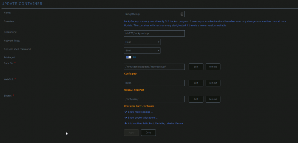

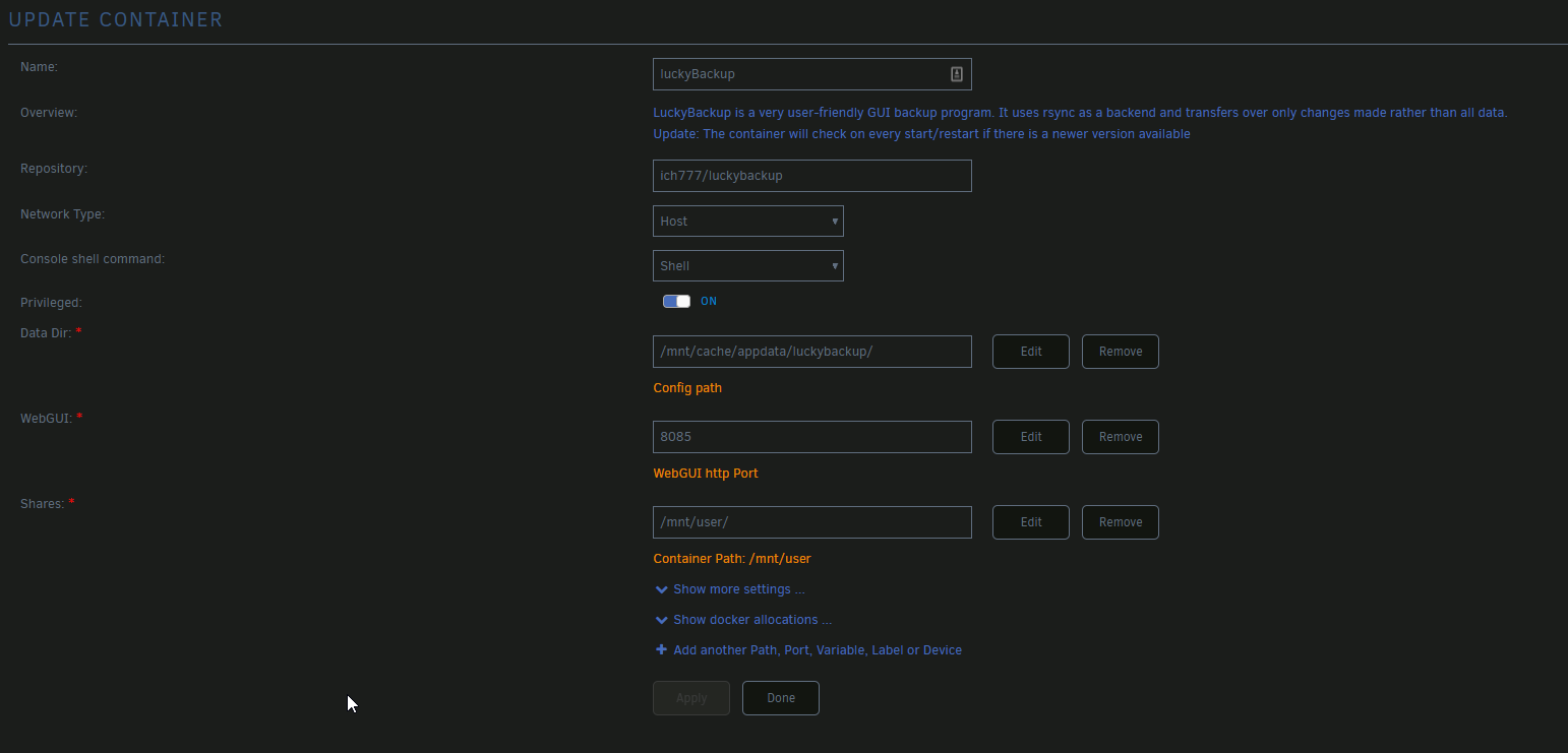

Hello! With luckyBackup, is it unable to be ran on ports other that 8080? I've set it to 8085 and yet it still shows running on 8080. I've restarted the docker several times with no luck.
Thank you for any insight you can provide.
This is because you've choosen the wrong network type I think...
Use br0 not Custom if you use custom it has it's own IP address on port 8080 then the ports doesn't matter because it has it's own IP address.

You were correct, that worked. Thanks!
