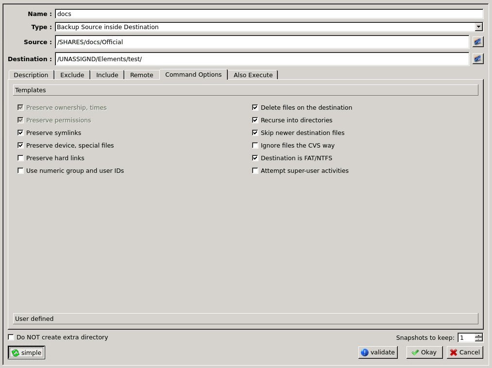

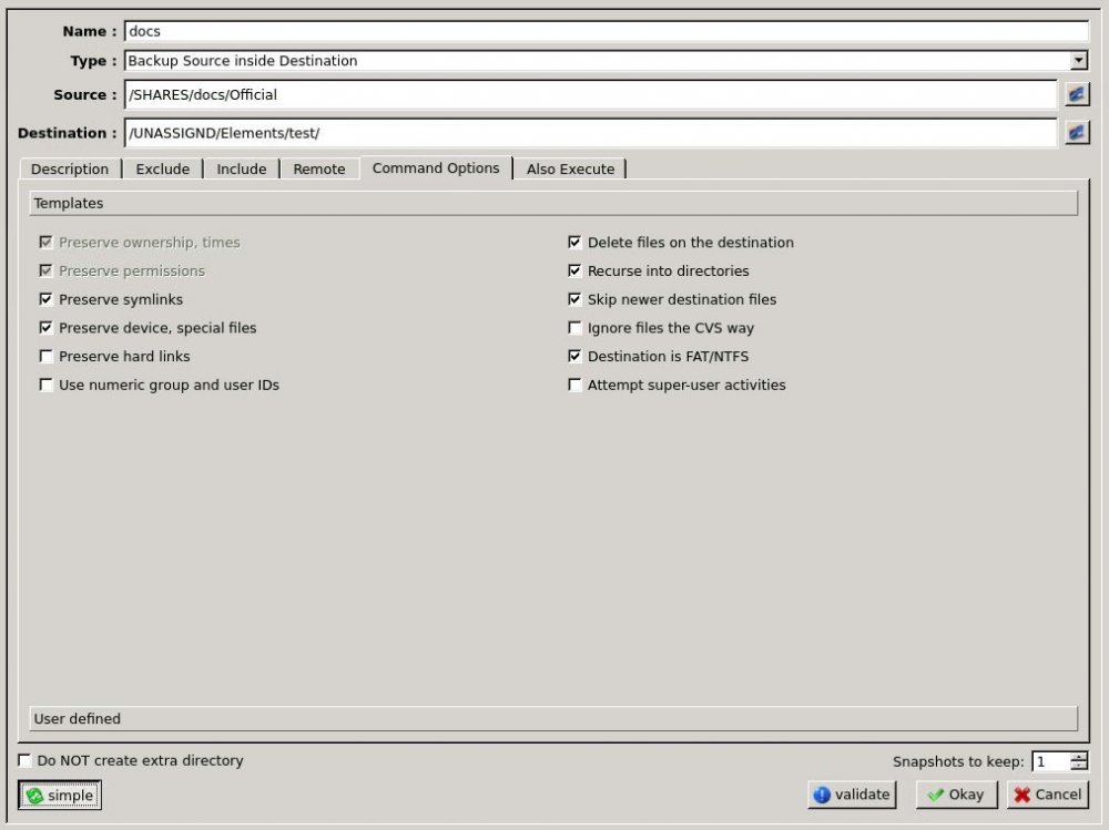

I do not know if this is a bug or just me missing something.
I am trying to sync my share to external drive ( using unassigned devices ) , I unchecked the option ( skip newer destination files ) in COMMAND OPTIONS cause I need an exact replication. but as soon as I click Okay the option got checked again by it self !
Also the option ( Delete files on the destination ) is grayed out and can not be selected.

EDIT: I think you are talking about luckyBackup
No problem here, have you saved the task after you clicked Okay?
LuckyBackup
actually problem partially solved.. it was my mistake that I choosed the Synch not backup under (Type)
but still have a problem of not deleting files that exist in destination but not in source.
my need is to (one way sync) source to destination so that any change in source (add-delete) will be reflected to destination.
This is what the option "Delete files on the destination" does but also for this to work "Recurse into directories" have to be used, but also the tooltip says that.

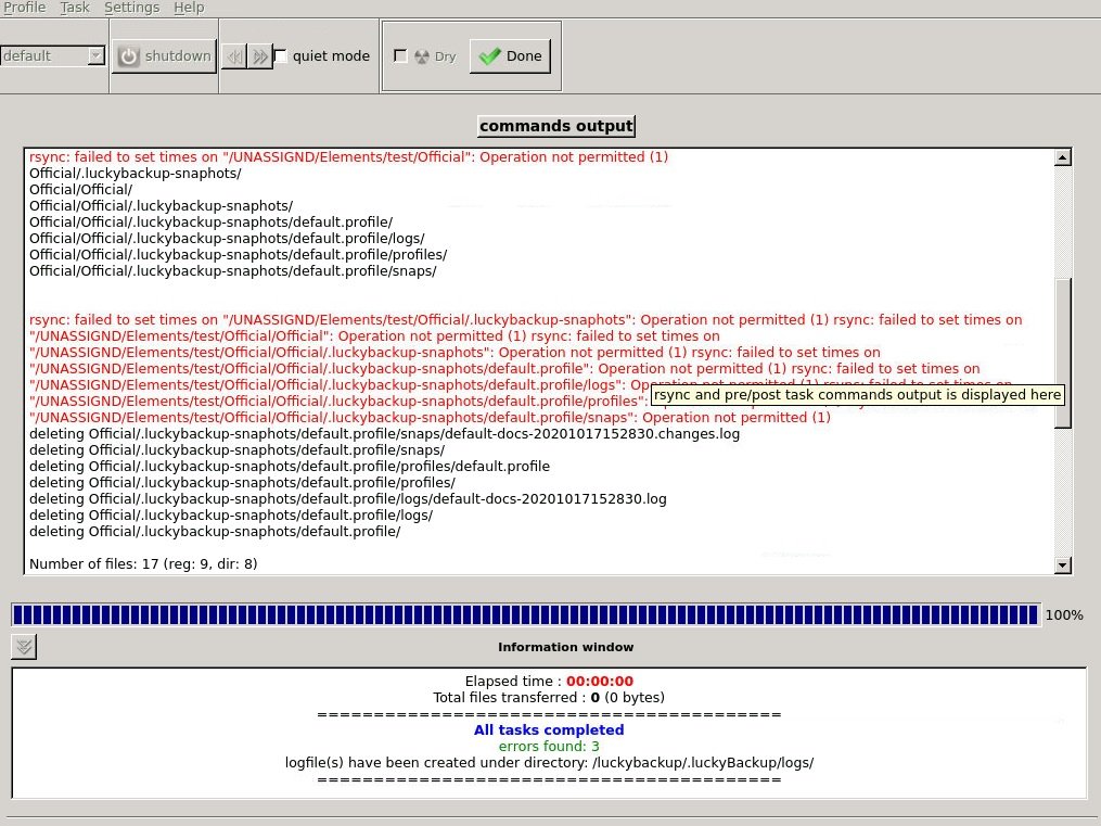

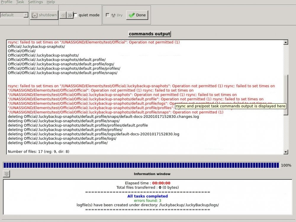

I did that already. but files still exists in destination.
also I got some errors as in attached capture.
imageproxy.php?img=&key=e5eec7c5c933ca16imageproxy.php?img=&key=e5eec7c5c933ca16
These are permission issues from luckybackup itself because it's running currently and you are backing it up at the same time.
You can't do anything about it.
