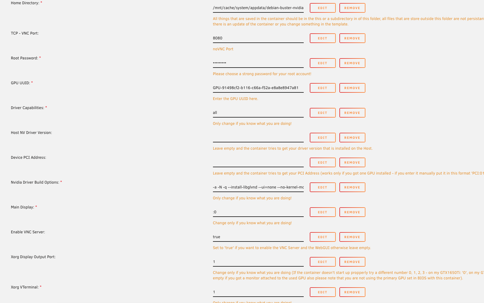

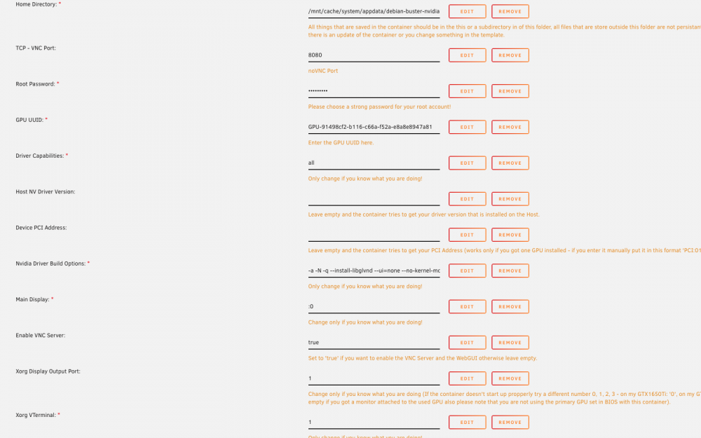

Can you give me a screenshot from the template?
EDIT: Are you executing the commands inside the container or on Unraid itself?
Clicked on Docker, Clicked on Console and typed startx

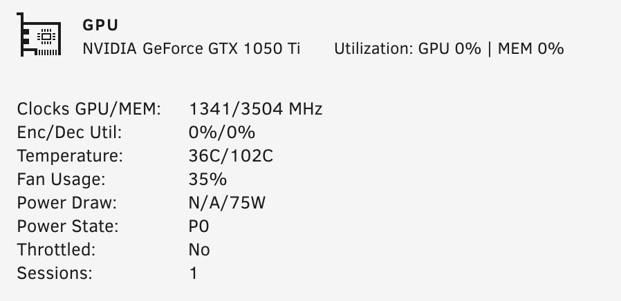

This is my current stat of my GPU while Transcoding an old AVI file. Plex says (hw) next to it so I can only assume its doing its thing.
On my attached file below I recall it saying P8 earlier and I thought it was louder.
Yep, you can see actually that you GPU is doing something because P0 is the highest power state and at Sessions it shows 1.
Can you try to change the value at 'Xorg Dsplay Output Port:' to 0 (oh there is a typo in the Variable name).
Ran it again after changing Xorg Display Output to 0

30 minutes ago, kizer said:
Can't open display :0
Have you attached a monitor to the card itself?
Try to also change the variable 'Main Display:' to :1
In my Bios I have my on board Video card set as the primary no I've not connected to the GPUcard its self. I know it works because it used to be in another computer.
I've changed the variable and the Xorg in so many different combinations. lol
If you done that it can be that it doesn't work as in my testing when I created the container back then... :D
A restart will fix this... :P
