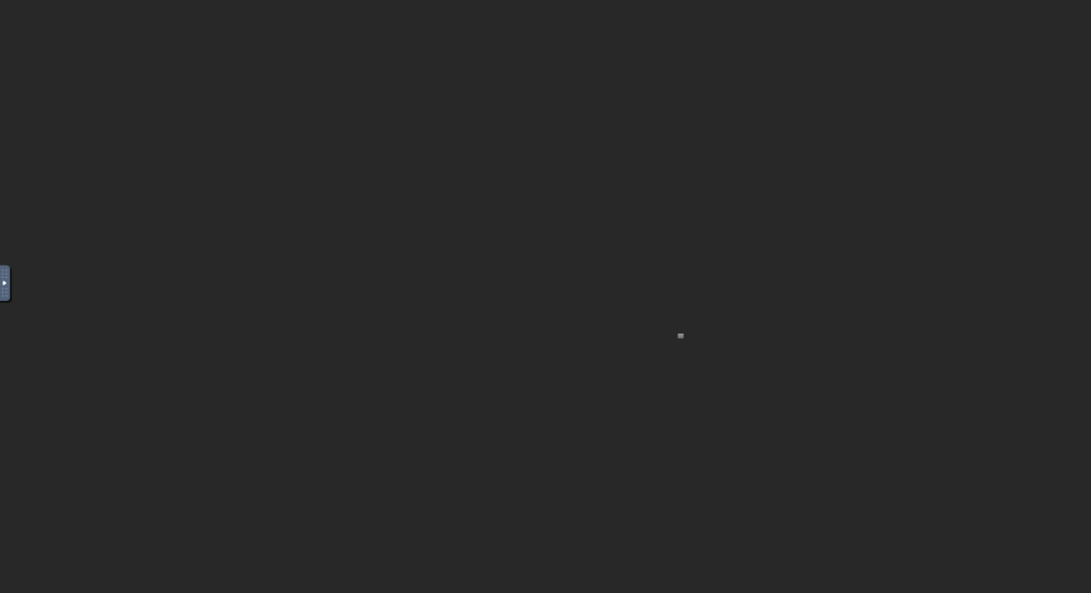

Hei ich777 thanks a lot for the docker images i have a question regarding de nvidia debian buster image.
Firstly i have a scuffed laptop setup, i can't disable my 950M in the bios, does the laptop monitor count as a monitor itself?
it looks like it does not find one
-------'DFP_NR' is empty please make sure that--------
---you've connected a monitor to the Graphics Card----
---otherwise the container will not properly start!---
---Trying to get Nvidia device address---
---Successfully got device ID: 01:00:0---
But it finds my card, nvidia-smi works in the container (if i start with 0-3 in the Xorg Display Output Port setting i don't get this error)
Then it doesn't find any outputs. I've seen your example log and mine is empty
Listing possible outputs and screen modes:
'Screen 0: minimum 8 x 8, current 640 x 480, maximum 16384 x 16384'
---Looks like your highest possible output on: '' is: ''---
---Setting resolution to: on output: ---
warning: output --mode not found; ignoring
Do you think i can make it work?
Edit in noVNC i get a little (10px x 10px) "Screen" i even got a alert sound once. on hover my cursor changes to the OS cursor.

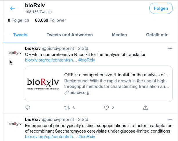

Hi, and thank you for your containers!
I've downloaded Firefox and it worked perfect out of the box.
But I tried to connect it to my binhex-qbittorrent-vpn container to put the browser behind VPN and couldn't get it to work. I've done some other containers this way so I thought it would work the same but no go.
Since sabNZBd uses port 8080 I changed it to :8082 for Firefox (changed container port, host port and web-ui to :8082). Added extra parameter --net.
Added port 8082 in binhex-qbittorrent-vpn
But it still show that it uses port 8080
And I can only access it through http://192.168.1.4:8080/vnc.html?autoconnect=true not 8082.
I can confirm that the browser uses the VPN, so it does work. But it clashes with sabNZBd that uses :8080. Why isn't it using port 8082?
Is there any other way of doing this? I'm quite a noob so I have probably c*cked this up somehow... 😅

7 hours ago, njdowdy said:
Thank you for your reply! While I was trying to obtain the information you requested, this functionality starting working! It now adjusts the resolution at least to 1600x900 and 1920x1080. So, that's great! I have no idea what changed...
What resolution gave you problems? The picture that you've posted looks like if you take a picture with something like 300x150 and resize it to 1000x500.
Do you use any stretch or scaling options within noVNC?
However, I am experiencing what I assume are compression artifacts. Is there anything I can do about this?
Are you stretching the image? I don't experience this in the DebianBuster Container only if you stretch or zoom the image drastically.
Here is a screenshot:
The ferdi resolution is set to 1920x1080 for these images. I did take a screenshot of only a small region of that, just to demonstrate the artifacts. That was blown up to a high resolution only to make the artifacts clearly visible. They are noticeable at the resolution of 1920x1080 in the browser window.
I don't think I'm stretching the image with novnc. Scaling mode: none. I have made no other adjustments elsewhere. Only setting the resolution in the template. Here are my novnc settings:
To me, your posted image actually has these noticeable artifacts at the posted resolution - specifically around darker text / outlines. The blue hashtag text actually seems fine to me. See below.
This graphic attempts to demonstrate how a range of quality/compression levels affects the display of text in the other docker I use that incorporates noVNC. All these images captured at the same resolution.
Here are a few other comparisons between Ferdi's Tweetdeck versus visiting tweetdeck.twitter.com directly. Both are same browser, same resolution. You can see the artifacts appear in Ferdi, but not in the native site.
Sorry to ask you to spend your time on such a minor issue. But it bothers me and I'm wondering if I can fix it and learn something in the process. As I said, I have experienced this with other noVNC dockers too, so it may be something applicable to other projects as well. Thanks!
Sadly enough I could nothing do to solve that issue since I noVNC introduced the sliders for the quality with version 1.2.0 and on Debian 1.2.0 isn't released yet...
You can only try to use a VNC Desktop Client and expose port 5900 from the container to whatever host port you want and then try to connect that way and see if it makes a difference.
EDIT: I personally use TightVNC Portable.
