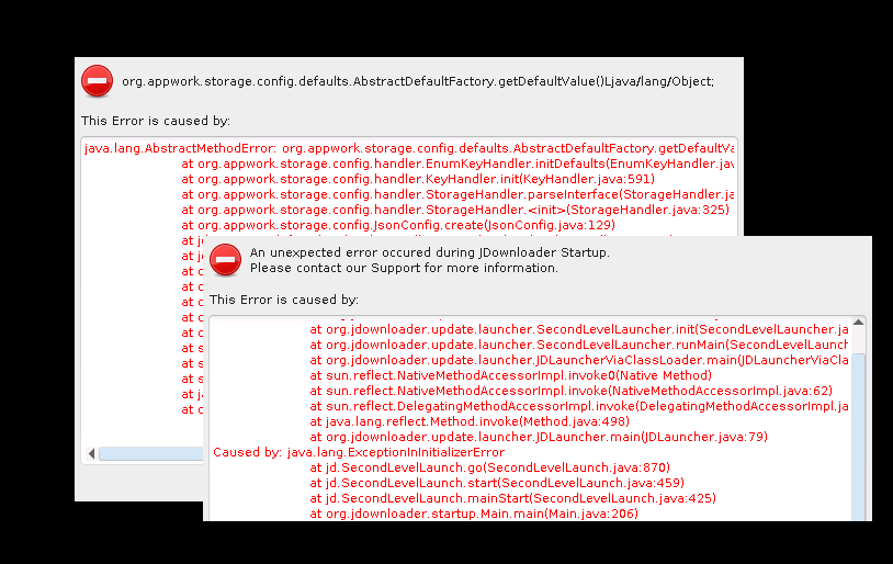

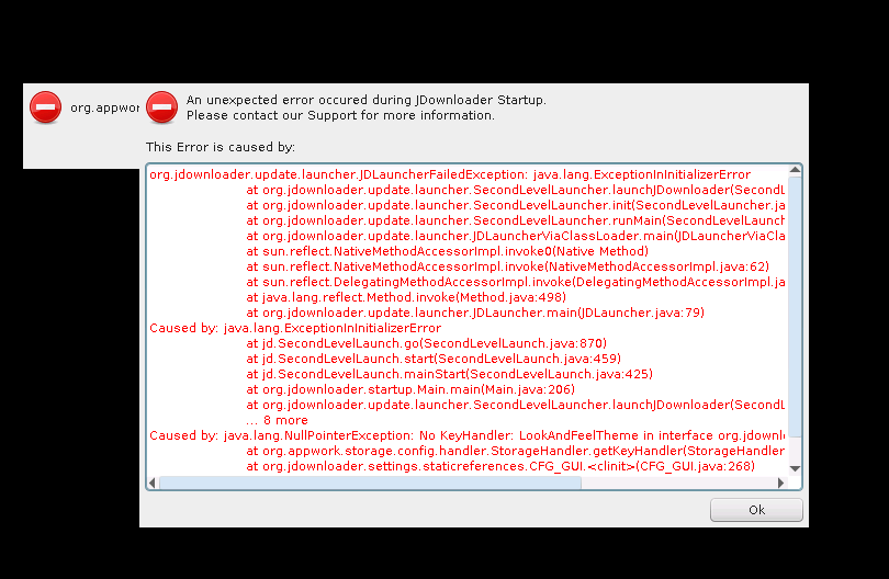

Jdownloader2 container is completely broken since last update, container just loop updates forever and won't start anymore.
Non of the message is copy-pastable.
Ideas to make it work again?
Edited by je82
Also updated mine now and it works just fine.
You can try to delete everything in the jdownloader folder in the appdata directory this will force a new download of java and also jDownloader itself (of course please stop the container before deleting everything from the jdownloader folder).
is there anyway to save the "log of files" ive already downloaded? If i delete everything i asume all my settings are gone and all my filehoster accounts ive added? I want to save those settings before deleting anything. Is it possible to just remove the corrupt update? Where is it stored? I looked inside the docker /jDownloader2/updates but there's nothing there.
I hope I got this right but it should be the 'cfg' directory that should store all your accounts and downloads.
thanks for the quick replies by the way! ok i am copying everything just in case. Hopefully i can just drop the CFG folder back in and start up and it should have my settings? Time will tell, the copy will take awhile the folder was very big with a lot of small files. Ill post back if it was a success or not
EDIT: Success, worked perfectly, shutdown jdownloader docker, delete everything except cfg folder, boot it back up, and everything is back to normal, cheers ich777 for the amazingly fast support
