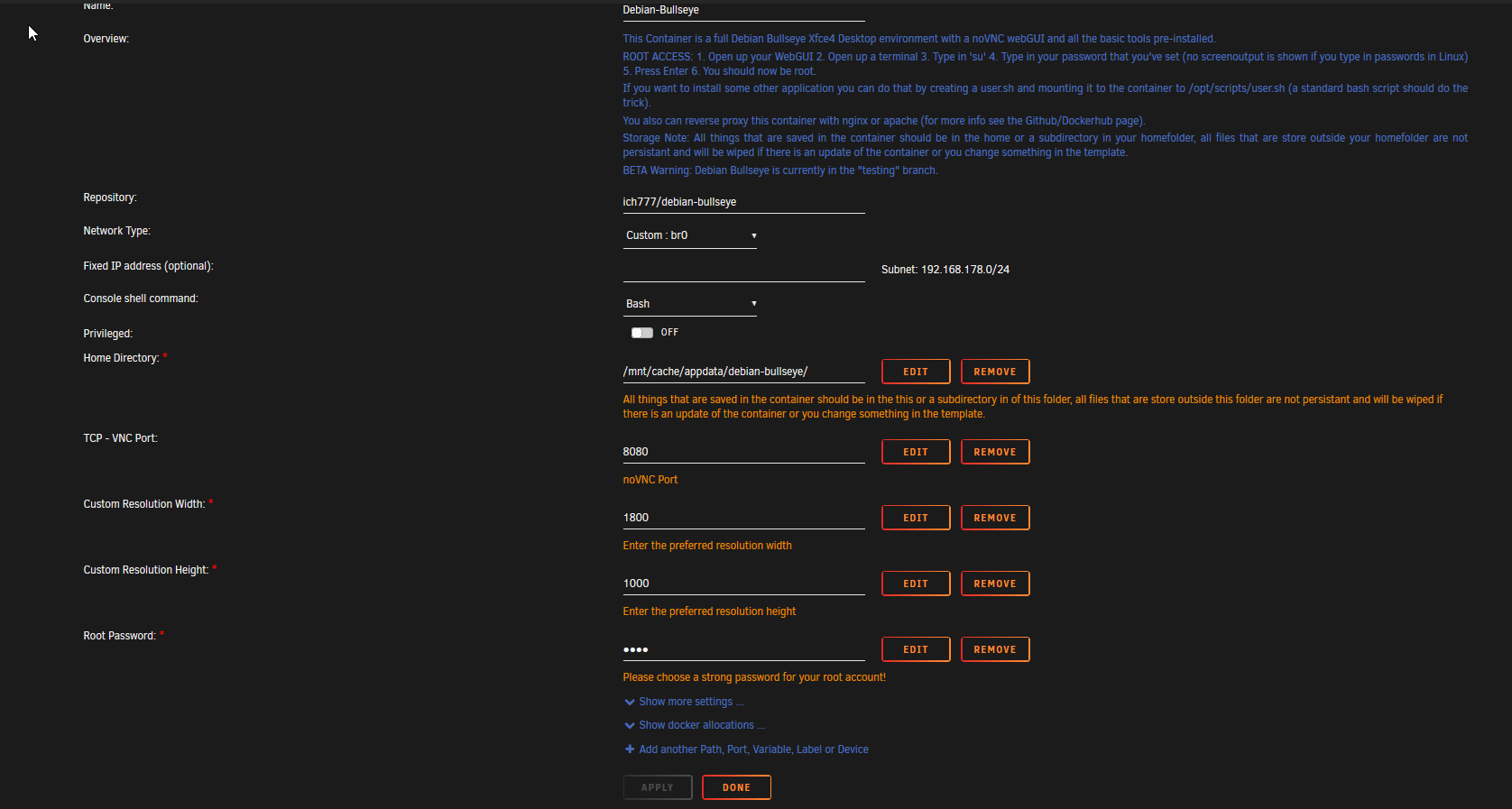

Hi i cant connect to the debian-bullseye webinterface, has anyone an idea?debianBullseye.thumb.png.696b5a8ba82fce679c674a01345c6a86.png

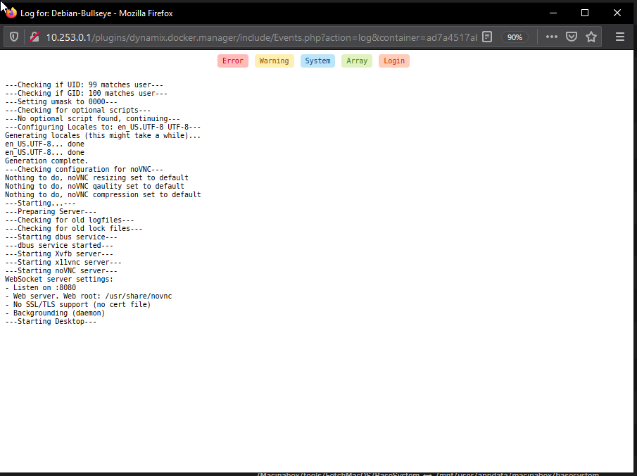

3 minutes ago, ich777 said:
Can you send me the log?
What is the exact error?
The only error i get is no connection to the web-interface, the console itselfe works fine

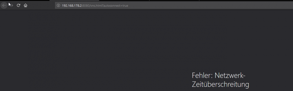

Seems like something is wrong with the IP.
Have you set a Custom IP?
In your timeout screenshot it seems that noVNC wants to connect to: 192.168.178.2 but in your log screenshot the IP seems to be: 10.253.0.1
Please go into your template and set the right IP at 'Fixed IP address'.
The container is definitely working because I use it right now and the log also seems fine.
EDIT: And also select the appropriate interface in the template.
I have set a custom ip. I connect via wireguard, so this is the 10.253.0.3 address in the server log. If i have set the fixed ip-address i got the same issue and iu get also the same issue if i try to connect fron the exact same network.
1 minute ago, Hyperion said:
exact same network.
Can you try to enter: YOURLOCALIP:8080 if there shows up a site?
The site that should show up is:
If not then there is some other kind of network error.
