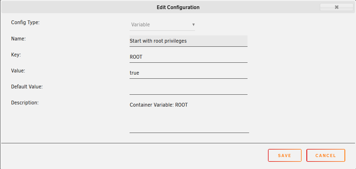

Can you also try to type in 'su $USER' from the luckyBackup console and then try the same command again if it fails?
rsync: [receiver] failed to set times on "/mnt/disks/External_USB/Public/.alarm.xlsx.HqszfT": Operation not permitted (1)
after exiting back to root, it works.  you should also know that because the date/time can not be set it forces a recopy of the files until the date/time is set.
Thank you for testing!

Can you try to update the container and then create a variable like this and the container or better speaking lucky backup should start as root:
It worked!  Thank you!

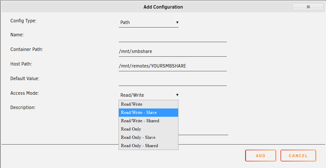

Does it look like this (you have to mount it as R/W - Slave):
Can you say where did you enter to get into that panel? The url or where to go and what to press? I don't recognize that panel from the screenshot, sorry I'm a noob...
EDIT I just realized that's in the docker add path thing

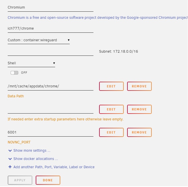

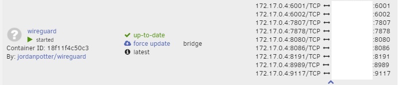

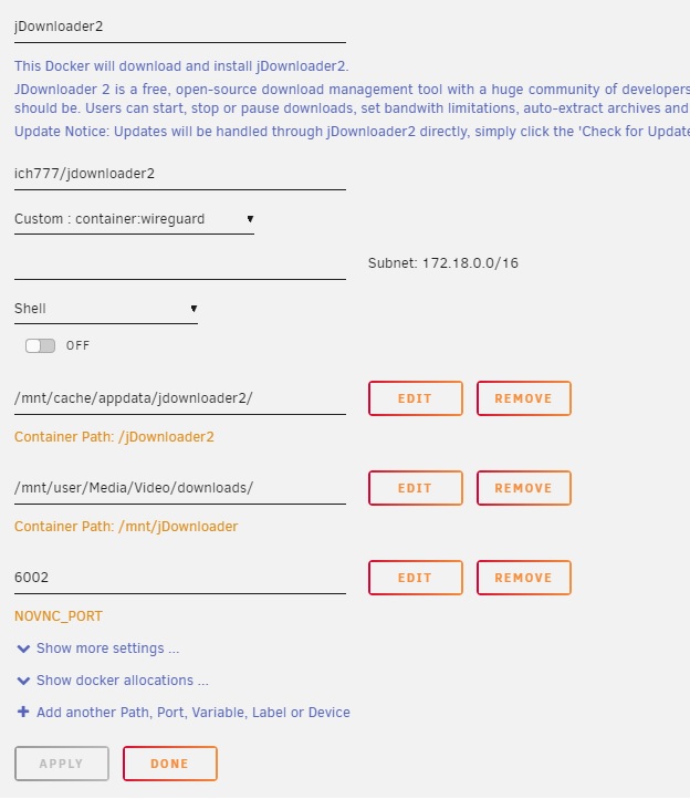

Try a different port Container port 5900 and Host port something completely different for example 5950 or something like that.
In my case I got many containers running with this setting to connect with a VNC Viewer to it from my local network for example Thunderbird.
I'm try to use 2 containers from you at the same time but I can't get them to work.
I'm connecting though a VPN docker and added 2 NOVNC_PORT to 6001 and 6002.
When I'm launching both container (chromium and Jdownloader) I can't get them to work.
The port is not changed, thus when I go to my IP:6001 or IP:6002 its opening the same VNC (the first docker I launched)

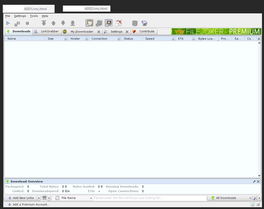

Can you send screenshots from the two templates?
Do you want to connect through noVNC (web) or through a VNC vlient?
You don't have to add a port if you want to connect through noVNC you have to change the default web port from 8080 to 6001 for the first container and 6002 for the second.
If you want to connect through a VNC client then you have to also change to ports to two different ports for the containers (eg 8080 and 8081) and then add the VNC_PORT variable and also a new port entry to the containers for the VNC_PORT's.
Here you are :
When I'm connecting to VNC within my browser (whether chrome or Jdownloader), I only get Jdownloader webui. (or the 1st container i Launched)
