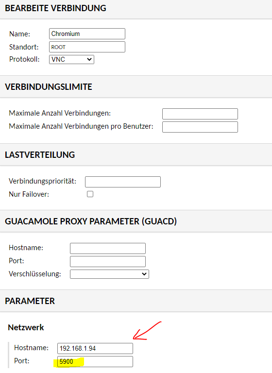

here how it looks like, as you see chrome in guacamole

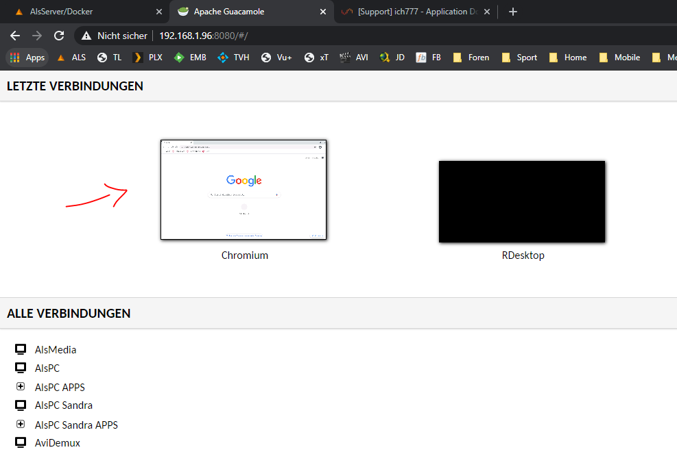

great stuff. got it working thanks for your help

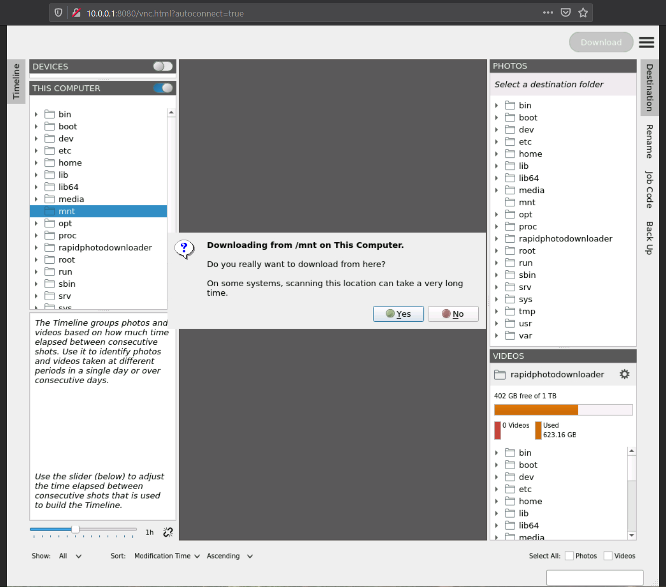

Hello @ich777
Thank you for your great work for unraid.

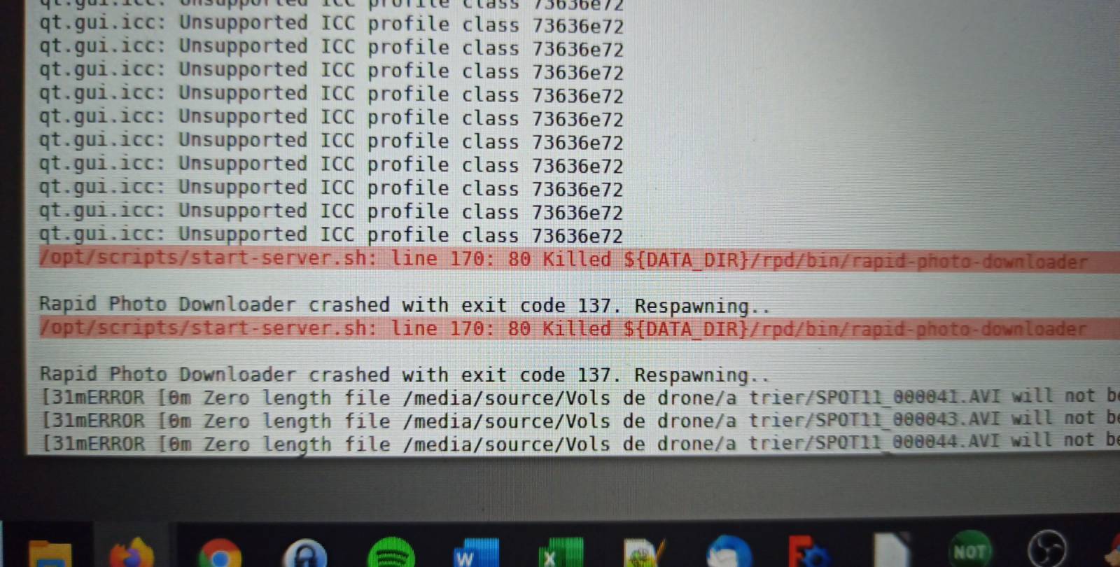

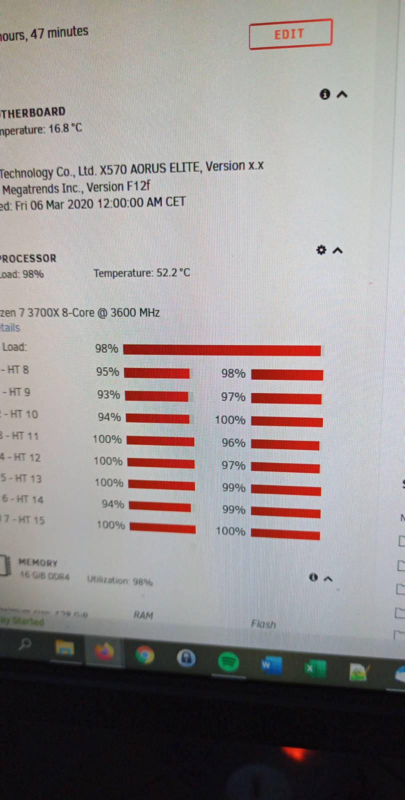

My friend download the rapidphotodownloader but when he start it the docker eat all the ressource of the host
all the core are at 100% and the ram is full.
I tried to limit the ram to 4g but the docker crash
The host have a ryzen 3700x and 16go of ddr4.
Do you have a tips? thanks
Can you try to delete the container including the directory that is created in the appdata directory and pull a fresh copy from the CA APP.
What I can think about is that some kind of picture/video that he want's to import is not compatible with RapidPhotoDownloader.
Eventually it has something to do with this issue: Click
(are there black and white png's in the folder he want's to import?)
I tried it now on my own and can't reproduce the issue:
Thank you very much, i will send him this response. Have a good day

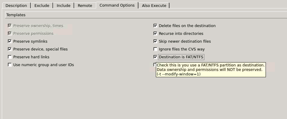

Hi,  I am running luckybackup to backup files to an external USB drive.  everything works but I keep getting errors that it cannot set the time on the files.  I am using NTFS and I have tried exfat.  I have used the rsync command created by luckybackup directly on the host and it works.  any ideas on the time setting problem?
Have you also set this option:
Yes, I have done this.  I should also mention the the USB drive is through unassigned devices.  currently mounted to docker as RW slave(I have tried the others RW, RW Shared).
