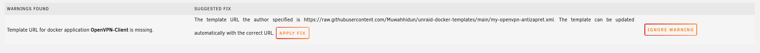

Are you perhaps running the Fix Common Problems plugin? Today I received the following warning from the plugin:
For some reason Fix Common Problems thinks that the template URL is missing and is proposing the template of "Muwahhidun". I have no idea why it is doing this. It might be malicious, but I don't know enough about Unraid templates (yet) to give my opinion on this.
Ignore it.  That's a by-product of the fact that two templates exist which pull from the exact same dockerHub repository.  While I usually don't allow that, in this particular case I did allow it for various reasons.

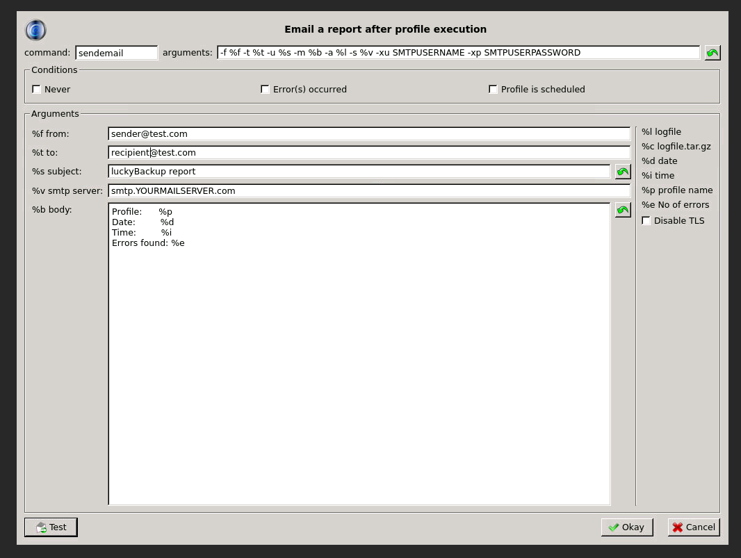

I have now integrated 'sendemail' to the container and updated it in a few other different ways (Please be sure to grafik.png.f08fe37a506fc1b8e25edc21e9a26386.png the Container on the Docker page before trying this).
To send a mail configure luckyBackup like this:
Please notice that I have appended '-xu' (SMTP username) and '-xp' (SMTP user password) to the arguments to actually being able to send an email because my mail server, as I think most mailservers nowerdays, need a authentication and it works without a problem (if you entered 'sendemail' at command click on the green arrow on the right side and it will fill in all the necessary arguments in the arguments line without the two arguments mentioned above).
Please report back if this is also OK for you because I don't have a easy way of send a Mail through a Docker container from Unraid.

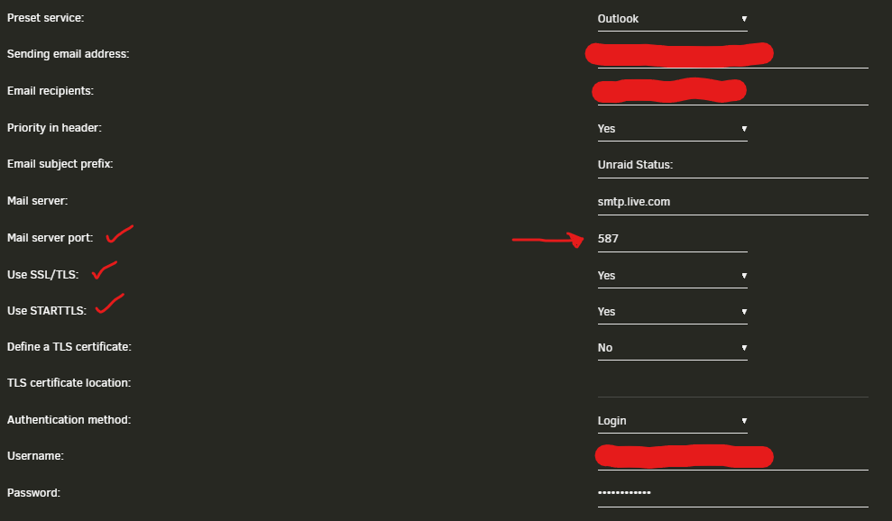

Thank you for the quick work!  Unfortunately, it didn't work and I think it's because it uses the default port 25.  is there a VAR for port selection?  smtp.live.com uses a different port (587) and it'd be more configurable for other servers or relays using a VAR for the port.  TLS was used during the attempt and this is definitely further than initially tested.  Thank you so much for this effort!
You can also specify a port like this:
Same error.  After a little more investigation, now that I have confirmation that adding the port to the servername is functional, it might be a TCPIPv6 binding issue.  IF INET6 is indicating the correct error, that is.  Apparently, it's a common enough issue with docker where it will bind to v6 and if you're running v4 it will fail.  From what I've gone through so far (about 20 postings), there's no "easy" way to fix it and sometimes it's confined to an OS and docker combo (although this is muddled too because some say it works correctly on their same OS).  I'm not certain specifically, and will continue to scour.  My google-fu is still running validation but I thought I'd respond with the preliminary findings.
Thanks again!!!
