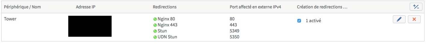

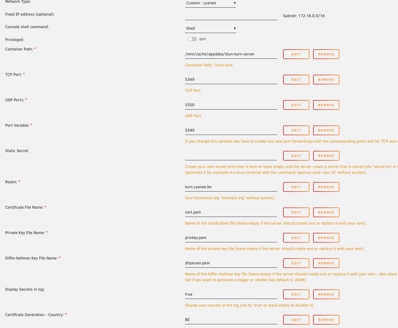

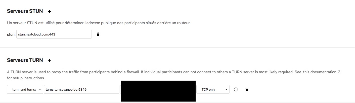

Hello,
I'm trying to run Stun-Turn-Server without success on nextcloud.
I have opened my ports on the box, I have a working certificate on Nginx and when I click on "test the server" I get the following error message "Error: No working ICE candidates returned for tcp by the TURN server"
What can I do to fix the problem?
Thanks in advance
1 hour ago, boomscud said:
Hello,
Thanks in advance
You actually can test your server first here:
https://webrtc.github.io/samples/src/content/peerconnection/trickle-ice/
Can you reach it from there?
What ports have you forwarded? Have you changed anything in the template?

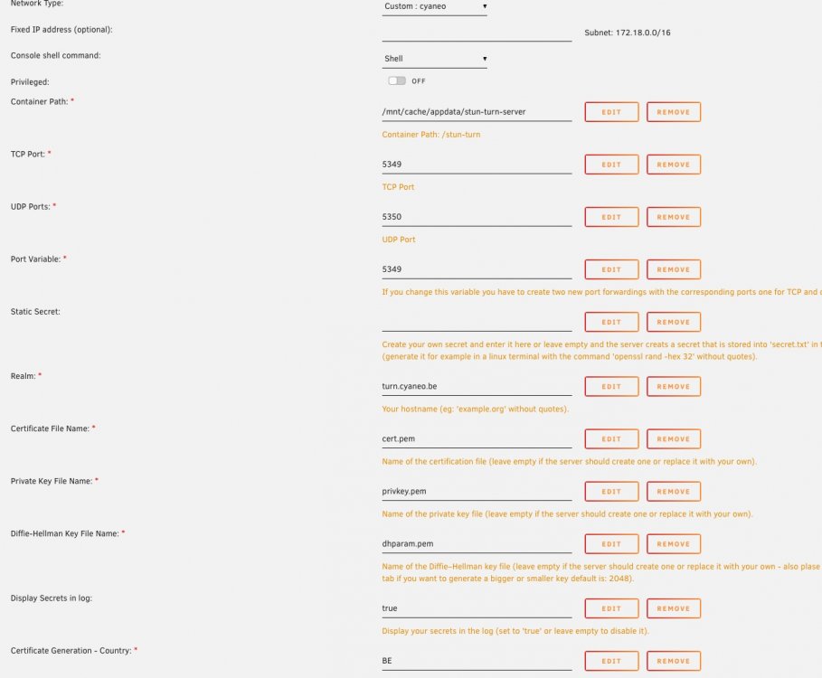

3 minutes ago, boomscud said:
I can't
Can you please put the STUN-TURN server in bridge mode and test it with default settings?
I see you have it on a custom network what actually can cause problems.
it's ok but it work only in UDP
