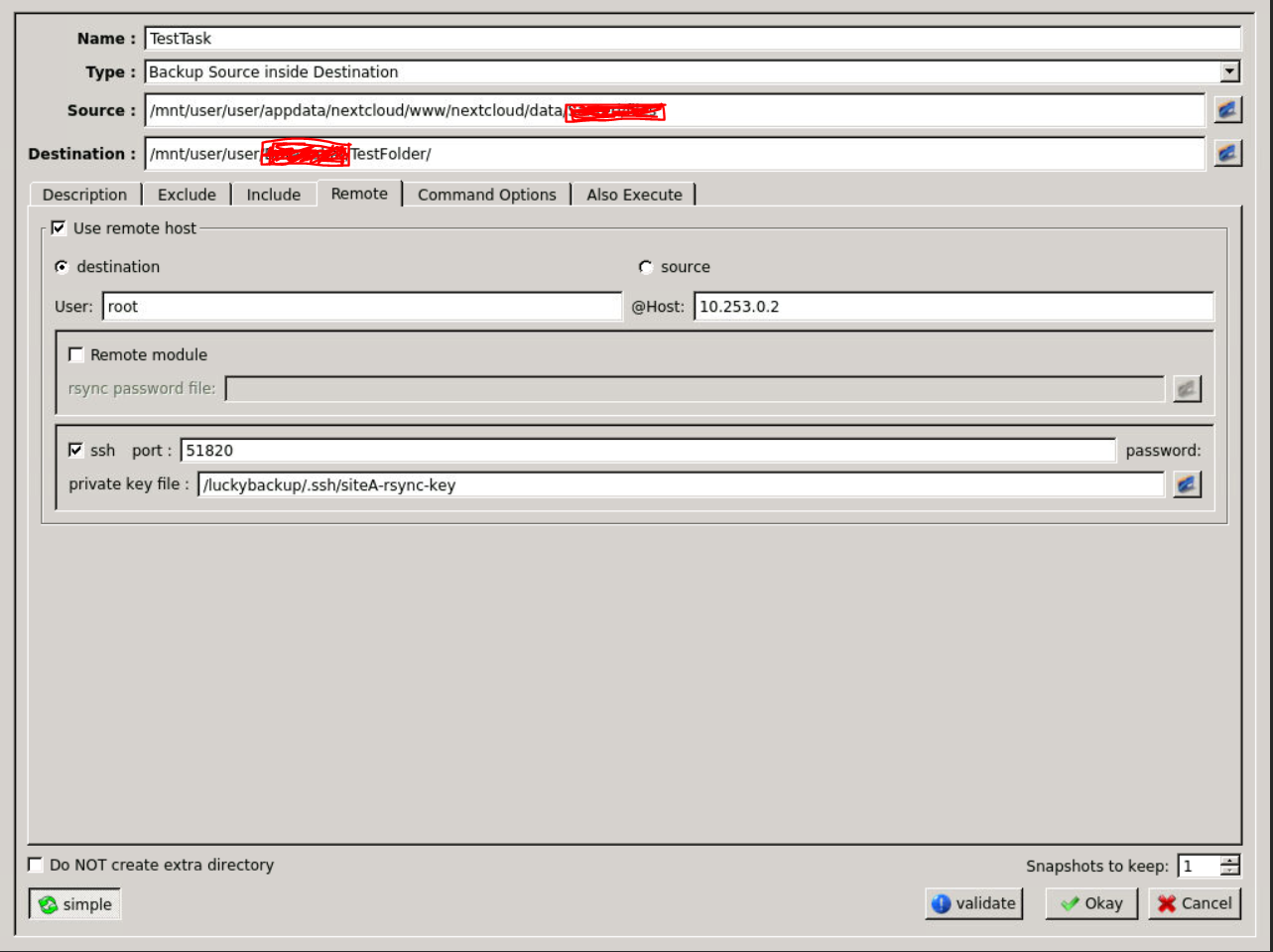

And this is currently how I've set-up LuckyBackup:
I'm sure I'm doing something silly here, and I'm just not seeing it.
With this kind of setup, the message I'm getting  into the log, is as follows:
Thank you for the help so far, really appreciate it! :)
EDIT: Trying to SSH to the remote server does require a password from me. So I suppose that might be an issue here..?
Edited by REllU
Yes, there is something wrong with the setup of the ssh keys... :)
Can you give me a little more details where luckyBackup runs? Does it run on the side where you want to backup the files to or do you run luckyBackup on the machine where the files that you want to backup?
But I think the remote is the destination in your case?
Please keep in mind your Site A is luckyBackup (don't take the keys from the Host - you have to take the keys that are luckyBackup generated) and you have to give Site B the public key from Site A and within luckyBackup you have to choose your private certificate file.
Server #1 is the Site A, and that's the one within the office. LuckyBackup is installed on this one. (Source)
Server #2 is the "dummy" server, that basically "just" has UnRaid on it, and that's about it. (Destination)
Do I actually need to install LuckyBackup on both machines to get this to work? 🤔
EDIT: I tried to do a quick test with just rsync through the terminal, and that seemed to work beautifully!
I'm thinking I might go with user-scripts and just create a few scripts for backing up everything.. But if I go that route, I need to figure out how to add excluded files/folders into those, as I don't want to backup _everything_
Edited by REllU
No, why should you, luckyBackup is only a frontend for rsync.
Which files and from where have you put on which machines and in which folder?
I think you don't put the right files in the right place, that's the only error. ;)
That's because you are doing it from the terminal and you haven't read my message above at least not fully... :D
You have to put the ssh files that luckyBackup created on the other machine and you don't need all the files that you created with this tutorial, luckyBackup creates the files for location A on it's own. ;)
