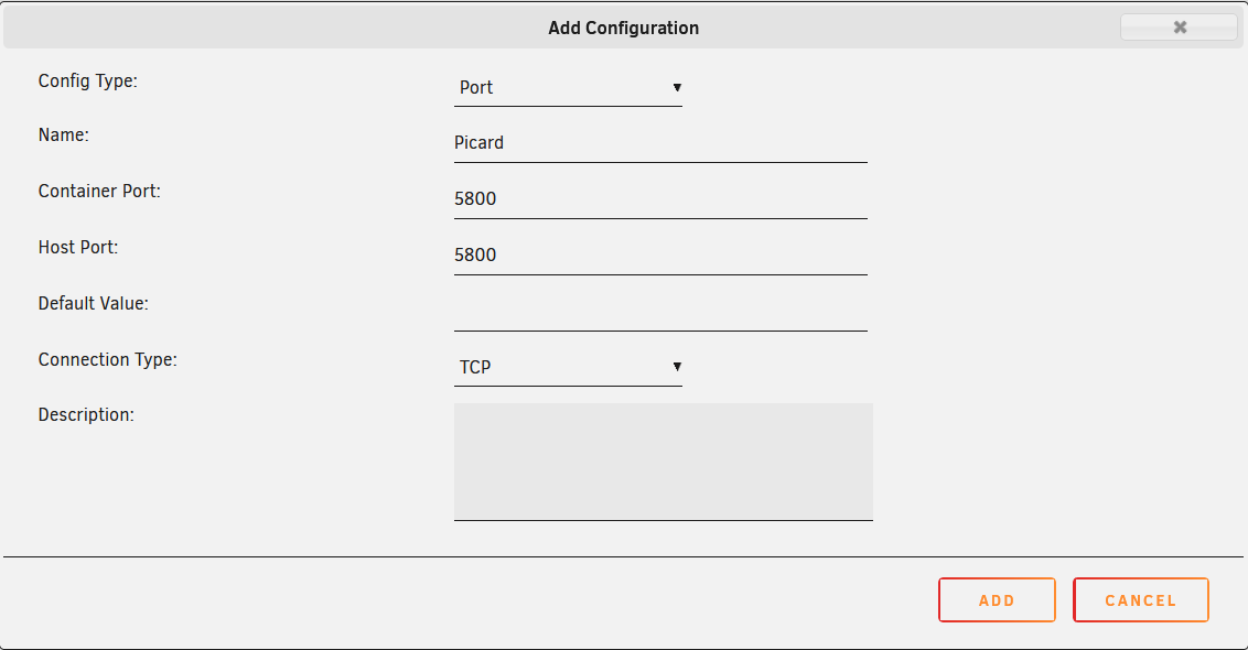

Hi @ich777 I can't get OpenVPN-Client to work with other containers. I does connect to the VPN provider properly, the tunnel works. Also it uses the VPN provider DNS. I did set the following variables:
DNS=true
FIREWALL=true
ROUTE=192.168.0.0/16
ROUTE6= (empty)
VPNPORT=5800
Then I took the Musicbrainz Picard container, changed Network to None and added "--net=container:OpenVPN-Client" to Extra Parameters. The VNC UI of this container is on port 5800.
If I open the console of the Picard container I cnnot do much troubleshooting as it does not have ping and curl. The routing table is empy. Resolv conf points to my local network's DNS server (it shouldn't?).
Needless to say, port 5800 is not answering.
BTW the explanation in the template say one should "add the port" of the connected containers, but it does not say how to do that. I looked at the container's github project and I guessed it would be the VPNPORT(_x) variables, but I am not sure.
What am I missing in my config? How do I make it work?
Can you try to add the DNS manually for example from Google manually, you do this by adding: '--dns=8.8.8.8' to the Extra Parameters in the OpenVPN containter, just for troubleshooting reasons.
Do the following in the OpenVPN container:
(since you are using the container network from the OpenVPN container in your Picard container you have to add the port to the OpenVPN container since all the port mappings in the Picard container are not working anymore because well you use the OpenVPN containers network and have to forward the ports there)
Thank you so much, sounds logically if you know the reason.

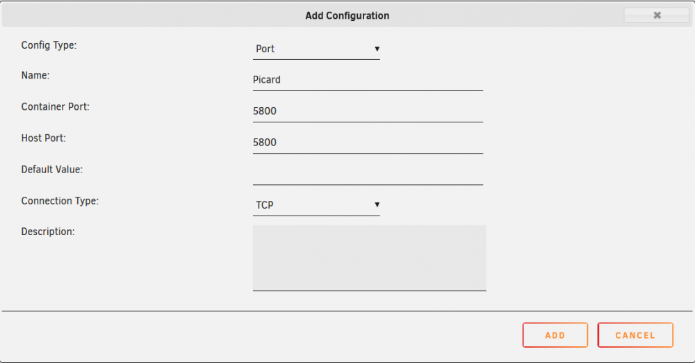

I have another question and 2 remarks:
Question: if a connected container e.g. Picard has a container port number 5800 and an associated host port number 1234, how would I implement this with then OpenVPN-Client container? Would I also put in container port number 5800 and host port number 1234? (You may want to document this in the template)
Remark 1: DNS started to work when I added the port. Magically the /etc/resolv.conf in the Picard container now has the VPN Provider's DNS server IP.
Remark 2: The ROUTE variable does not seem to be necessary to be able to reach the ports of the connected containers, if we put those ports into the OpenVPN-Client container.
Exactly. ;)

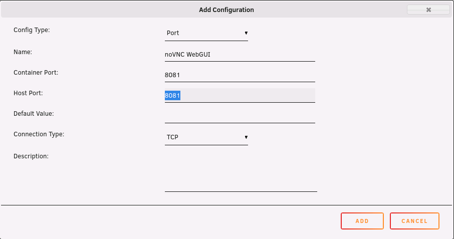

There seems to be a challenge with containers connected to OpenVPN-Client if they use the same port numbers within the container.
Lets assume container A uses container port 8080 and host port 8080
and container B uses container port 8080 and host port 8081
How can we tell OpenVPN-Client that 8080 is mapped to 8080 for container A and 8081 is mapped to 8080 for container B. I guess thats no possible and one would need to change the port number in the installation of the container image?
Any better ideas to solve this?
That's not possible.
What containers are you having issues with?

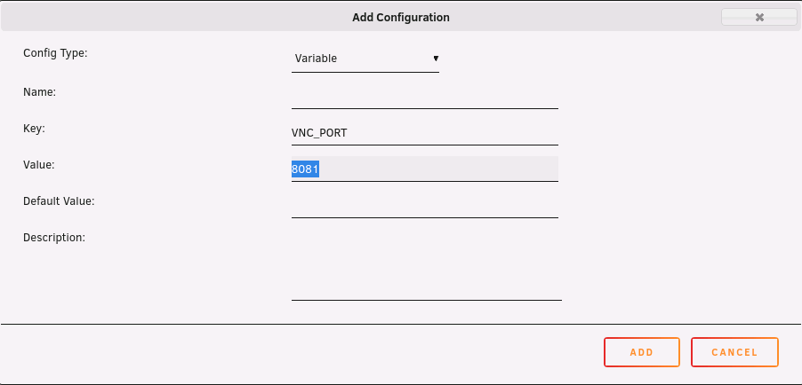

If it's a container made by me you can always create the Variable 'VNC_PORT' and change it so something like for example 8081 then the port in the container is actually 8081 and not 8080 anymore (I also recommend to create the Variable 'RFB_PORT' and change it to something like 5901 - default is 5900 - so that there are no collisions between the containers).
Keep in mind that if you create this variables you actually have to change the WebGUI port to the container port 8081 and your preferred host port.
some linuxserver.io containers have 8080 as container port. no problem with that in a general setup, but with the OpenVPN-Client setup you get a collision and there are no VARIABLES to change the port, so you need to delve into the config files.
Mine also have by default these ports but I've actually built that in way before I made a template for OpenVPN-Client because you never know when a user has a special use case where they need to change the port numbers internally. :)
Yes exactly, if there are no variables you have to change the port in the configs to actually change the ports inside the container, that's also the case for some containers that I've made: Most of my game server containers, SABNzbd, NZBHydra2,...
There is simply no way around that because this is a completely special use case and you also wouldn't be able if you run all applications not in Docker containers and instead on a Dedicated machine, there you also have to change the ports physically in the config files.
Hope that makes sense.

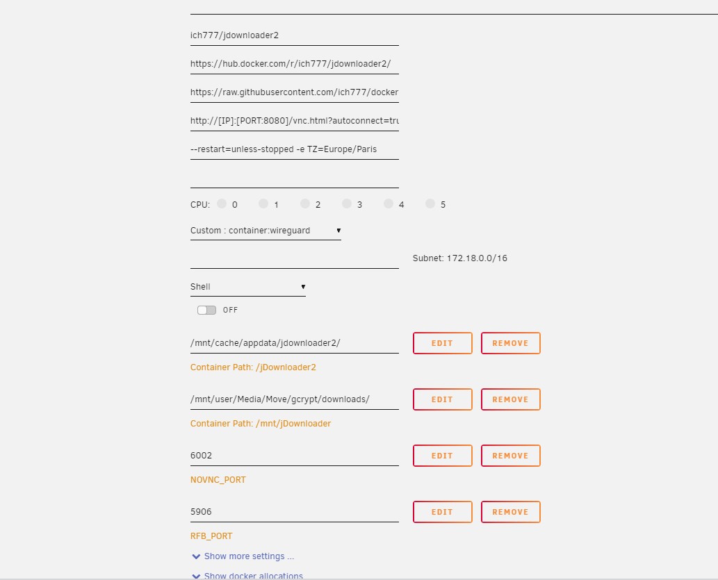

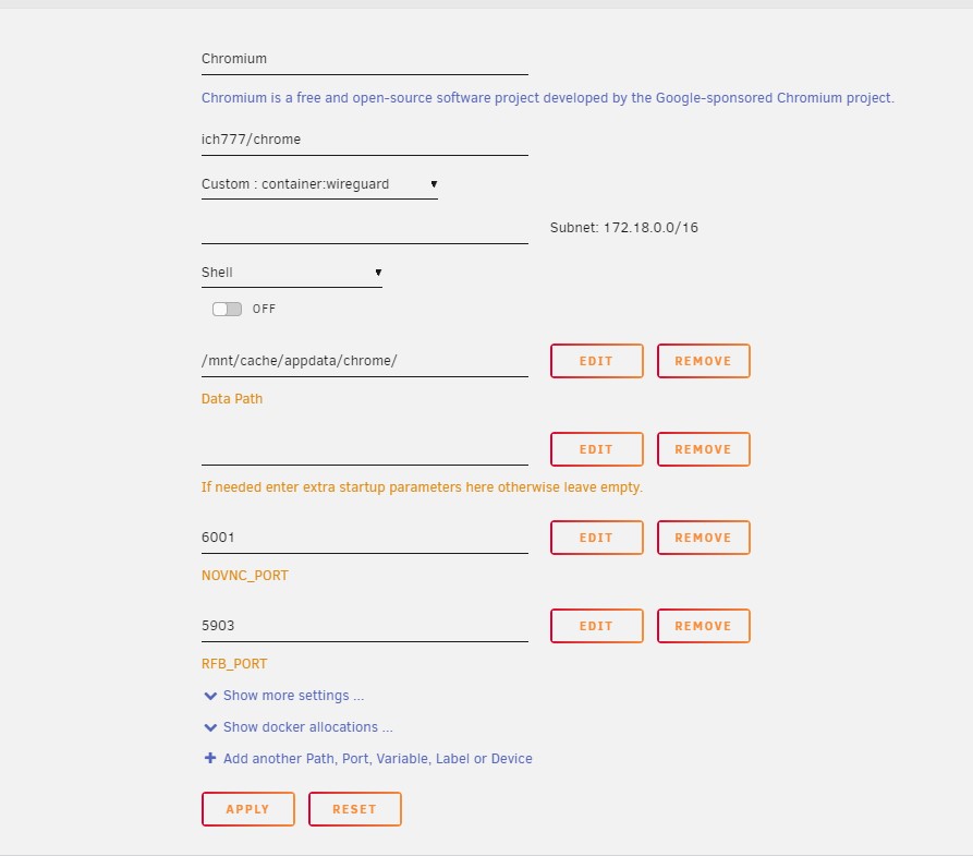

I've been using 2 of your container within docker on a wireguard network container.
Since the chrome update, only one container can access to internet.
I'm using :
NOVNC_PORT (different) on both container (redirect also on my wireguard container).
RFB_PORT (different) on both container
Here is throwing error (loop) :
12/05/2021 08:15:47 Using security configuration file /etc/turbovncserver-security.conf
12/05/2021 08:15:47 Enabled security type 'none'
_XSERVTransmkdir: Owner of /tmp/.X11-unix should be set to root
12/05/2021 08:15:47 Desktop name 'TurboVNC: b05b8e5d5d3a:99 (chrome)' (b05b8e5d5d3a:99)
12/05/2021 08:15:47 Protocol versions supported: 3.3, 3.7, 3.8, 3.7t, 3.8t
12/05/2021 08:15:47 Listening for VNC connections on TCP port 5903
12/05/2021 08:15:47 Interface 0.0.0.0
12/05/2021 08:15:47 Listening for HTTP connections on TCP port 5899
12/05/2021 08:15:47 URL http://b05b8e5d5d3a:5899
12/05/2021 08:15:47 ListenOnTCPPort: Address already in use
---Starting Fluxbox---
---Starting noVNC server---
WebSocket server settings:
- Listen on :6001
- Flash security policy server
- Web server. Web root: /usr/share/novnc
- No SSL/TLS support (no cert file)
- Backgrounding (daemon)
- Listen on :6001
---Starting Chrome---
Looks like both container are using 5899 port for http.
Can you please give me a little more context what you've changed exactly in both containers, screenshots would be super nice. :)
My containers doesn't listen on port 5899 for http connections, they listen on port 8080 by default, that's why I created the variables so that users that want to run multiple containers through one Docker network have no issues. :)
You actually change the http port with the variable 'VNC_PORT'.
12/05/2021 08:15:47 Using security configuration file /etc/turbovncserver-security.conf 12/05/2021 08:15:47 Enabled security type 'none' _XSERVTransmkdir: Owner of /tmp/.X11-unix should be set to root 12/05/2021 08:15:47 Desktop name 'TurboVNC: b05b8e5d5d3a:99 (chrome)' (b05b8e5d5d3a:99) 12/05/2021 08:15:47 Protocol versions supported: 3.3, 3.7, 3.8, 3.7t, 3.8t 12/05/2021 08:15:47 Listening for VNC connections on TCP port 5903 12/05/2021 08:15:47 Interface 0.0.0.0 12/05/2021 08:15:47 Listening for HTTP connections on TCP port 5899 12/05/2021 08:15:47 URL http://b05b8e5d5d3a:5899 12/05/2021 08:15:47 ListenOnTCPPort: Address already in use
Do you also want to set a password in the Container for the VNC Connection? Have you also created a variable 'TURBOVNC_PARAMS' and left it empty? Otherwise the password won't work.
Here you are :
You already solved my case with NOVNC_PORT at the beginning of april. (
I've tried VNC_PORT and NOVNC_PORT Variable.
